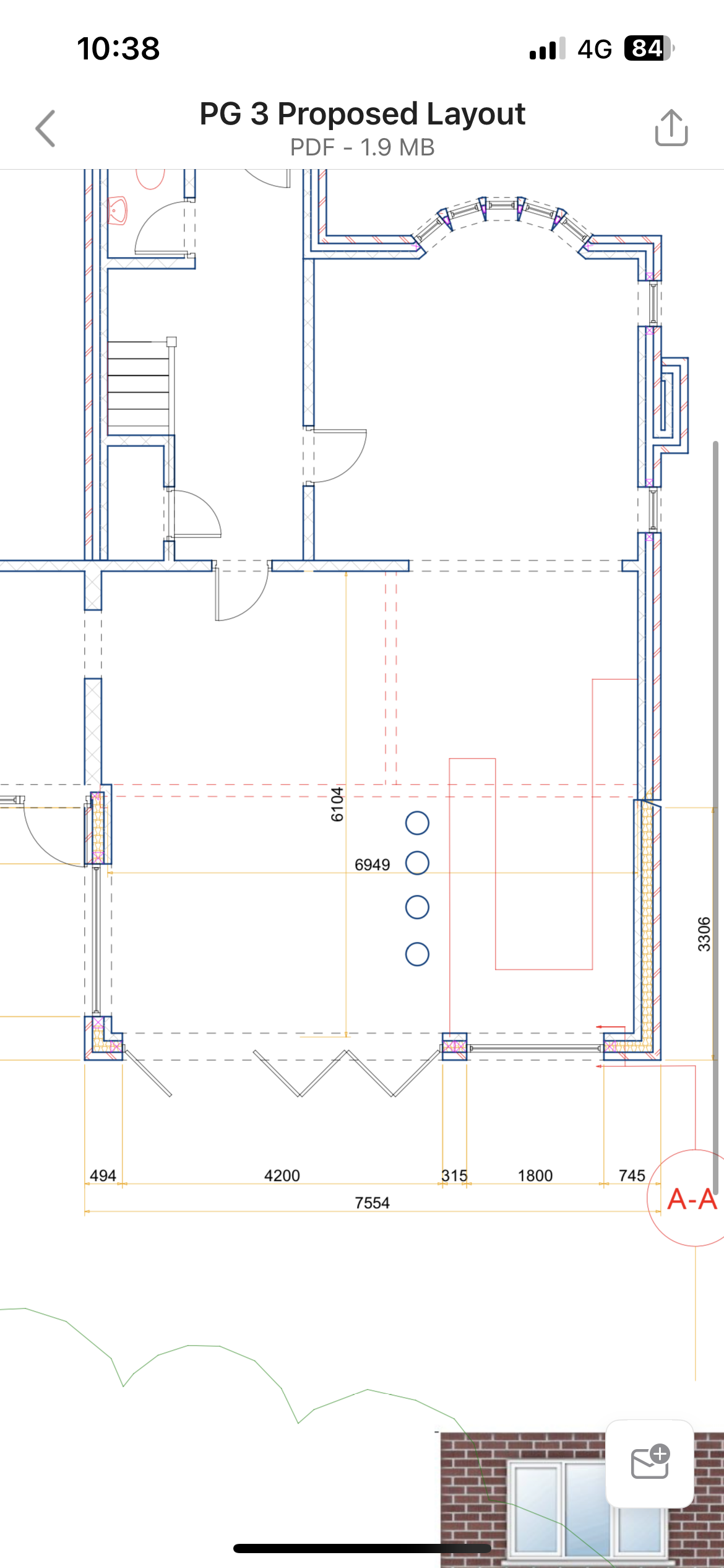

Help me design my Kitchen/Dining/Living space!
Mattg4321 replied to Mattg4321's topic in Kitchen Units & Worktops
Thanks for your input. I'm almost certain we will close off the opening between the lounge and extension/kitchen. We just have to figure out how to lay out the extension! Some good ideas so far here. -
That’s not a bad idea, thanks for your input. No obvious place for the tv and kitchen in the darkest corner being the only downsides I can see. It’s a good size space, but awkward to get right I think. -
Really struggling to make up our minds as to how to lay this area out. We’d ideally like to incorporate a good sized table and a snug area, possibly with a TV. We think the bi folds will be slightly smaller than shown - to allow for a 900 breakfast bar and a 1200 gap between units. We’re open to closing off the opening between lounge and kitchen at the top right in the room as you look at the picture. Wife says we could have the kitchen in that corner. I’m not keen, seems like it would be darker there and I like to look out the window as I’m washing up/ cooking. It may help generate more space (in both rooms) though as we have a lot of openings in the room. Struggling with placement of table/sofa/ possible tv and if we’ll have enough room so it doesn’t feel cramped. Open to, and grateful for suggestions!

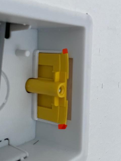

Skim too thick for plasterboard back boxes
Mattg4321 replied to Thorfun's topic in Electrics - Other
Snip the little tabs off that I’ve marked red and problem solved. They just stop the wings/lugs pushing back like some of the cheaper dry liners do. Usually ok without though. Next time fit them before skim coat or do it properly with nogs and metals boxes!! That way you don’t get the lip of the box showing either -
