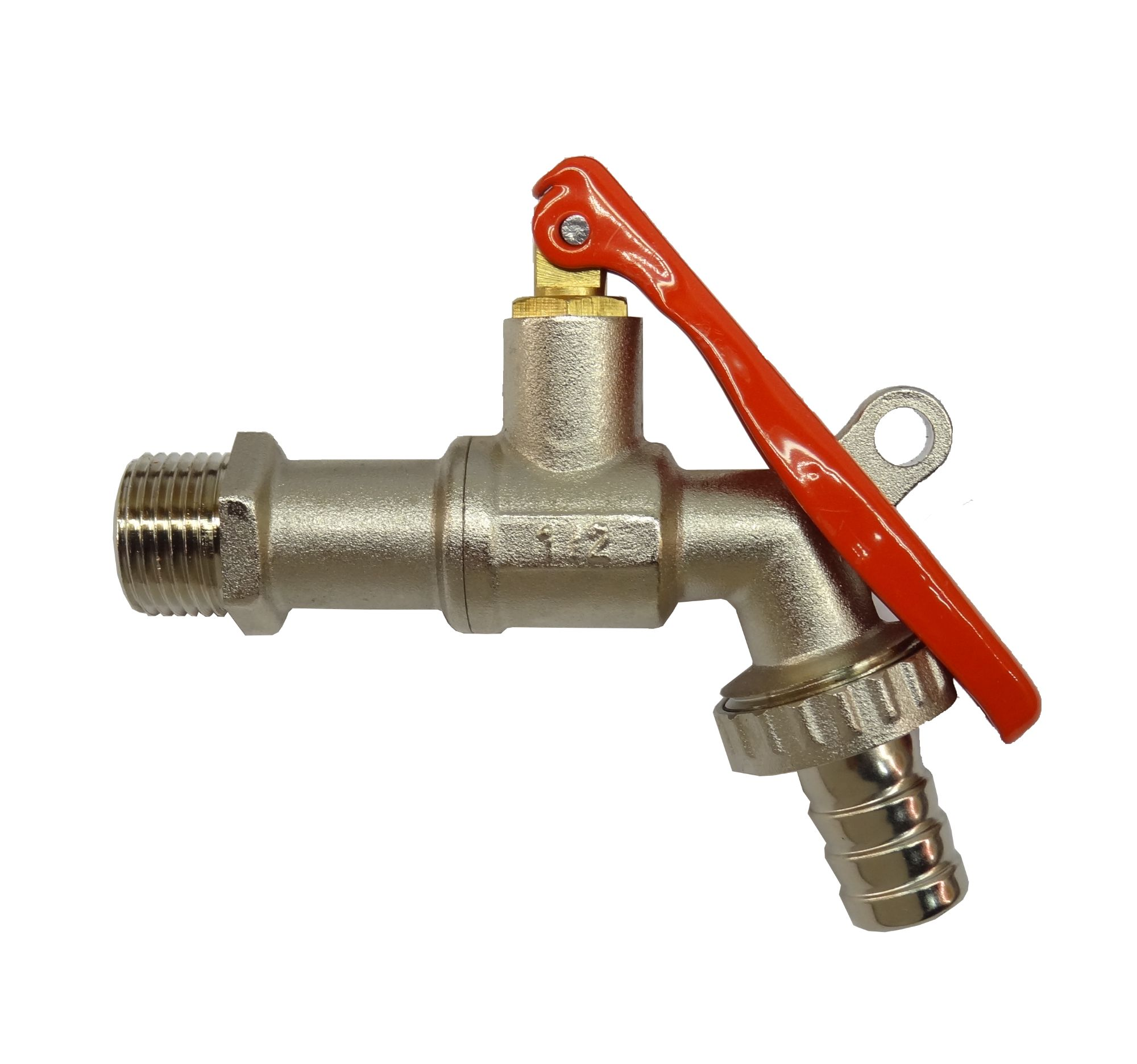

"Lockable lever taps" (search term) outdoors and a noddy combination code lock? I have these on the cold water outside taps because once upon a time nuisance kids and water meter.

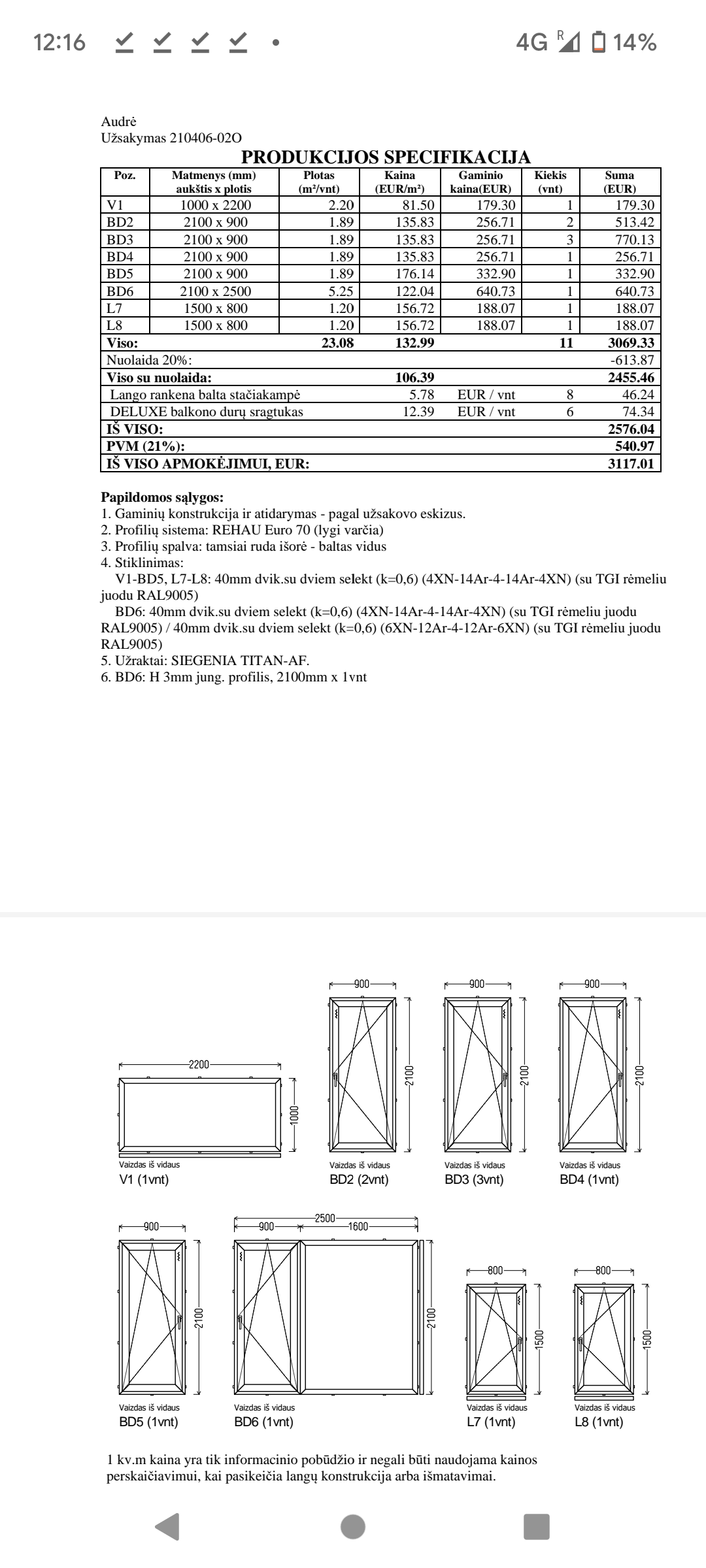

(UK) I'm after a door / french door (occasional use door) for a narrow opening. (cutting bricks out under an existing window) 1480 wide. ~2100 high. Probably one fixed pane, one opening pane. Side hinge only and outward opening. Perhaps some huffing great single that has a frame not made of wet spaghetti. Keen to avoid the opening being entirely made of frame. White uPVC for self install. House is not a looker or a long term keeper. This would open up some space for access though. Previously I bought some windows from https://www.modernupvcwindows.co.uk but was distinctly unimpressed - the frames have all the structural integrity of wet spaghetti and are as airtight as lace underwear. What profiles/suppliers would you consider?
Even if security is meh I wouldn't do it. I think you'll also wear them out as doors if used too often. Fine for a balcony door that stays shut in winter, then gets tilted during shoulder seasons, then gets left open for most of the summer. You'll wear them out / the frames will turn parallelogram on you if used regularly. People also get confused as to how "to open the door" what with it looking like a pull down to open multipoint locking door but operating as a "lift handle to horizontal then open" window. We used rehau euro 70 in 2100*900 everywhere because cheap (€250 in triple glazed tilt/turn flavour) vs a real door. Was a mitake in hindsight. Too much of a cheapskate to change it now though so will just stock up on hinges...
