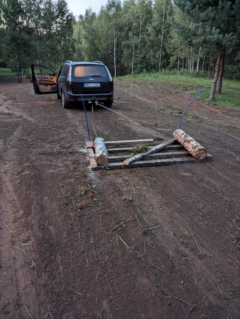

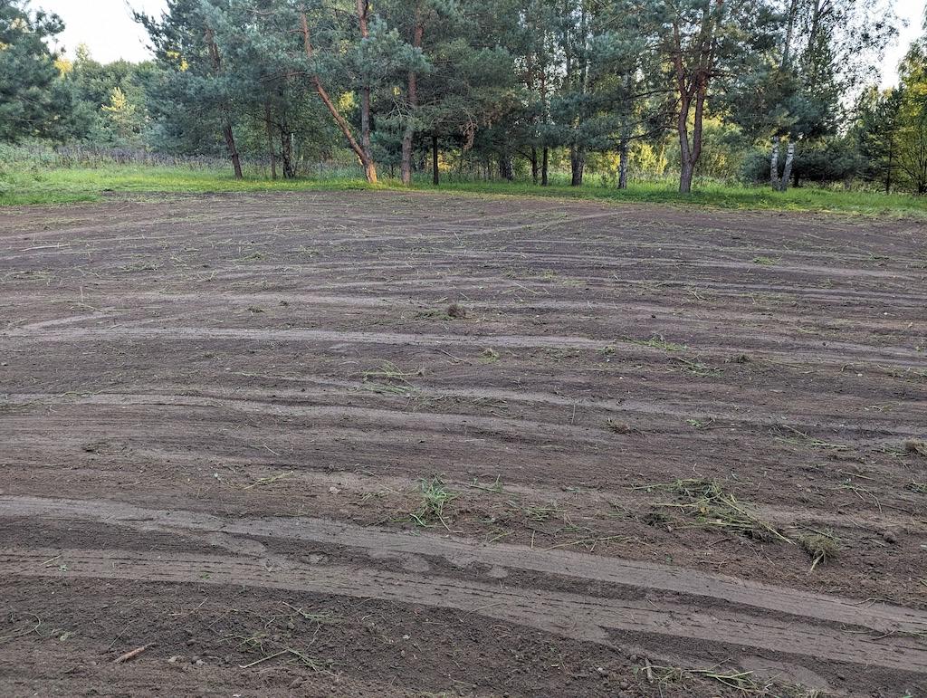

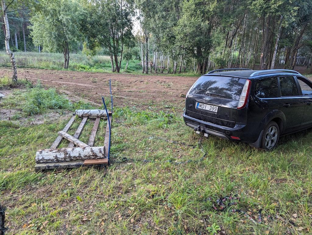

We had some rough ground; made it rougher with a 20 ton excavator moving some of it around / installing a heat pump ground loop etc; and needed to tidy it up. 1) Cultivate / till it (nearest tractor will do) 2) Now what...raking this area by hand requires Olympian endurance... You will need: 4x 3 metre / 10 foot long 2x4s 3x 1 metre-ish / 3 foot-ish long 2x4s 2x logs as extra weight 2x pipes (for corner marking) 2x ratchet straps (spares useful...) 1x small car And it works bloody amazing for levelling and compacting *just right* for putting grass back. The mk1 attempt (6 metre wide rake on a Ford Focus) was a little ambitious. The mk2 attempt (without logs) did fudge all. The mk3 (four logs) was too much of a handbrake. The mk4. you see...just right. I would guess 100-150 kg. Smooths it AND is flat/heavy enough to kick all the field stones and tree roots etc up and out onto the surface. Ready to absolutely not throw in the back of your wife's car like it's a glorified wheelbarrow and spend the journey home wondering how long it'll take to remove all the insects. 😇 Ratchet straps (free end wrapped around the frame once and clamped with a piece of wood; hook end on the car to avoid flying metal bits if it breaks) are the perfect strength for being able to pull this along without being too deadly to car or tree when you get ambitious and chop down to 2 metre width do this bits between the trees... Next month expect a post about moles. 😂

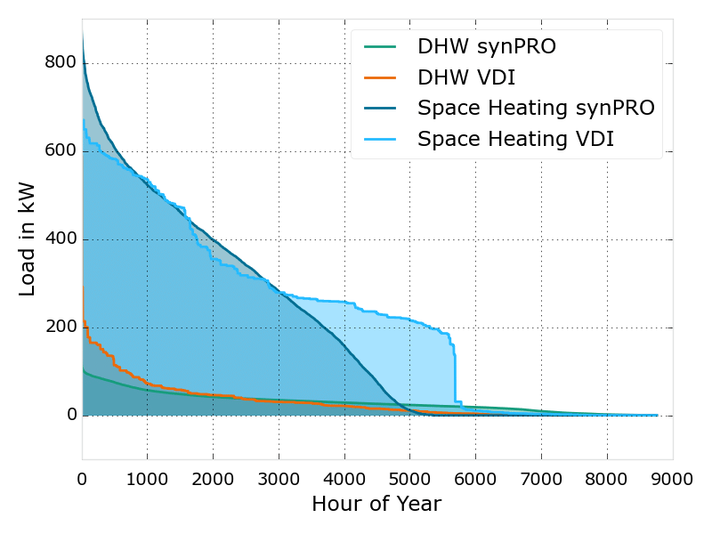

I don't think so. The time spent at full load is very small. (plot the temperature difference each hour of the year as a load duration curve) Lots will be spent in the happy 25-75% range if your unit is sized at 100% of design load. E.g. From: https://www.researchgate.net/publication/291352700_Stochastic_Modelling_and_Simulation_of_Energy_Flows_for_Residential_Areas With VDI reference method from: VDI, “4655 Referenzlastprofile von Ein-und Mehr- familienhäusern für den Einsatz von KWK-Anlagen,” Verein Deutscher Ingenieure (VDI), pp. 3–18, 2008. You can use hourly temperature data and a "balance point" to get similar curves for your choice of climate and building fabric standard. -

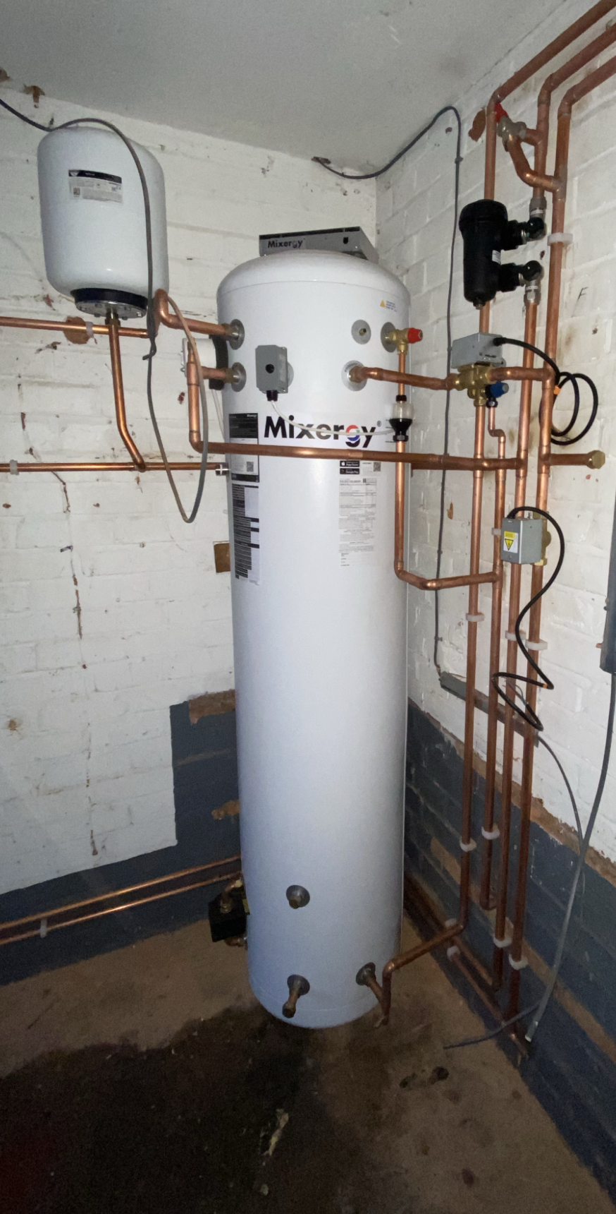

I'm resurrecting this @Dan F based on the "could you rock a small heat pump with a small cylinder" discussion here; and in particular the comments form @HughF on "but Glyn's 5 kW Samsung setup into a 1m2 coil works ok" etc prompted by @JamesPa and @sharpener comments too. That is a 150 litre Vaillant / OSO slimline cylinder with a 1m2 coil. He "holds off" the reheat of the hot water to two time periods each day; in order to only "reheat from cold" rather than "topping off" the tank. The nominal setpoint is 43C. It gets to about 45C at the top of the cylinder with stratification. That is giving a COp of >4 when outside temperature is >7C outdoors. Which us most of the year: https://youtu.be/kkNx2oSO-S4?t=808 Why is @Dan F's Mixergy setup so pants in DHW preparation then? Light bulb. Coil location. Mixergy are forced to put the coil in the stupidest possible place so that they can do the "only partly fill the cylinder" party trick. Like; right at the bloody top: Whereas a regular cylinder will have it at the bottom. This means that the heat pump into a Mixergy primary coil is going whammo; straight into the hottest part of the cylinder; hence being unable to dump the heat from the compressor into the cylinder at anything other than some deltaT above the hotter part of the cylinder. You could manually run the Mixergy charging / destratification pump; to stir up the cylinder and make it all the same temperature. That would mitigate the effect; at the expense of the water at the top of the cylinder being unusable until such a time as the whole lot is heated. But what you want is a coil either at the bottom or rising through the entire cylinder. Even a modest area then gives you an ok COP if the heat pump that's charging it has a modest output. I had in my head that "a small coil like a Mixergy would be no good even on a 7 kW class heat pump" without having clocked where that coil was and the effect that this would have. I'm now wondering out loud about these: Was previously toying with plate-loading a direct cylinder that would fit under an oven: https://osohotwater.co.uk/product/super-xpress-hot-water-cylinder/ Now toying with an absolutely boggo coil cylinder (0.8 m2) under an oven. (1160 high even with all the expansion and inlet group etc in "180L = 163 litre actual capacity) https://osohotwater.co.uk/product/super-coil-hot-water-cylinder/ Not ideal by any means (why don't they make one of these with a say a 2m2 coil in this form factor...) but perhaps not horiffic. The large coil variants all have a ruddy great T&P relief stuck out the side; in addition to being 595 mm not 580 mm width. (too tight even for the bravest of squeezing it in place of a kitchen unit jobs) https://osohotwater.co.uk/product/delta-geocoil/ And the Vaillants have the T&P relief and an immersion heater cover in addition to everything being side exit/needing external expansions etc 😕 https://www.vaillant.co.uk/downloads/product-manuals/unistor-1/unistor-pre-plumbed-heat-pump-cylinder-domestic-installation-and-maintenance-instructions-1956775.pdf -

Hmmm! Thoughts out loud: This is: - A 6 kW could input from a standard "low temp" F-Gas heat pump - A cylinder setpoint of 42 degC, which best case gives 150 litres of shower water (allowing for some destratification), and then reheats at 6 kW - And a NEW cylinder with decent insulation but perhaps more importantly a completely clean 1m2 coil that runs halfway up the cylinder. Looks like it works nicely; heat pump wise; and it'll also have low standing heat losses etc. I'm sold on this being a functional option The capacity is miniscule though due to the temperature it is being operated at. Works for a self confessed hair shirt. I perhaps wouldn't want to be the father selling this to a wife and 2.4 long haired daughters though. I would roll my eyes at it if buying the place. If it were a more modern heat pump you could perhaps have 50C for the same COP; if reheated at the same rate. Still a relatively low capacity cylinder. Now to the "miscellaneous old cylinder" option for a "typical retrofit" (rather than a brand new cylinder, purchased independently of the heat pump, either for reasons of necessity or due to poor planning) It's for sure gonna have higher heat losses. What is the coil? 0.6 m2 is quite different to 1.0 m2. Is it in the bottom of the cylinder only (trying to stir the thing up using convection currents) or does it extend through more of the cylinder? Is it clean, or has it been heated to 80C in the southeast of England and is there the usual 20 of scale on the coil / in the bottom of the cylinder? Was it ever big enough at 60C? Is it gonna be big enough at 42C or 50C? Did you want an invented to sack off all the roof tanks and pumps etc? Given the small material cost of a cylinder vs a paid heat pump install, and the opportunity to get it all without VAT, would you be daft not to swap it? Probably. Retail (what the fitter would charge) on those slimlines is 1165+VAT https://midsummerwholesale.co.uk/buy/vaillant-heat-pumps/vaillant-cylinder-150l Retail on the biggest baddest cylinder in that range is 1605+VAT https://midsummerwholesale.co.uk/buy/vaillant-heat-pumps/vaillant-cylinder-300l Some will say fuggit; do it. I think this is the reality of anybody serious about an upgrade. Some will ask to reuse an old piece of shite with the potential to be a scale filled liability that was last touched by the fitter etc. Or cause complaints due to low stored volume. The fitter will say naah, not worth the risk. Now say the cylinder is relatively new. Say it might / will probably actually work. If fitters are looking for work, and price is a consideration, they might entertain taking the time to check if they can use that and the risk of touching it last. Reality: they're not looking for work. Demand exceeds supply. They're going to choose the jobs which pay the most. If you're interested in a new cylinder you'll get a fair price for a new cylinder. If you're not interested in a new cylinder you're going to get much the same price. This only changes once supply exceeds demand. The big boys and girls have additional constraints. BG evidently won't install ANYTHING other than in accordance with the manufacturer's backside covering instructions. Fitters won't get the leeway. You can't DIY this because of the f**king MCS cartel. Not just the grant. It's not even legal. (planning) Nor can you MCS space heating only. Not grant eligible. And that's perhaps the kicker. Don't blame the installer for wanting to include hot water. They're obligated to otherwise the job costs £5k more. And if they're gonna do hot water to get the grant - you automatically increase costs by £5k by not doing hot water - to then they think you're daft for not going all out on maximum performance and pleasure and resale value, but perhaps can't articulate this in the best way? I think MCS are f**ks and HMG are fools for promoting them. Just in case that wasn't clear before! Octopus are known to be targeting 90s Barratt estates. Where there are 30 year old vented cylinders in houses due for their first bathroom swaps/cylinder swaps etc. And much of the heating was still large bore copper. Probably not accidental?
