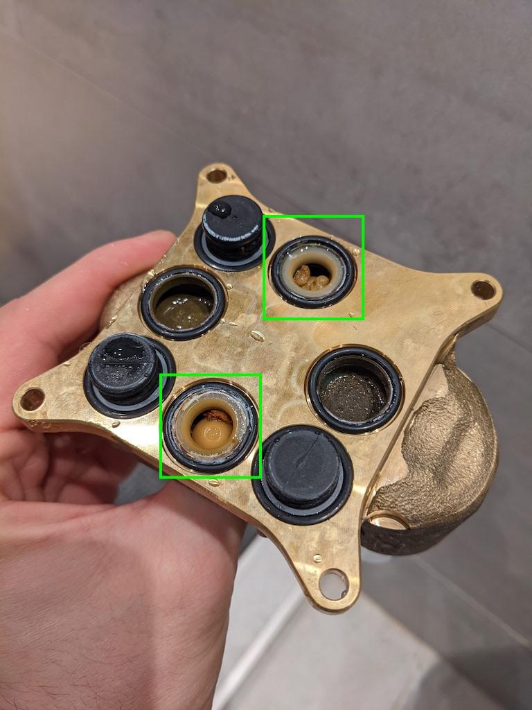

  15. Domestic shower drains can have hopelessly poor traps in my experience. Work out how to pull the trap and unbung the hairsoap from it. No chemicals required. Pipework will be clear downstream of trap.

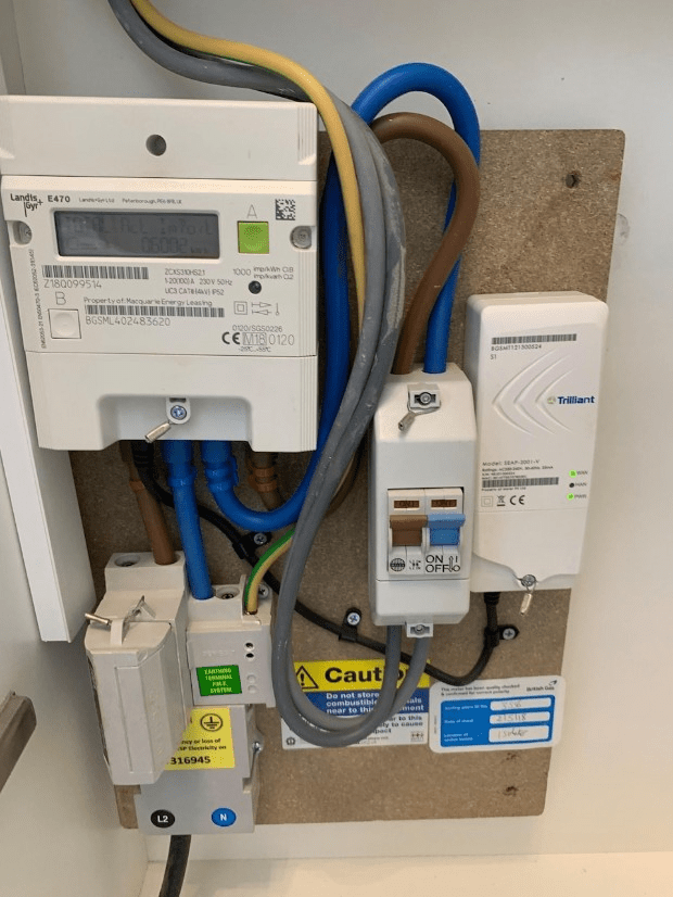

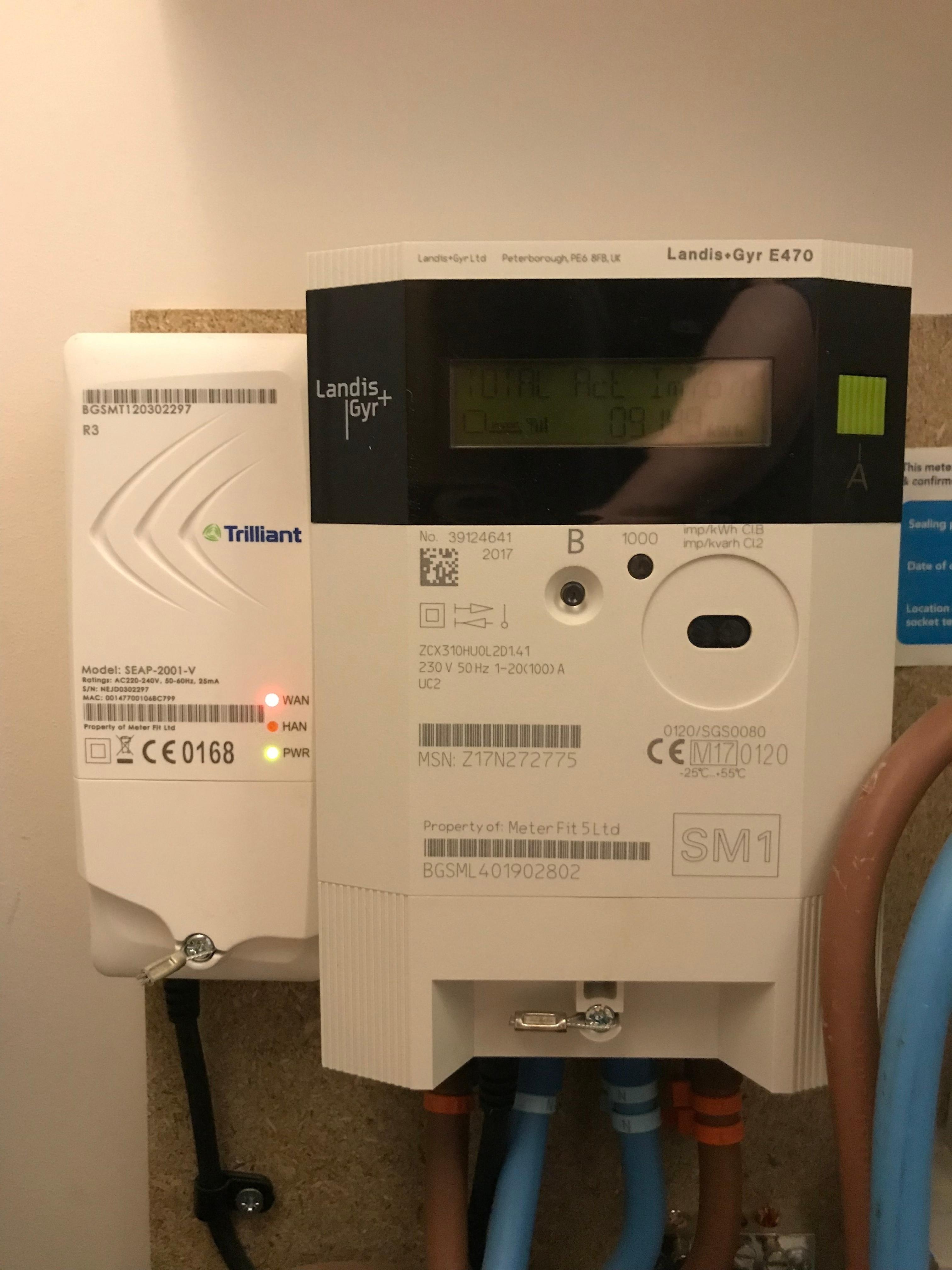

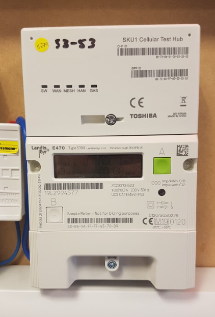

  17. Wouldn't be so sure. Here's the list https://www.smartme.co.uk/smets-2.html Some models are chunky Vs what's there now - depends what the vendor wants to fit. E470s for example:

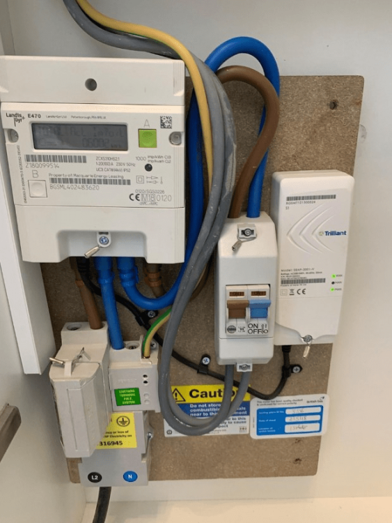

  18. Your switchgear ought not to be in the meter box. Meter box: [Cutout > Meter > DP Isolator] External box: [your own switchgear] Do you need fuses or could you get away with isolators? (physically smaller) https://www.toolstation.com/axiom-isolator-with-enclosure/p92544 Ideally you'd have an N-way board sat adjacent the meter cupboard (one mains incomer / double pole isolator; with MCBs to feed man cave / ev charge / solar pv etc and indeed house if it needs reducing to 63A for reasons of long consumer unit tails?) That would also delete the Henley block up at the top; and give you somewhere to terminal the SWA that looks to go to another box in the top tight hand side. Depends on exactly which meter they wish to fit but I think you'd get away with there being enough space if you can delete the "man cave" switchfuse and the henley cocks above it.
