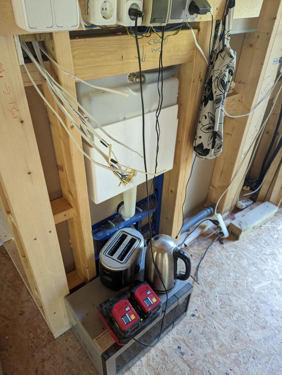

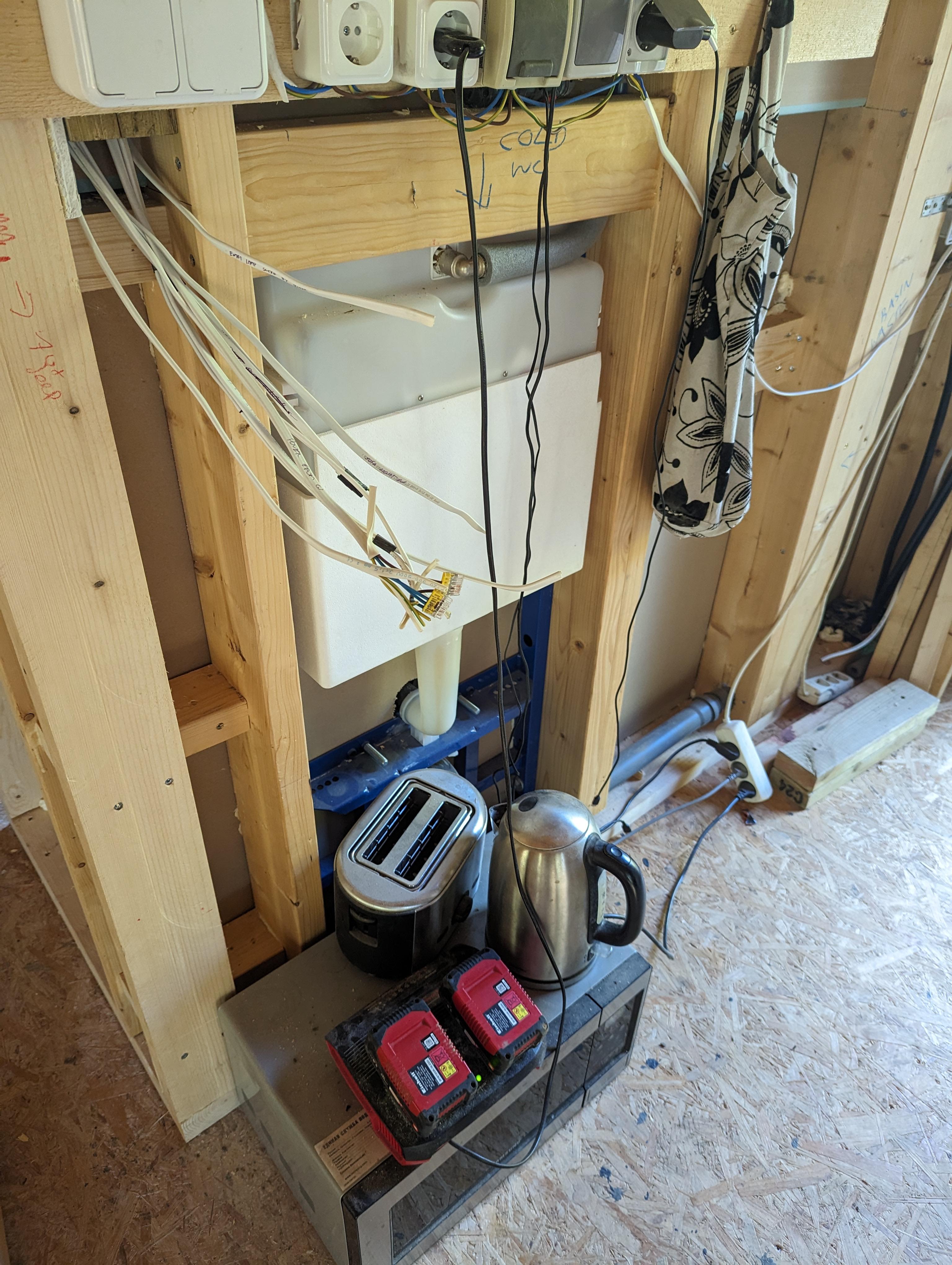

I was sceptical. Can confirm is solid as they come if the frame is the depth of the cistern. Drill a bunch of holes through the sides of the metal frame (with cistern out) and screw through into the stud with half a dozen shear screws each side. (the sort used for joist hangars etc) Some adhesive from frame to stud won't hurt. Most load goes into floor. The "peeling of the wall" load is all you're carrying, in pure shear, and can promise it'll go nowhere with a few screws let alone screws/glue. Shear rated screws example: https://www.amazon.co.uk/Angle-Fitting-Screw-Connector-Screws/dp/B09DDC65PX

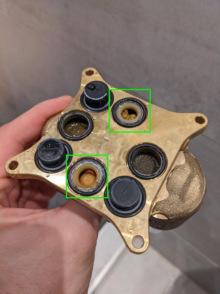

Could also be crud in the valves. Here was our shower following some repairs to the apartment building... The muck holding those check valves open caused backflow of cold water into the hot water system...much to the annoyance of our neighbours. 🙂
This can absolutely happen where pressures are imbalanced in any shape or form. Very common issue in apartment buildings with shared hot water systems. Incorrect plumbing for the cold feed (taken from the non pressure balanced side) and no non return valves on the mixers would lead to this.
What temperature are you storing the hot water at? Cheapo mixers need a headroom of 5-10C for the hot water temperature and the mixed temperature. And a minimum about of cold water at part of the mix for stable operation. If your heart pump is heading there tank to too low a temperature you can observe this behaviour. Non thermostatic mixers (kitchen tap etc) won't do this.
