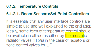

I have 'thermostats (TRVs) in every room, thus satisfying those who (incorrectly so far as I am aware) claim that this is a 'requirement'. All but two are turned up to max and have their heads unscrewed to ensure that they have no actual effect. You can do exactly the same with 'thermostats'. The two that are active are: 1. a fancoil which adjusts its fan speed (but not the flow rate) depending on temperature 2. a TRV in the guest room as a courtesy to guests. Everything else is open loop. There is no buffer. Problem solved. An alternative good compromise advocated by many is TRVs in the upstairs bedrooms, open loop downstairs This misses the real problem with buffers, namely that they almost invariably are set up poorly and/or are insufficiently large to force stratification and thus mixing between flow and return occurs. This reduces the FT to the emitters for any given FT from the heat pump, typically by an amount equal to the DT across the emitters. Thus the heat pump must run hotter than it otherwise would. For a standard 5C DT this increases heat pump consumption by ~15%, a bit less with the low temperatures that UFH runs at. Where as a matter of interest? I found this Which does not say that there must be a thermostat in each room. There are similar paragraphs for UFH and fancoils, but nowhere a requirement -
