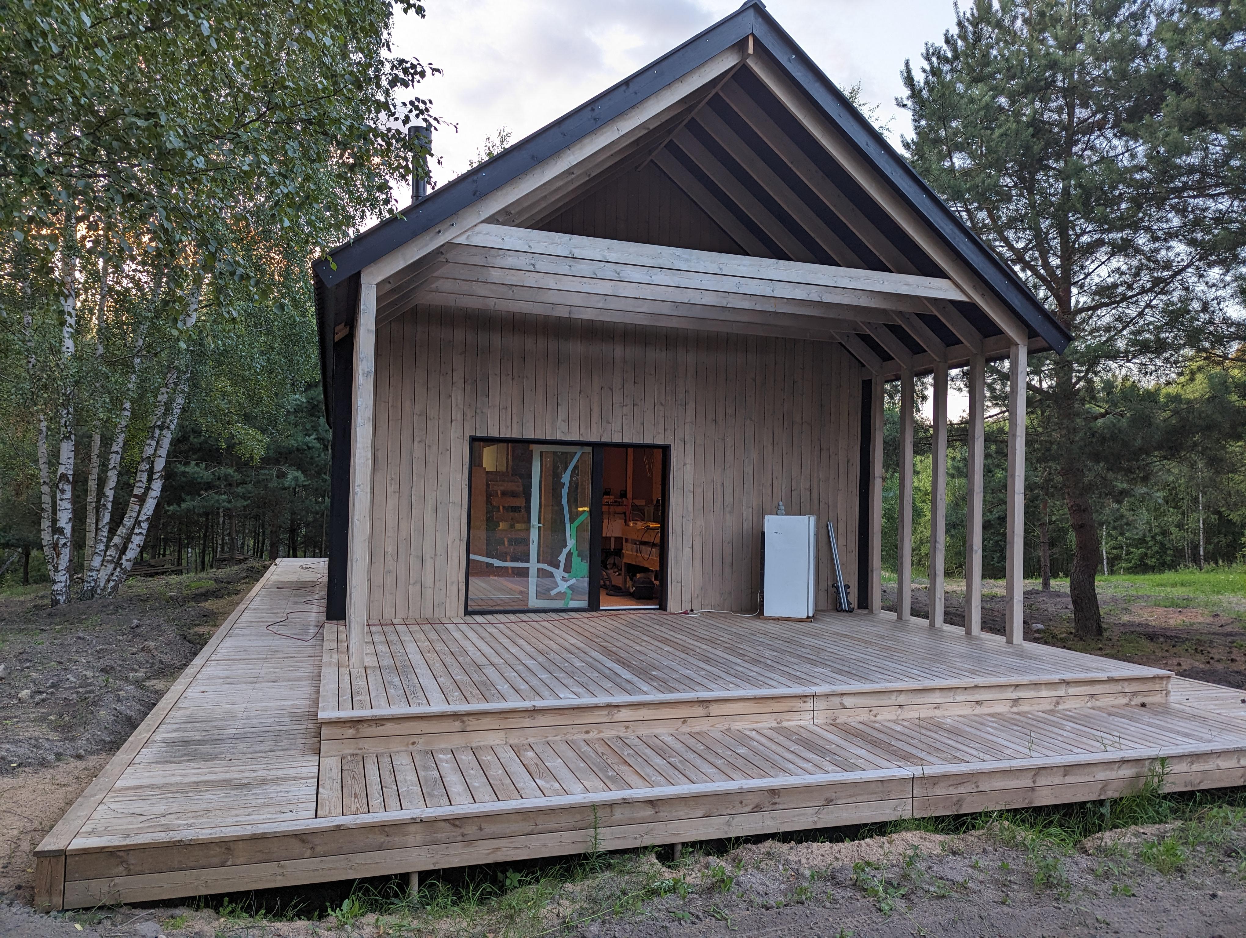

We also considered this. Rejected it because it's an invitation for wasps/hornets etc to make home behind the boards; and those little swines will much straight through any membranes (which must now by UV proof) that you have behind there. We used decking on the deck (120*28 mm nominal) and square edge overlapping cladding (145 mm; overlap meant for 10 mm nominal space between boards) on the walls. https://www.statybumedis.lt/lygi-terasa-28x120mm-ab-kat-iki-5proc-c-kl-pusis-impr-giluminiu-budu-ruda74576-1-65886.html https://www.statybumedis.lt/vertikalios-su-5mm-tarpuku-20x96120145mm-c-kl--egle-siurkstus-pav74541-1-60518.html Wound up like this. Decking still to be cleaned/coated. (we were waiting for excess brown dip coat to rinse off and weather a little) Cladding for a tinted acrylic dispersion from Cetol; to keep it "weathered look" rather than they "mmmmm yellow" that it would turn if given only a clear coat.

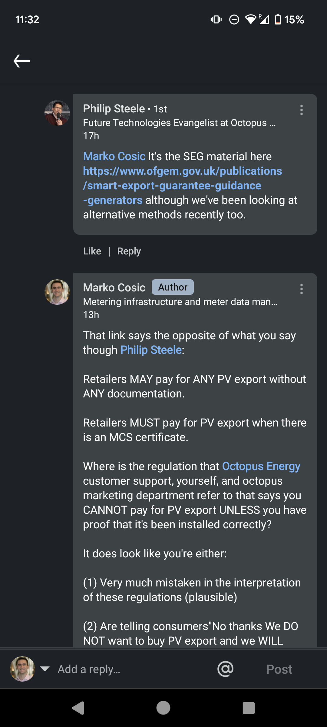

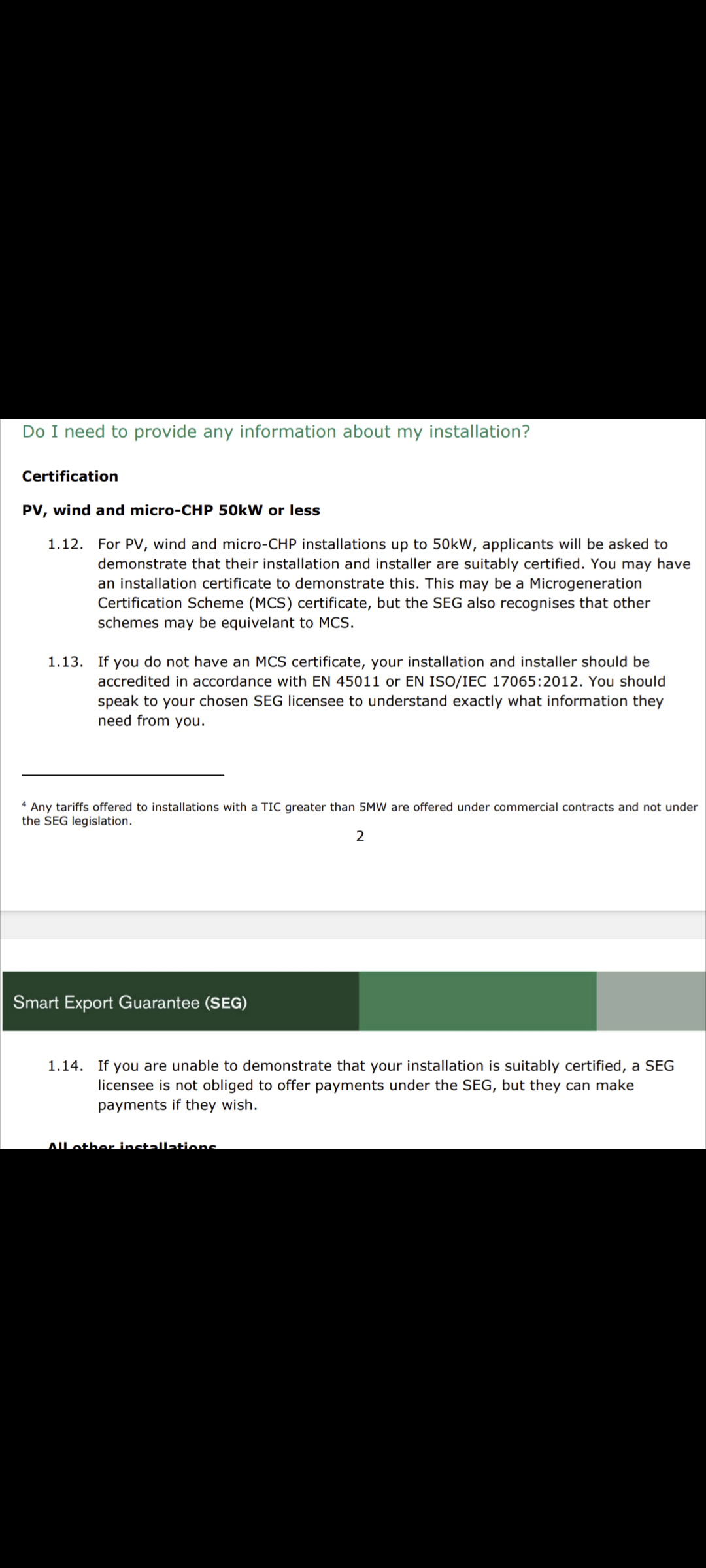

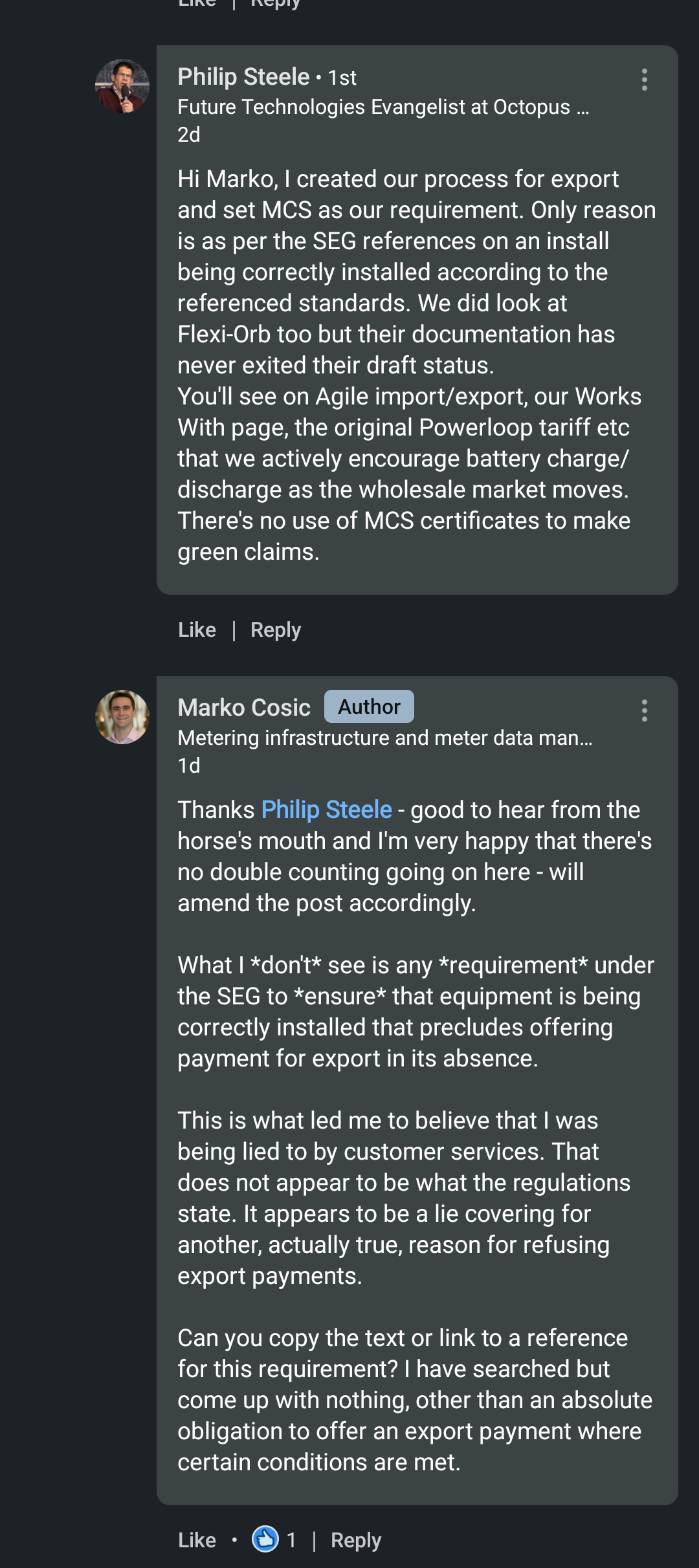

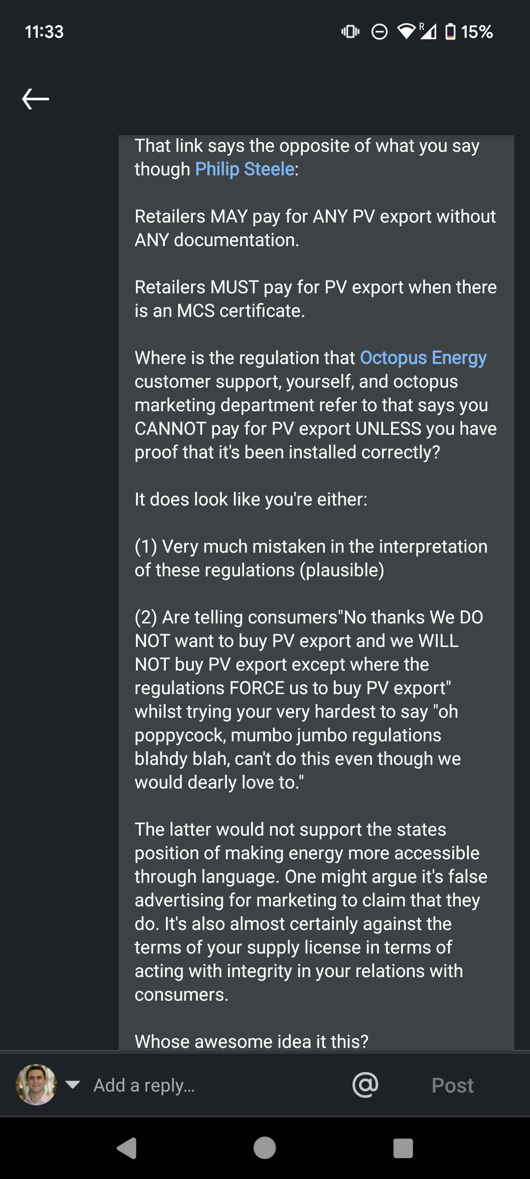

Why? They're completely dishonest little swines that tell bear faced lies to consumers... For example, that regulators require MCS certification for export payments; whereas in truth they simply don't want to pay for PV export unless (a) they're legally forced to by virtue of there being an MCS certificate or (b) you're part of their completely artificially priced and R&D /Marketing programme in load shifting (flux etc). See exchange with the octopus chap below. If they bare face lie to you it's only fit and proper that you return the favour IMO.
