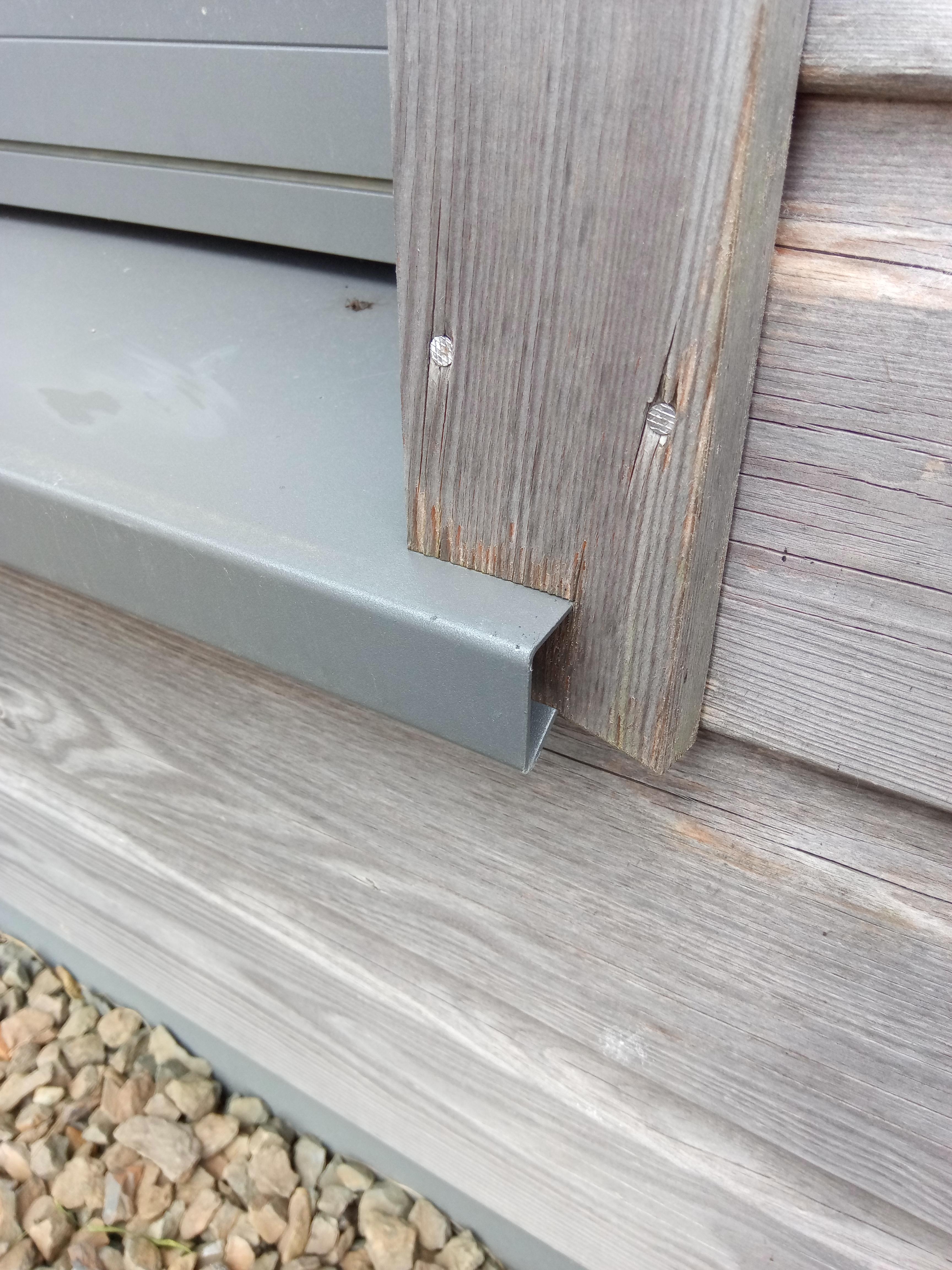

Quick photo of our custom folded aluminium cill. With all our EWI, the window company cill wasn't going to be big enough. I got mine folded and painted by: https://www.mspcladding.co.uk/ Very helpful, happy to deal with small order and a lot cheaper than the window company.
