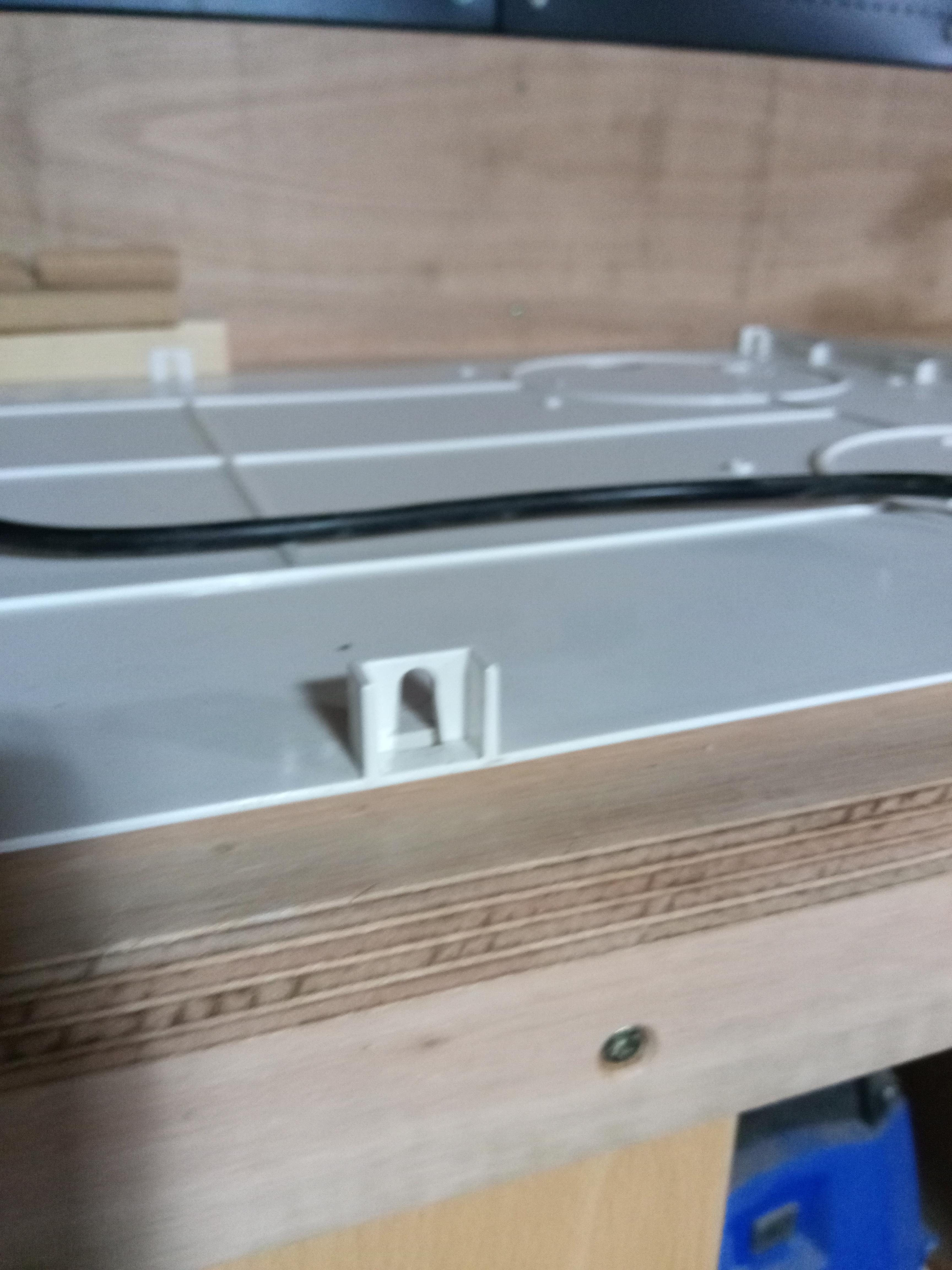

As referenced in another thread, I have a Vent Axia Sentinel Kinetic Plus MVHR unit. @Declan52 and I have both found the fixings used to secure the front and back covers to be next to useless, with each of us having broken fixing points. Chimney nuts slide over the the plastic fixing points pictured, with longish M3 bolts (with a really annoying 4 blade windmill head) then passing through the chimney nuts. Setting aside the bolt heads as an issue, the biggest problem is the movement in the chimney bolts and trying to properly seat the bolts in when refitting the front panel after servicing the unit. I would like to use a fixing nut that does not move/ is more robust. In my mind an adaptor with threaded 7mm outer diameter (to fit through the hole), threaded 3 or 4 mm internal diameter would be perfect as I could secure the adaptor in place on the fixing point with a nut on the blind side so the fixing doesn't move. Something like this: Other options seem to be: Jacknut Rivnut Small metal cavity fixing Rubber wellnut / rivnut Threaded insert held in place with nut on both sides Anyone have any other bright ideas?

A previous MVHR unit I had was like that, hinged at the bottom, with two robust toggle / latch fixings at the top. Easy access inside and condensation collection was simply a tray at the bottom with outlet. Easy to see, clean and maintain. I've just emailed Vent Axia to see what they say, in particular for the best method to clean the drain outlet, and if they have replacement fixing arrangements to replace the woeful bolt and spire nut combination.

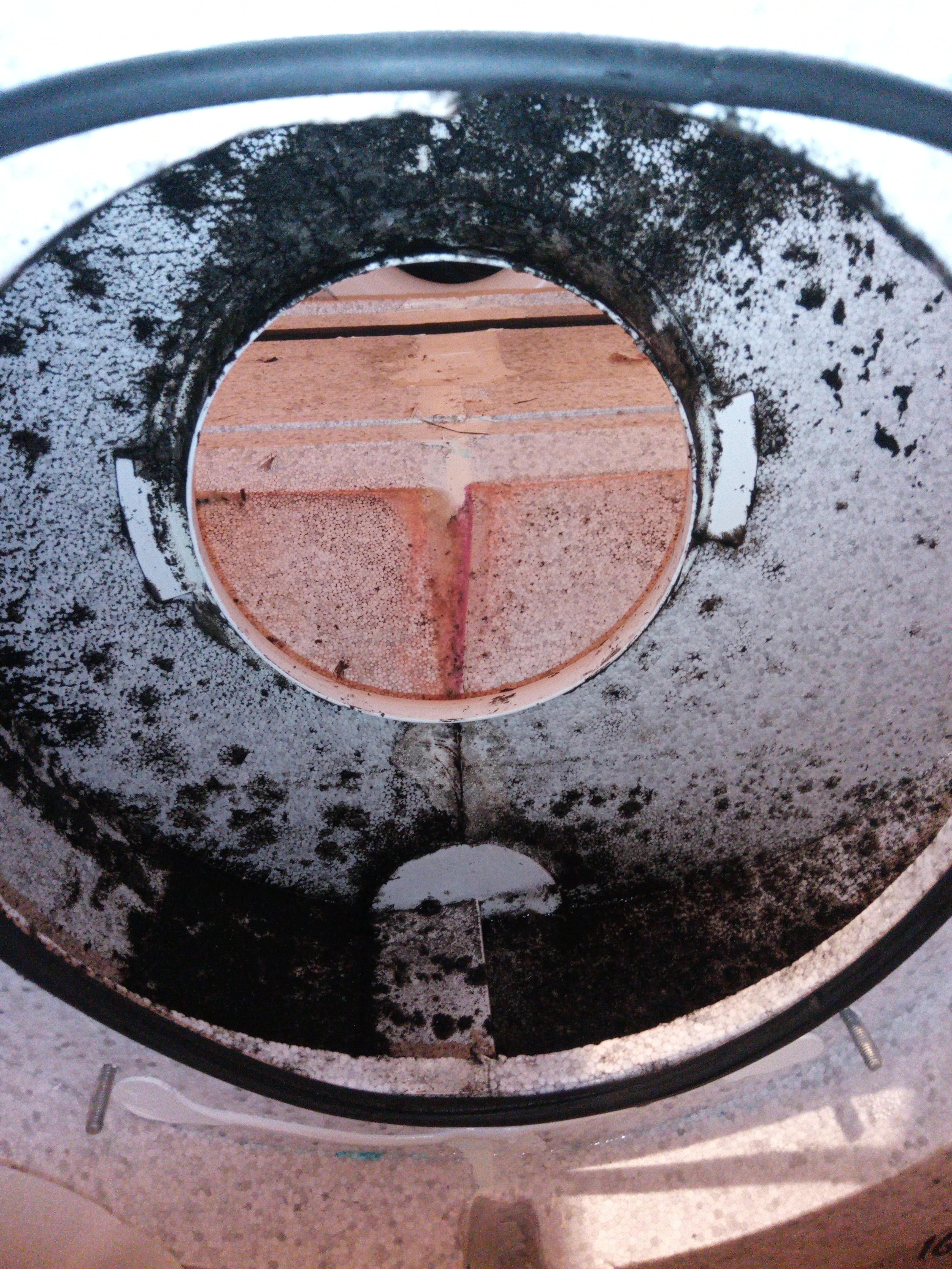

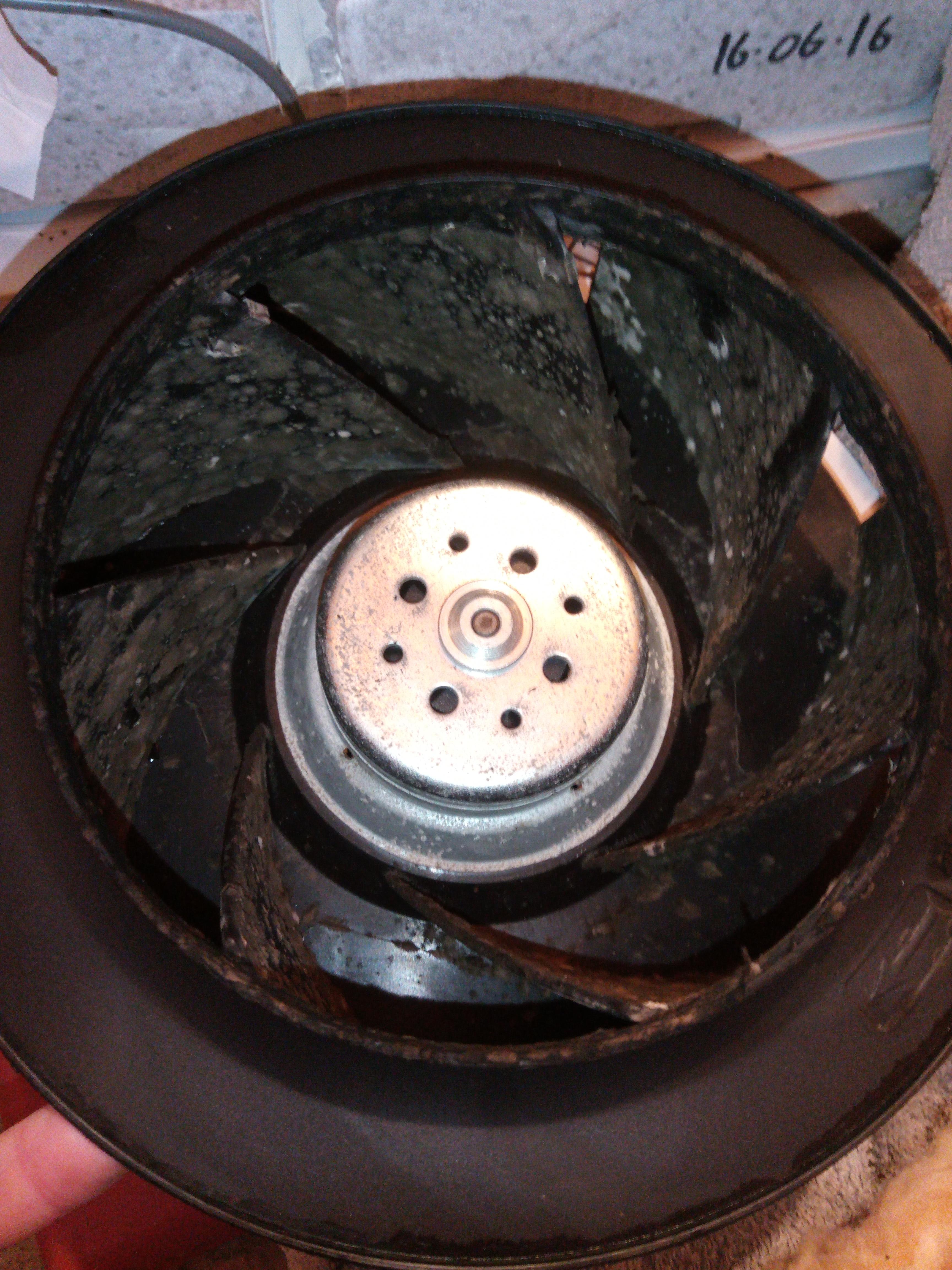

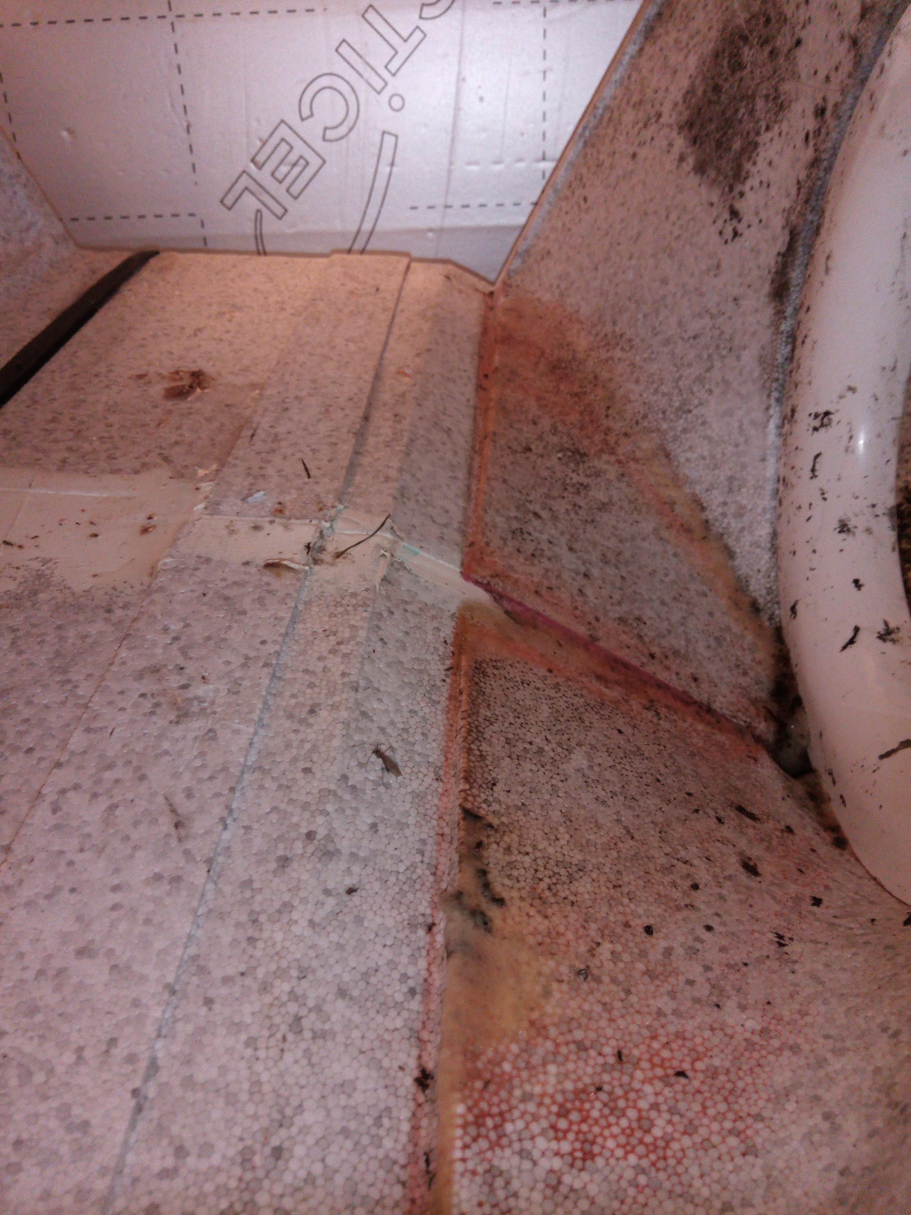

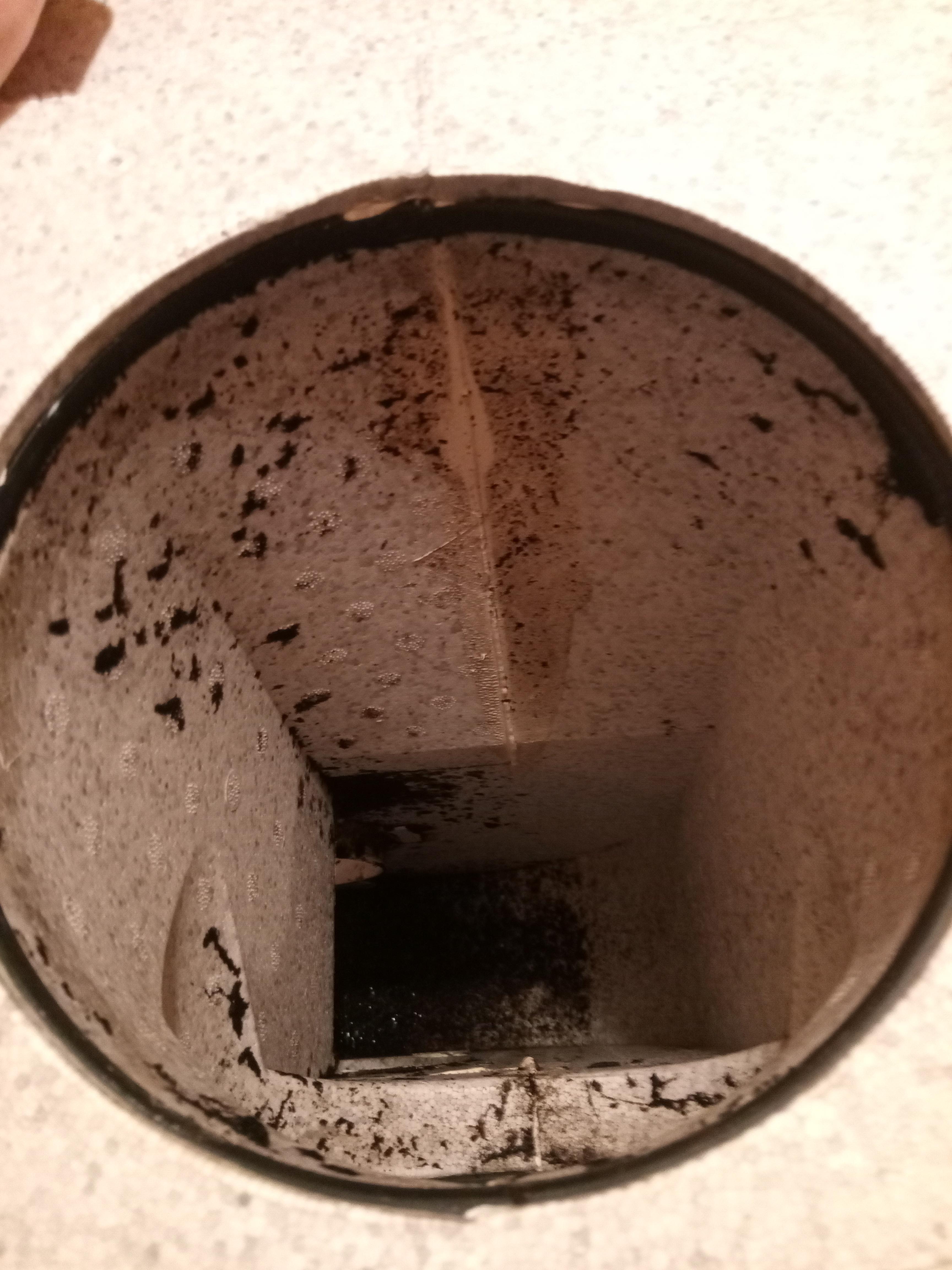

Bit of an update, 3 years in. I've been changing filters every 6 months and servicing the unit (core, fan blades, drain) every 12 months. Last night, some odd noises coming form the exhaust vents, which made me think a bearing had gone. So today's job was checking. And this is what I found... Thankfully all on the exhaust side after post the heat exchange core. The cause of all this was the condensate drain being blocked with mould and 'biojelly' (see last pic, the large black area). It would seem that in not draining away, water has overflowed or been pulled into the exhaust fan chamber where it has obviously coated the fan blades and walls of the chamber. No warning indicators or lights to suggest a problem of course. So, having found the problem, I had to take the whole unit apart, remove the top and sides (which slide and interlock with each other)to get to the back of the fan. Unbolt and remove fan to get into the chamber. Interestingly, this seems to be the only way you can properly clean the fan blades as you certainly can't do it from inside the main body of the unit. A lot of wipes used to remove the mould, then a generous application of bleach to kill the nasties and clean it up. Fan blades cleaned and all reassembled. Should be easy but took best part of the day, in large part due to the poor design of the unit. Screws and fixings (referenced earlier) used to secure body panels were a real pain, and I think I'm going to ditch them in favour of cam lock belts. Condensate drain not easy to clean through (must get a bottle brush). Best part of £1250 for one of these units and this is what happens. Never had this problem before, having had MVHR (different makes) in 5 previous houses. I am not a happy bunny right now.
