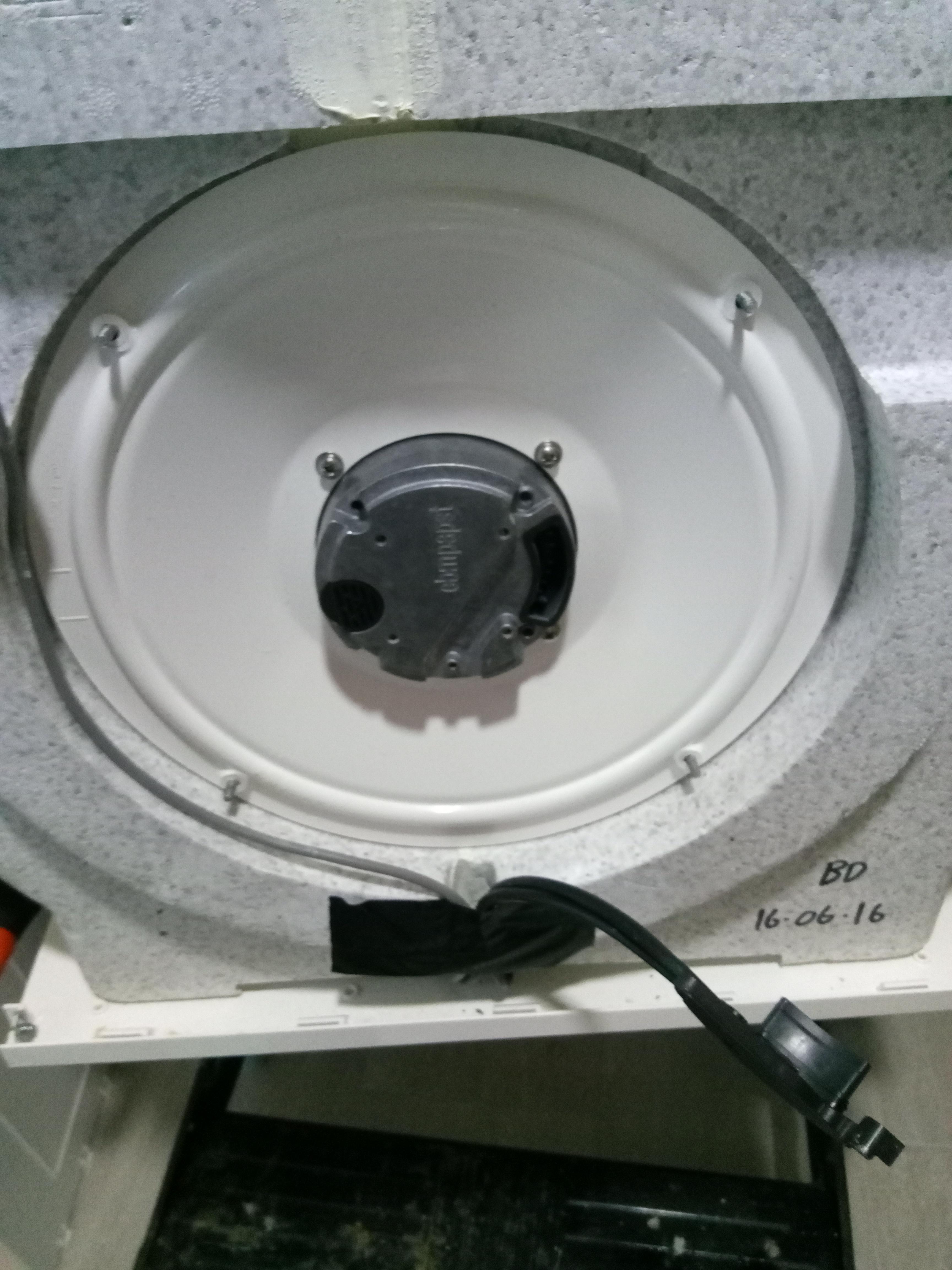

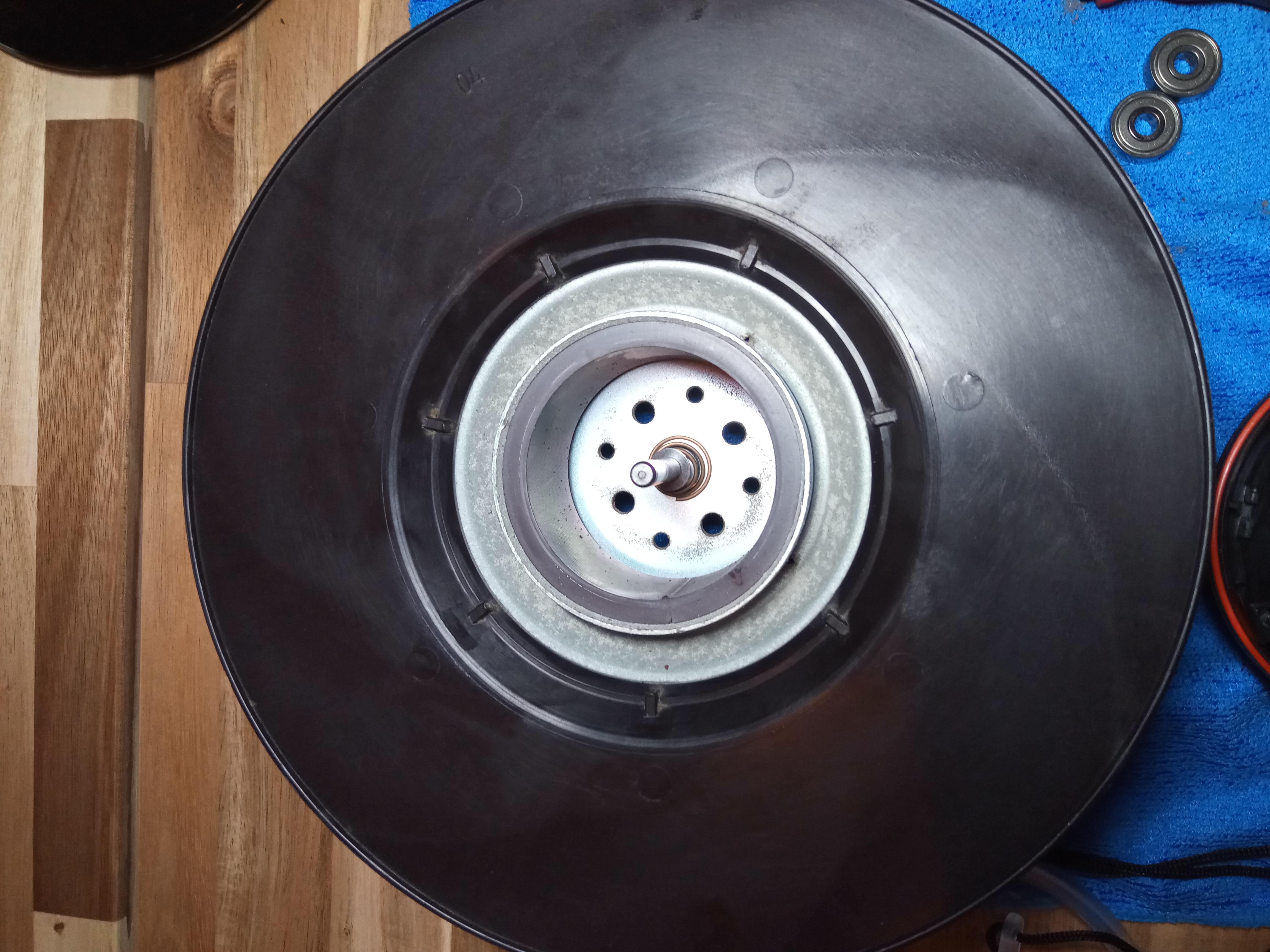

A further update to this, replaced the bearings with SKF as recommended. So far so good - a real difference, whisper quiet.

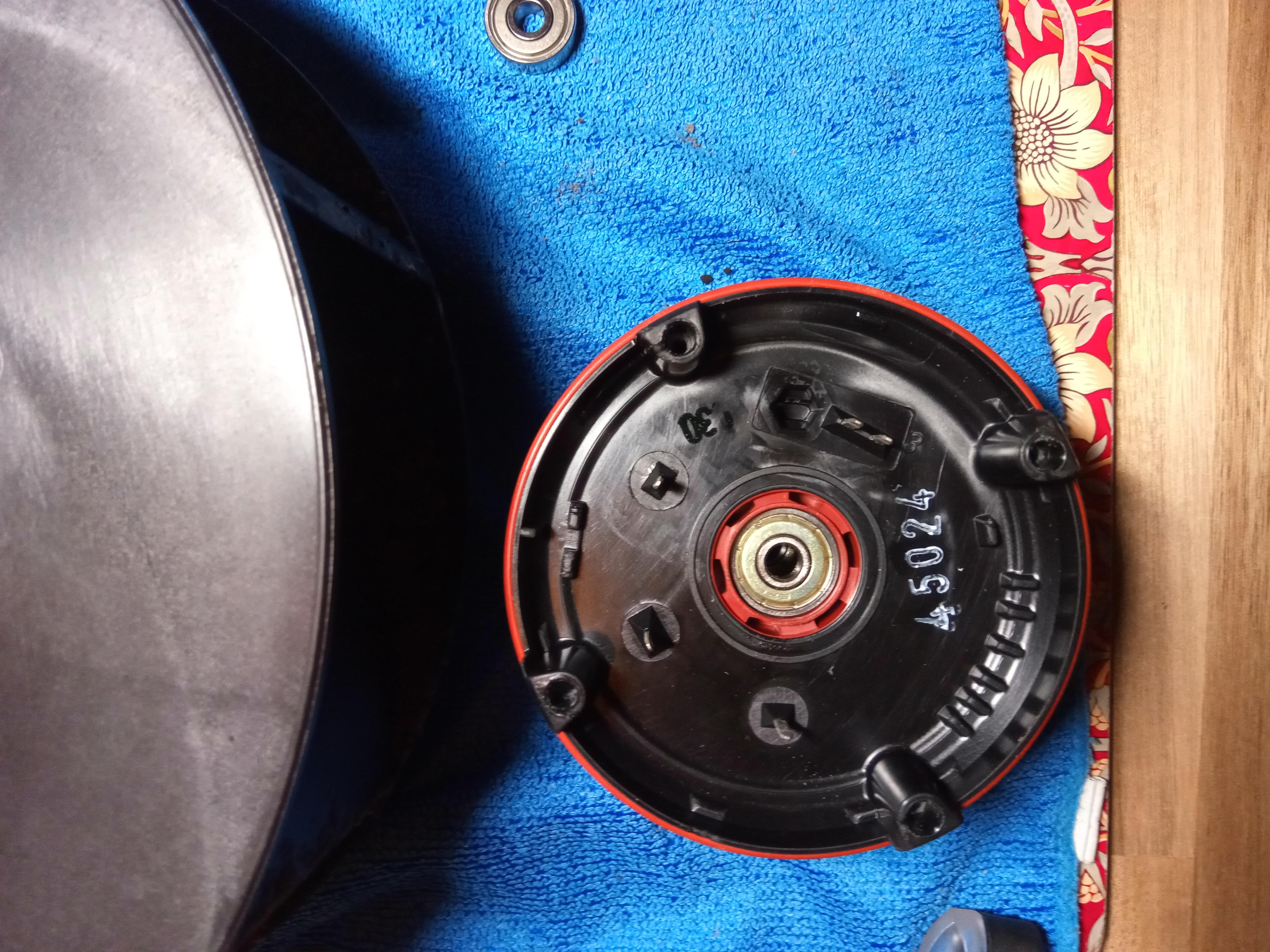

Short update to this. The replacement bearings seem to have failed, as the fan has been getting noisier and noiser. This may simply be the fact the bearings were cheap and poor quality, but nonetheless annoying. I have therefore replaced them again but there doesn't seem to be much in the way of improvement (same batch of bearings). I really don't want to have to replace the fans themselves given the cost, but other than getting some different bearings there's not much I can do or think of doing. Given the cost of replacement fans, and the fact the other fan is now making a little noise, if new (better quality?) bearings don't work, I'd be as well replacing the whole unit given the cost of the controller/control board (also known to fail) runs to several hundreds as well. While nothing lasts forever, and I accept that bearings costing less than £1 fall into that category, its still frustrating. Having looked online, there are several suppliers from which I can buy the right size bearing. Can anyone suggest a quality bearing brand to go for (rather than the no name ones I've tried)?

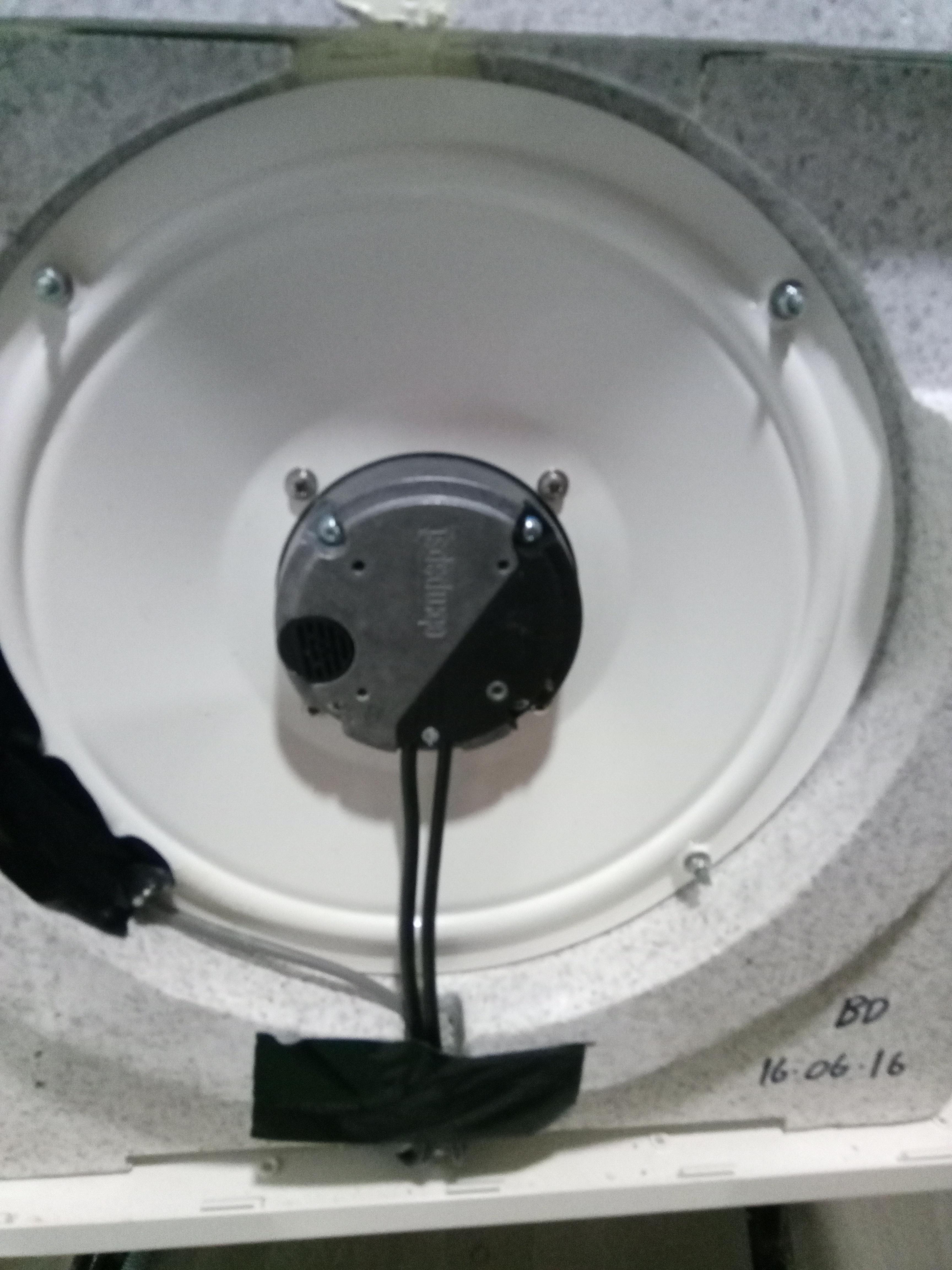

Following on from the excellent post by @DOIGAN where he replaced the bearings in one of the fans from his MVHR, this is a short post to detail the steps to replace the bearings in the extract fan in my Vent Axia Sentinel Kinetic Plus B (being a slightly different model and fan to that of the link below) The process I followed is basically the same as laid out by @DOIGAN in his original post. I've added a couple more pictures and descriptions below. To get at the fans, the unit has to be stripped down. First the duct spigots and blanking plates are removed. Both the back and front covers are then removed, allowing the top and side panels to be taken off - the side panels slide/interlock with the top and bottom panels. You should then have access to the fans on either side which are bolted to the poly core: I then disconnected the power connector to avoid having to try and unplug from the motherboard / cause any other issues. From this point I followed the process as per @DOIGAN Removing the circlip was a bit challenging, as for some reason the hub assembly would not depress, it turns out because the spring beneath wasn't seated properly. I managed to get the circlip off, but naturally it pinged up into the air and I spent several minutes searching for it until finally finding it some distance away. The bearings themselves (one on either end of the hub) popped out easily. I used the same bearings as @DOIGAN Reassembled and back into the MVHR unit. Cost - my time and £7.99 for a pack of 10 bearings vs £298.43 + VAT + shipping charge for a replacement fan from Vent Axia. Vent Axia were unable to give me any detail of the bearings used when I emailed to ask.
