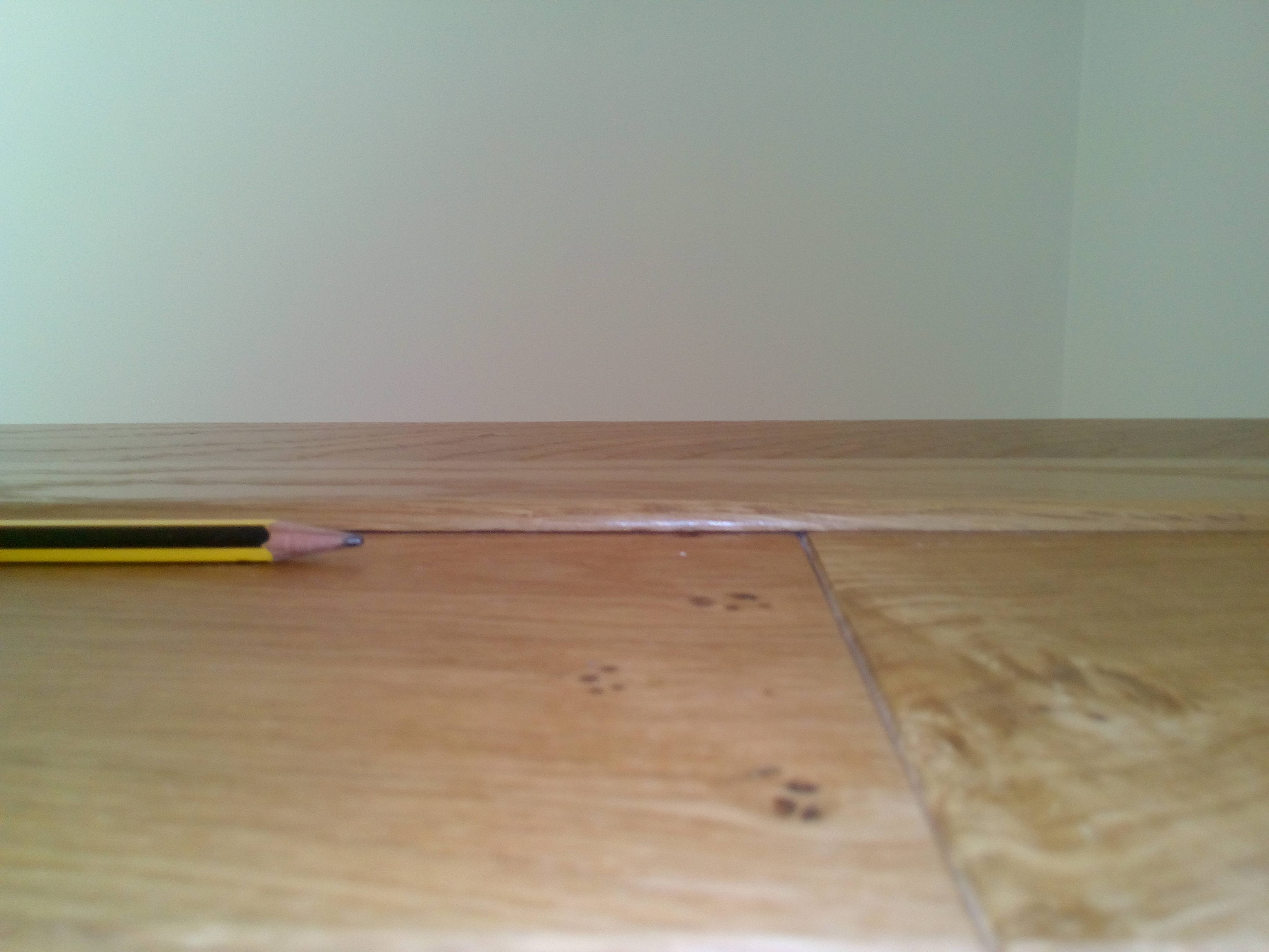

T bar solid oak profile. Push fits into a plastic channel fixed to the subfloor. Sits 4mm proud of the finished floor. https://www.luxuryflooringandfurnishings.co.uk/brushed-and-lacquered-solid-oak-t-profile-door-bar-to-match-oak-flooring.html
No, its just been oiled with Osmo, the same as the oak. Works surprisingly well visually, something a bit different.

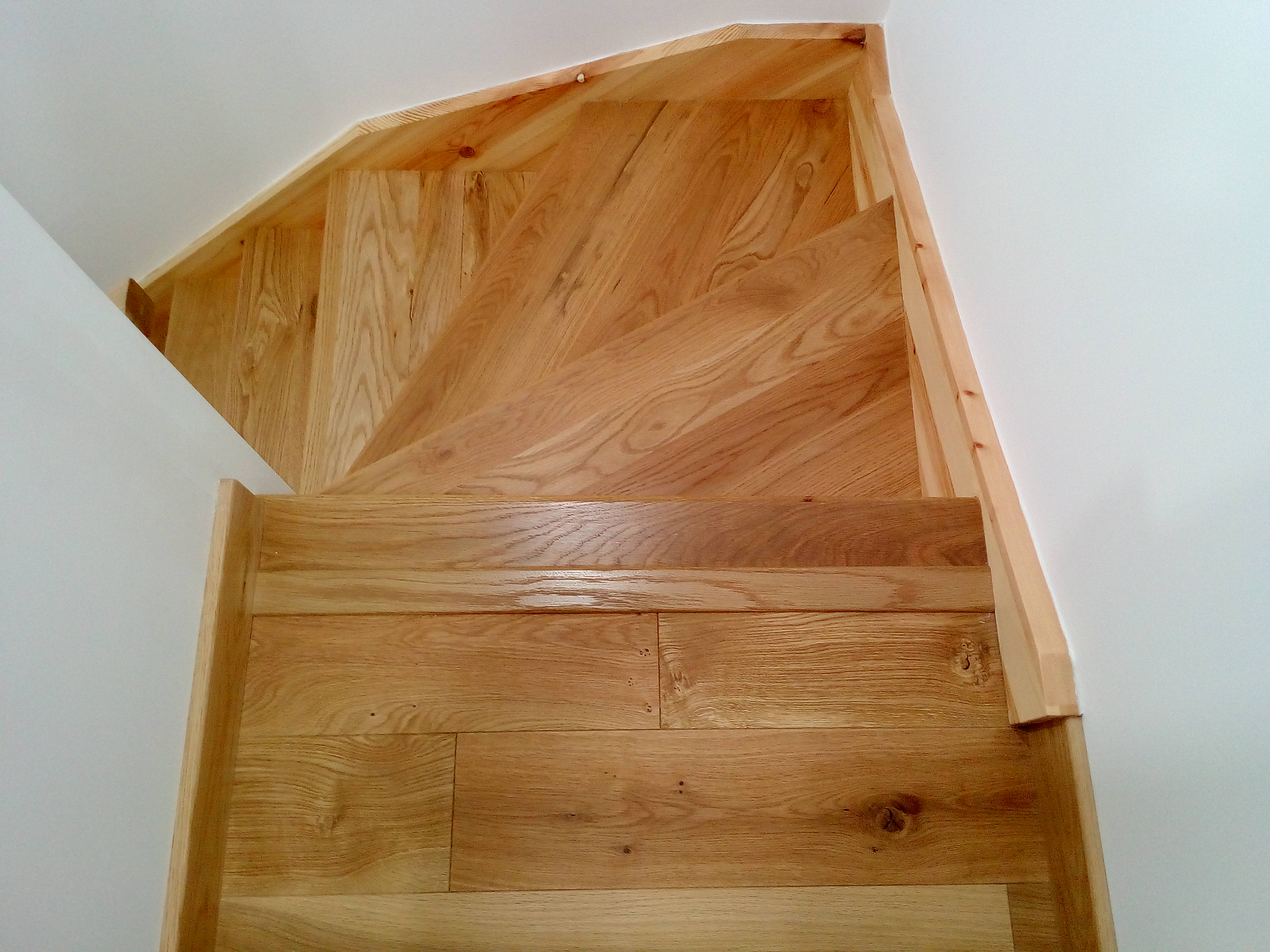

See picture below of how we did ours, exactly as you propose: 20 mm top oak tread. 2mm underlay and 18mm oak flooring. Expansion strip over join.
