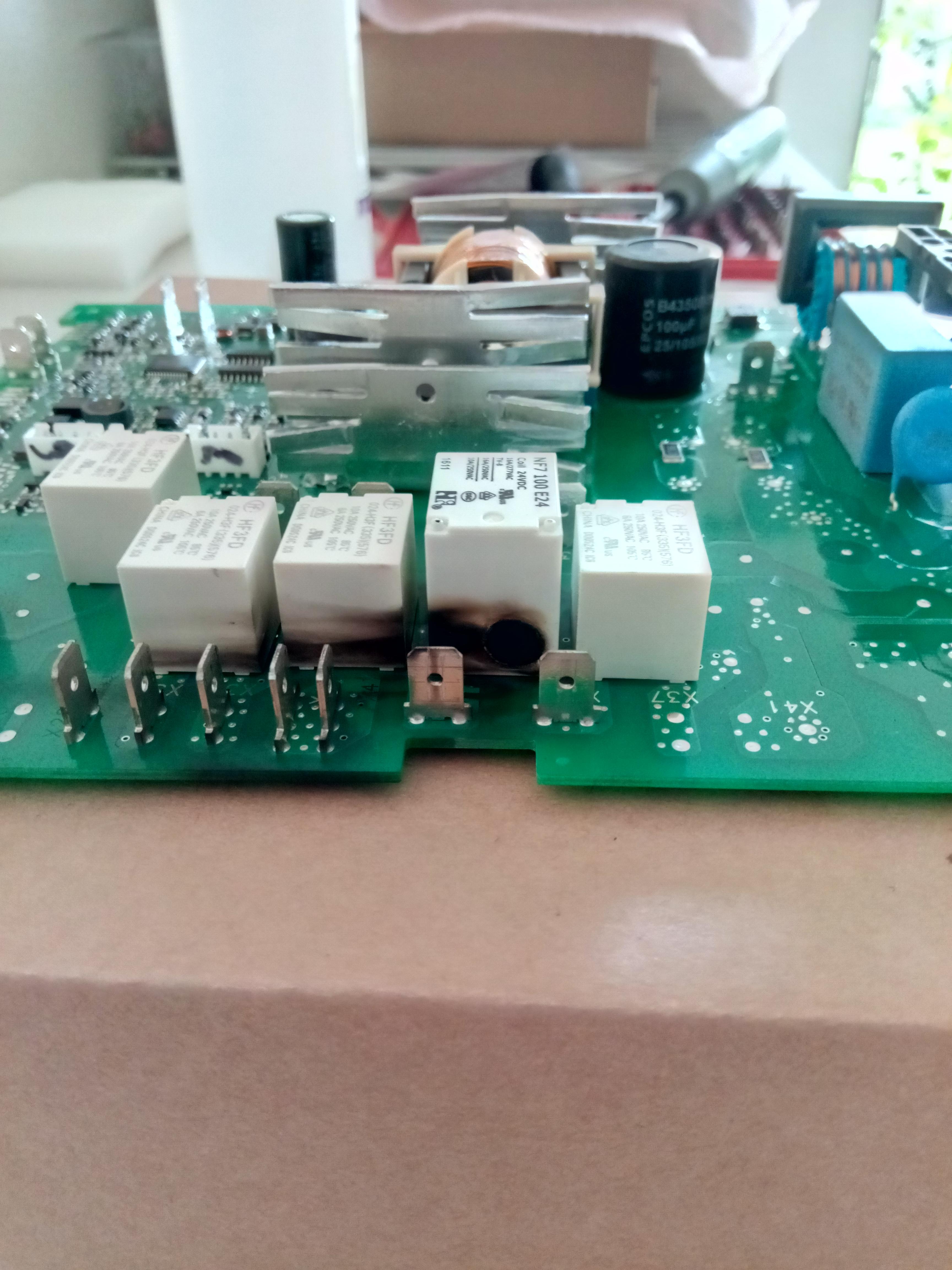

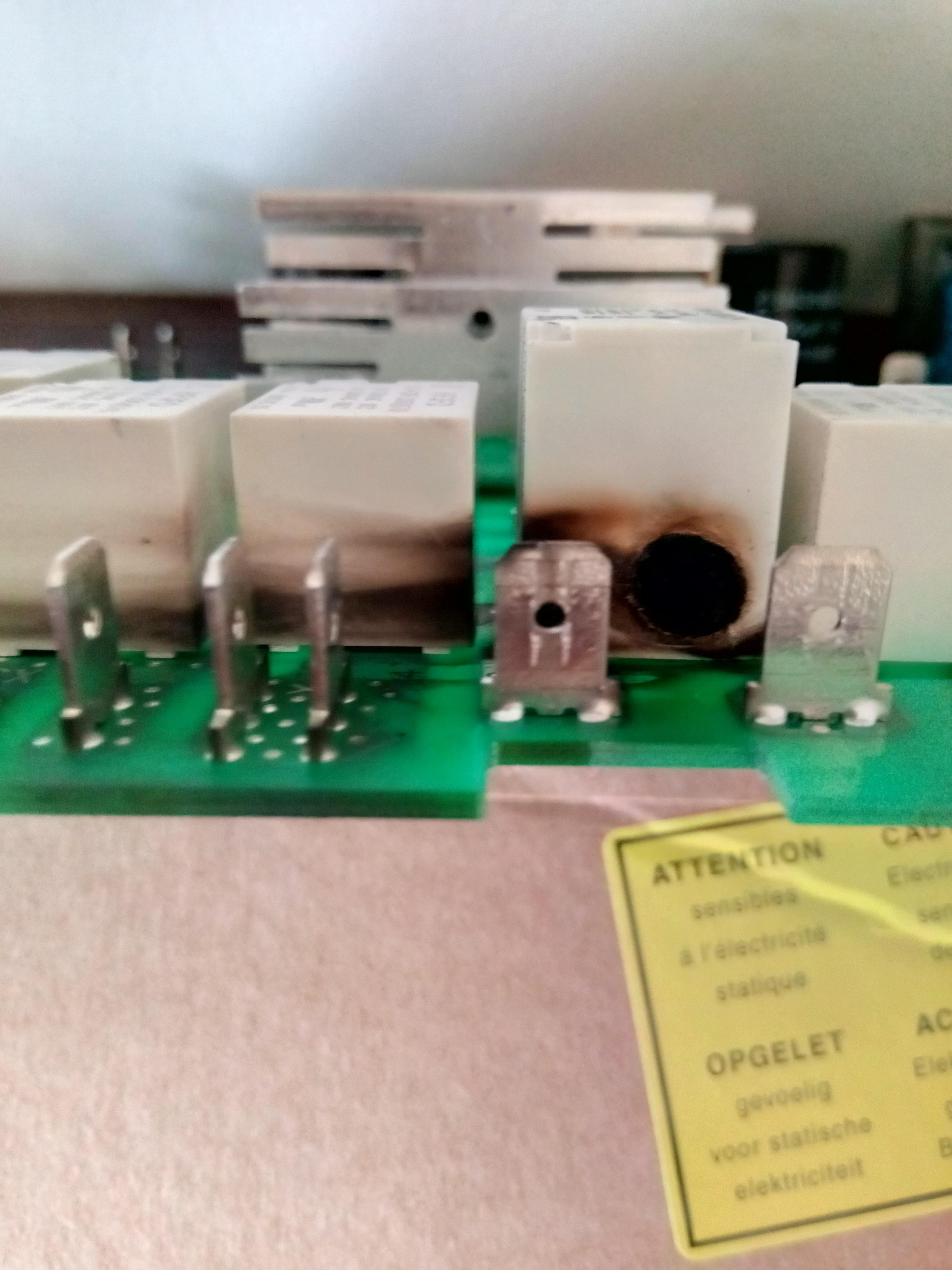

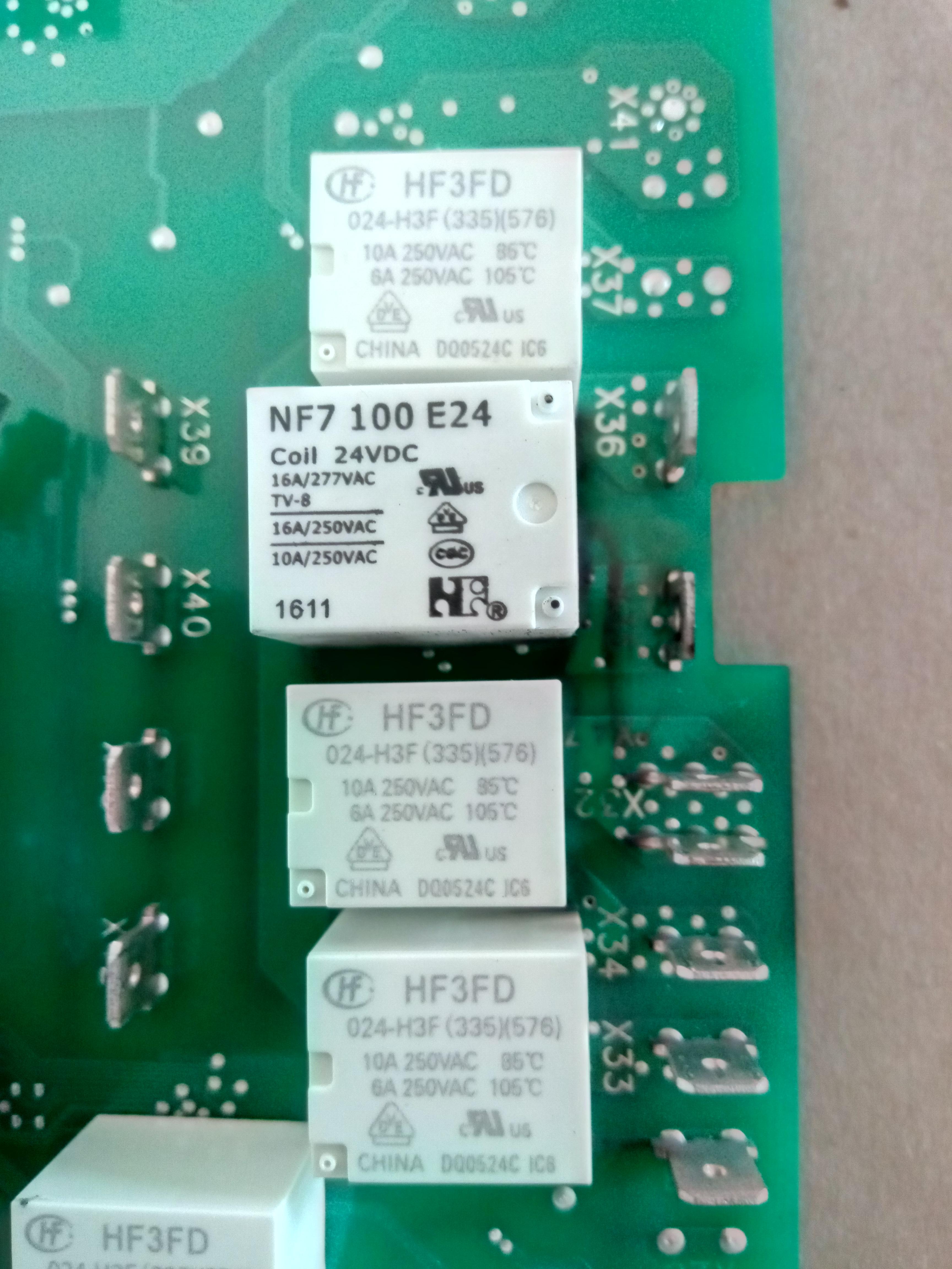

Yes, vertically mounted, and can only assume when it failed there was as you suggest, a flame. None of the wires attached to the various pins had any damage (other than a couple with a little soot on the connector). What is the likelihood of it happening again - not sure. Given the relay that failed only costs a few pounds, it may very well. Hopefully with a completely new control module/ board the risk of repeat is less. In terms of fire, given there would appear to have been a small flame, I'm not sure what to think. The control board itself is.mounted on the back of the main body of the oven, and then covered by a metal panel, so in effect sits in a metal box. -

Yes, replaced the board. Marital harmony demanded a prompt resolution. My question was really whether it was worth having a go at repair of the damaged board. It's 30+ years since I did any meaningful electronics so I'm a bit rusty. -

Phoned up BSH to request a remote diagnostic, to be told, we don't do that (even though their website says they do). However, the advice I did get based on description of fault was that it was either the element or control module. Worth throwing the dice on a new element first, being considerably less expensive than the control module? -

I had it open today swapping out the PTC sensor and temperature limiter, so I don't have an issue opening it up. It's a relatively quick job to get to the module so easy enough to try (can't help but think of the 2x2 shaped dent in the solenoid of my first car which required the occasional 'tap') Phoned Siemens today, and should be able to get a remote diagnostic check tomorrow as its WiFi enabled. -

Just tested the top/bottom heating function - as well as the top element, the main element came on, red hot, pushing well beyond set temperature. Control module are available, sadly they cost £166 -
I currently have the following oven: Siemens HB676GBS6B/13. It is five years old. Last week, it overheated, an alarm message eventually showing saying the appliance was too hot. The main 2200W element was glowing red hot. The temperature control showed the oven heating, but for some reason failed to maintain the set temperature, i.e. the element stayed on and kept heating the oven. I've just replaced the PTC sensor, and temperature limiter, but on testing, the problem remains - the oven is not regulating temperature (main element). Looking at the spare parts exploded view: https://www.siemens-home.bsh-group.com/uk/supportdetail/product/HB676GBS6B/13#/Tabs=section-spareparts/Togglebox=tb0420/ The only other things that I can think of changing are the element itself, and the control module. Given the element is working, and in of itself, appears dumb / nothing more than an element, the control module (£166) seems the only realistic answer. I will be testing whether the oven functions normally just using top and bottom element heating later today (once it has cooled down from the earlier test). Any thoughts or other suggestions.
