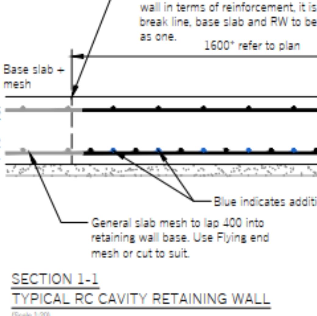

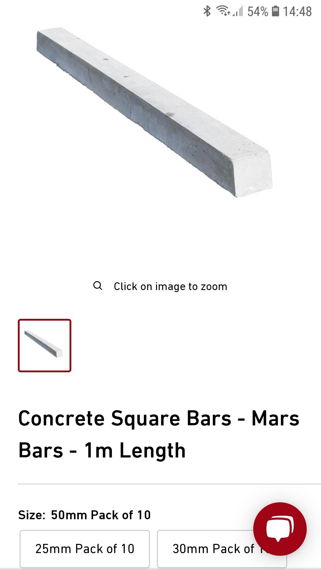

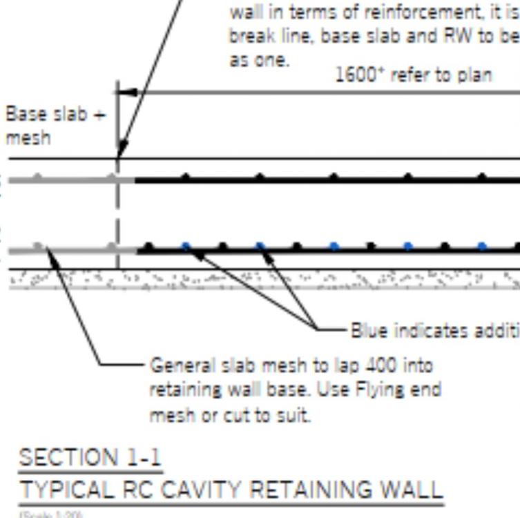

Definitely need to take the corners of at least the top sheet of A393 but more than likely the top 2 your detail even mentions that fact.just lay them as is and you'll know exactly what you need to cut then and it's easy to cut in place Yeah the MARS bars are all I'd use for bottom layer they are the right tool for the job, you can break them up by hand as required too.
Id check all 4 exterior walls, no point in guessing now and it'll not take long to fig a few extra holes but it could be costly to find out something is no good mid way through an extension and it'll be the SE to inspect as he's responsible for design.
What size is the mesh? At the corners you might need to Nick the corners of the top 2 of the 4 overlapping sheets. For the spacers on the bottom I'd use mars bars far easier and better the others will just overturn
Tony is correct with the product but you won't want 200mm ones as with 50mm cover top and bottom a 200mm spacer and the depth of 2 layers of mesh and the overlaps you'd be out through the top of the concrete. 150mm spacers would be loads for that. And even then use flying end mesh to avoid issues at corners with 4 way overlaps.
