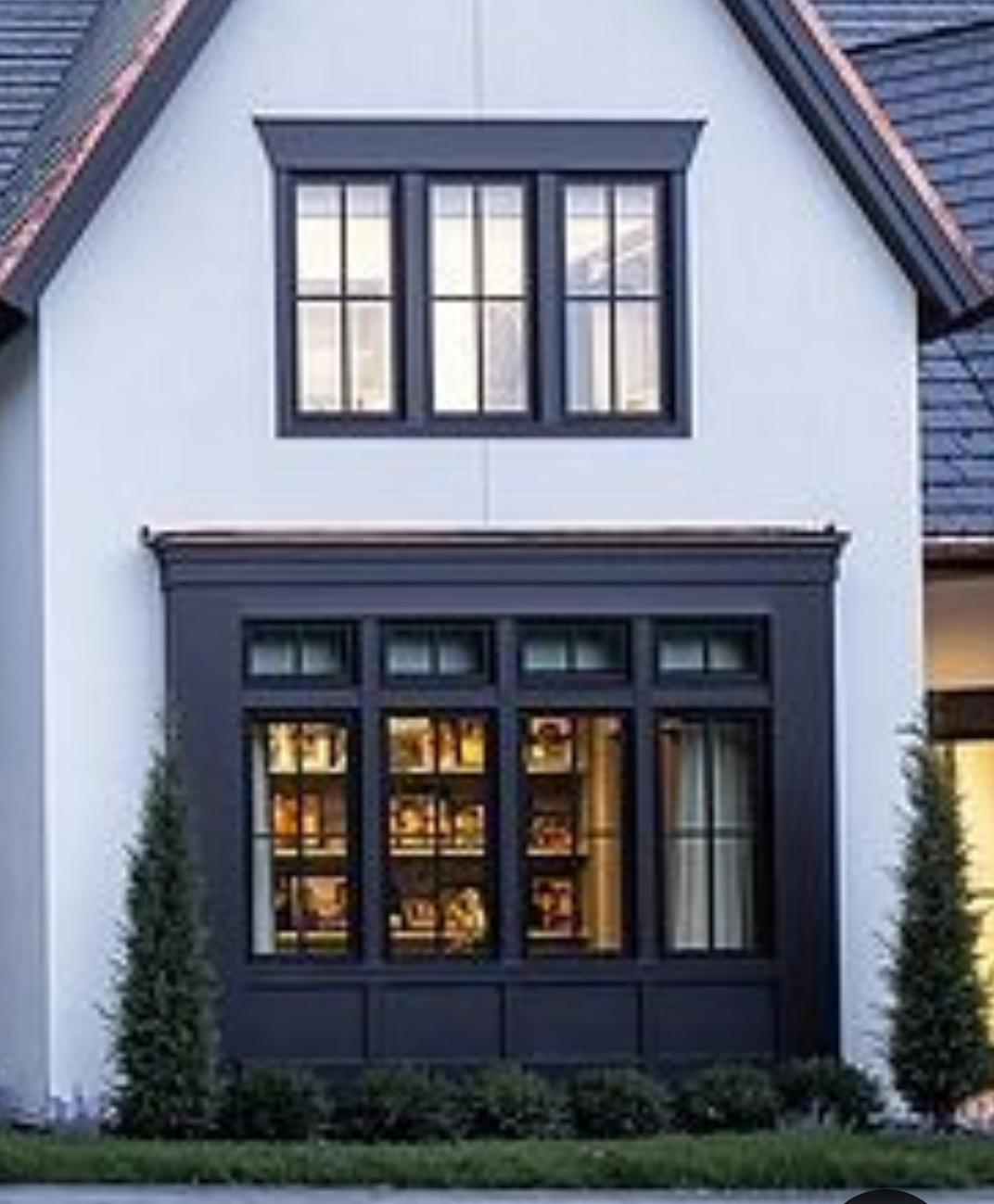

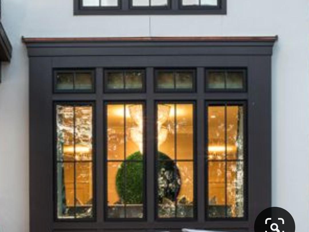

How to achieve this window style and external frame
Ronan 1 replied to Ronan 1's topic in Windows & Glazing
Hi Russle the thick million would do the trick for the glazing area and immediate surround it's the acieveing the rest of the protruding surround around the window and matching as seamlessly as possible into the mullions. Hope that make sense. -
Fingers crossed, Its the latest point I'm fixating on and waking up in the middle of the night thinking about ? -
Yep looks like a good option I had been thinking of building a block on flat in the area of the surround to give me a 125mm but out then maybe some frame narrow frame to that and alluminium ? But GRP might be a lot easier. Just need to figure out window placement as they seem to be almost flush with the surround in that. -
Hi Joe do you have a link to them or do they have a website, problem is I'm in northern Ireland would they cover there? -
Gents hoping someone here can help, i really want pretty much exactly what the picture below shows for around 3 wimdows but i just cant land on the construction methodology and materials should be and neither can my architectual tech. This style seems fairly popular on Pinterest in American homes but I can find this anywhere in Ireland or the UK. I suspect is timber built frame but I'd really prefer to minimise timber construction onto my Block and block build but if I have to I have to. Also wondering about window type and placement with the construction Any thoughts appreciated.
