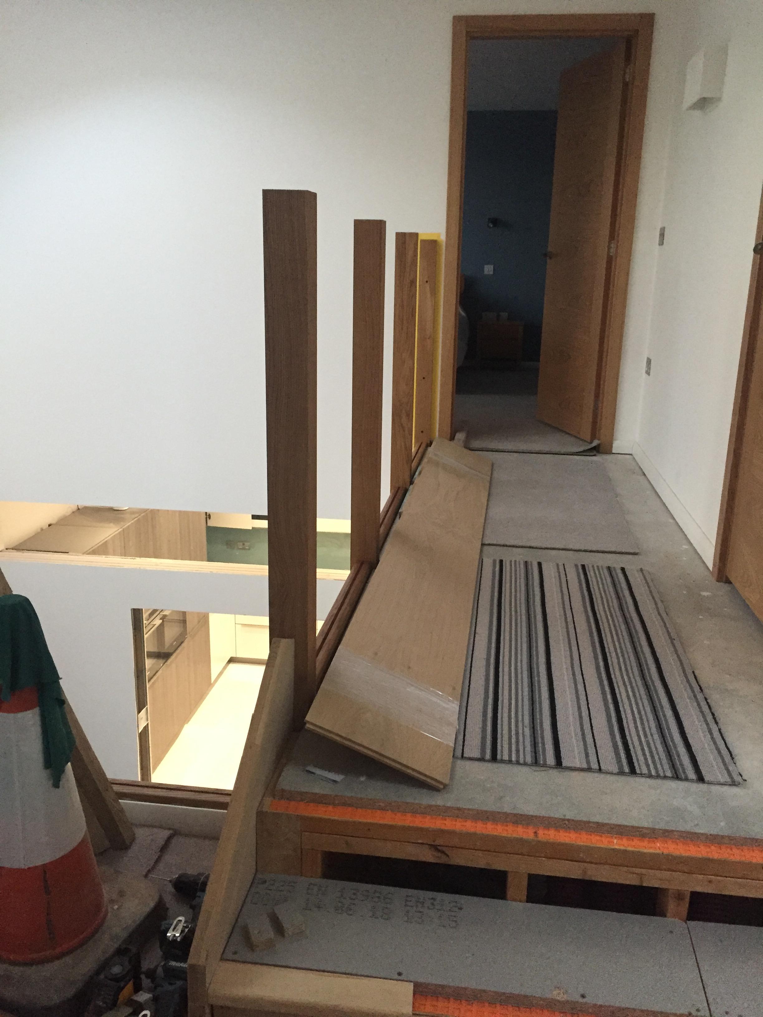

  19. We have 900mm on the stairs landing. This is governed by the newel posts supplied. It’s overlooking the stairs. but for the galleried landing we are going for 1100mm to be sure. Work in progress.....
  20. Mmm. Interesting. Thank you for noting this. Think we could have an issue with the “landing” definition. Might do 1.1 just to be sure. Supplied newels (Stairbox) are plenty long enough......

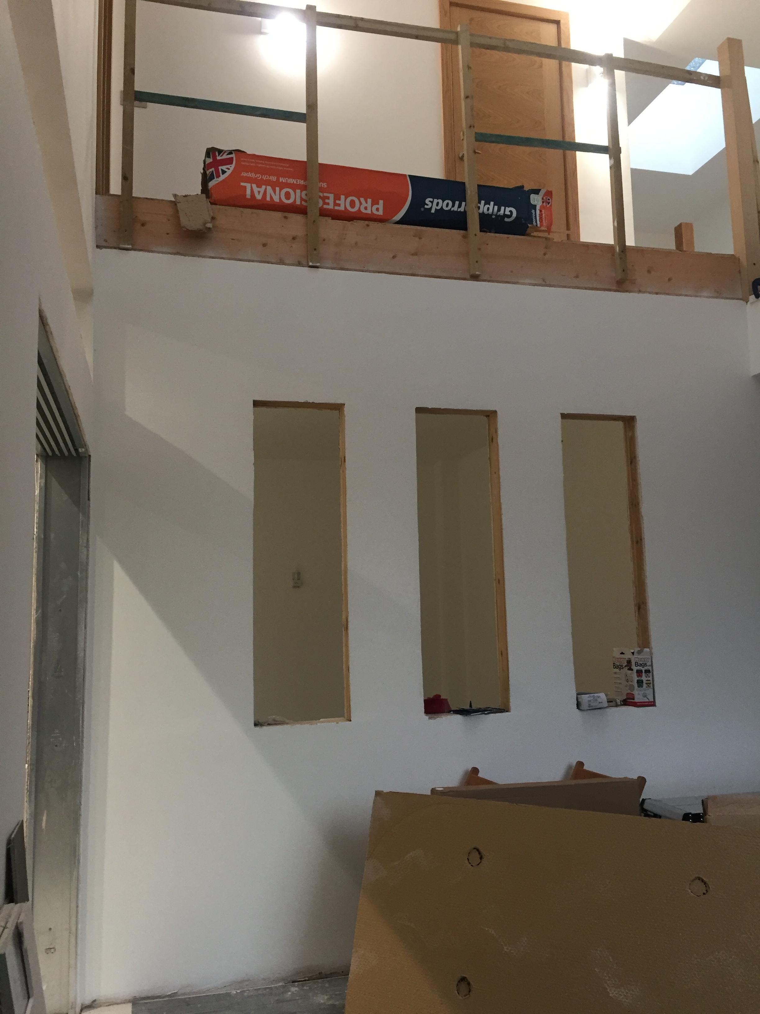

  21. Ours is over the entrance hall - quite a fall. Kids are teenagers. But that’s not an argument for making it lower!! No access issues as it’s along a straight section to a bedroom. Will try at 1m and see what it looks like.....
  22. We are installing the newel posts for our landing balustrade. Need to cut them down to level. We see that building regs require the handrail at a minimum 900mm above the floor. But commercial premises require 1100mm. We are interested in knowing if anyone has installed banister / balustrades (on landings, not on stairs) higher than 900mm in a residential setting. Any views on optimum height? Thanks
