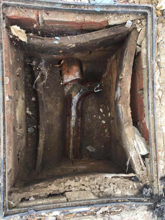

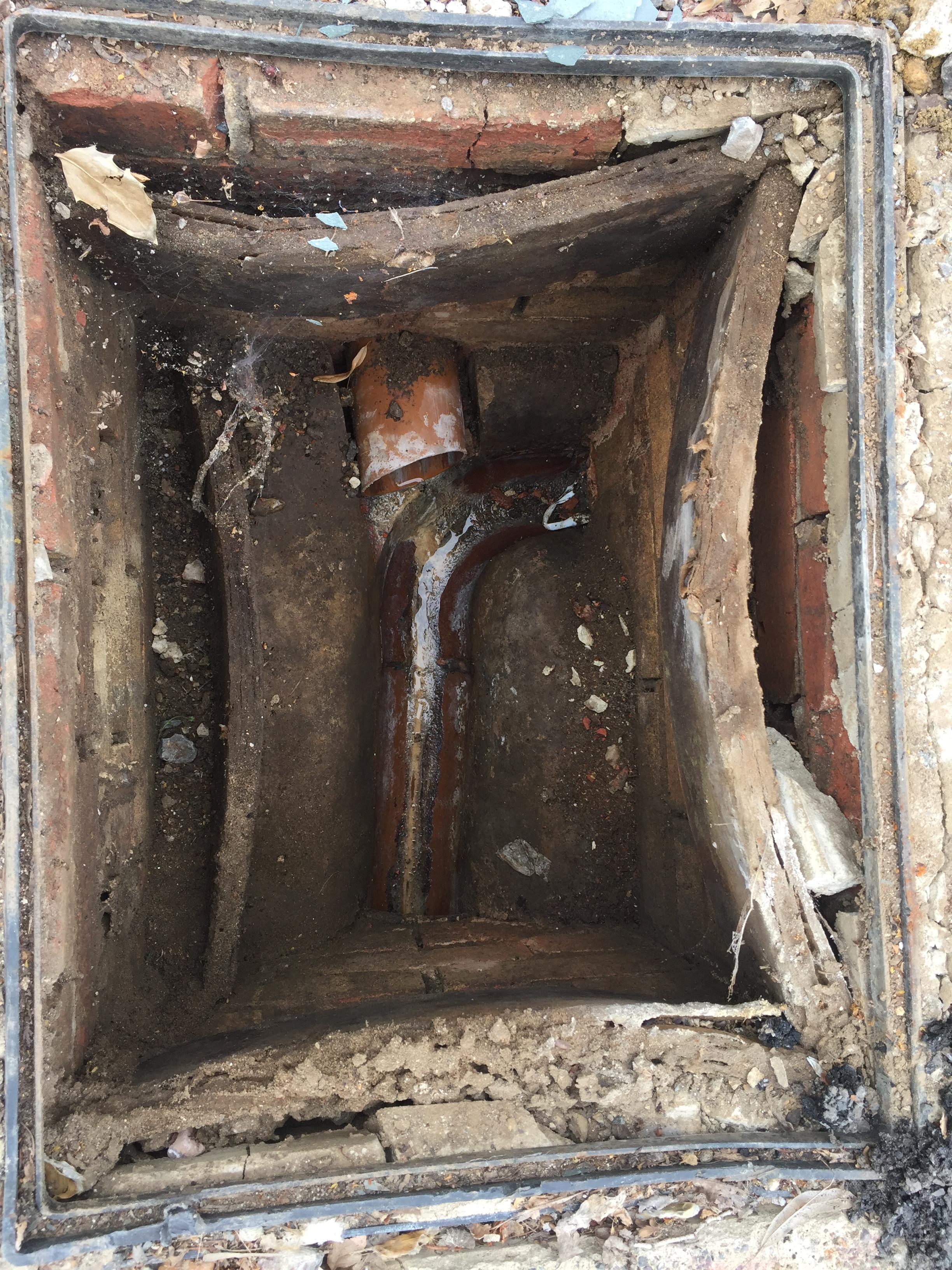

I might be misunderstanding the regs here but this manhole connects to the sewer. We are the first house on it but I guess others connect to it further down. Looks like the min size for a manhole serving a sewer is 1200 diameter or 1200 x 675 ( note 7, table 12, H1Bldg regs). Can I have an inspection chamber (a bit smaller) where I connect to the sewer? If not, does a plastic manhole of the required dimension exist?
We were going to replace the lid obviously but thanks for the brutal honesty. I knew it looked a bit tired but didn’t know how easy it would be to replace. A plastic one? Will check it out.

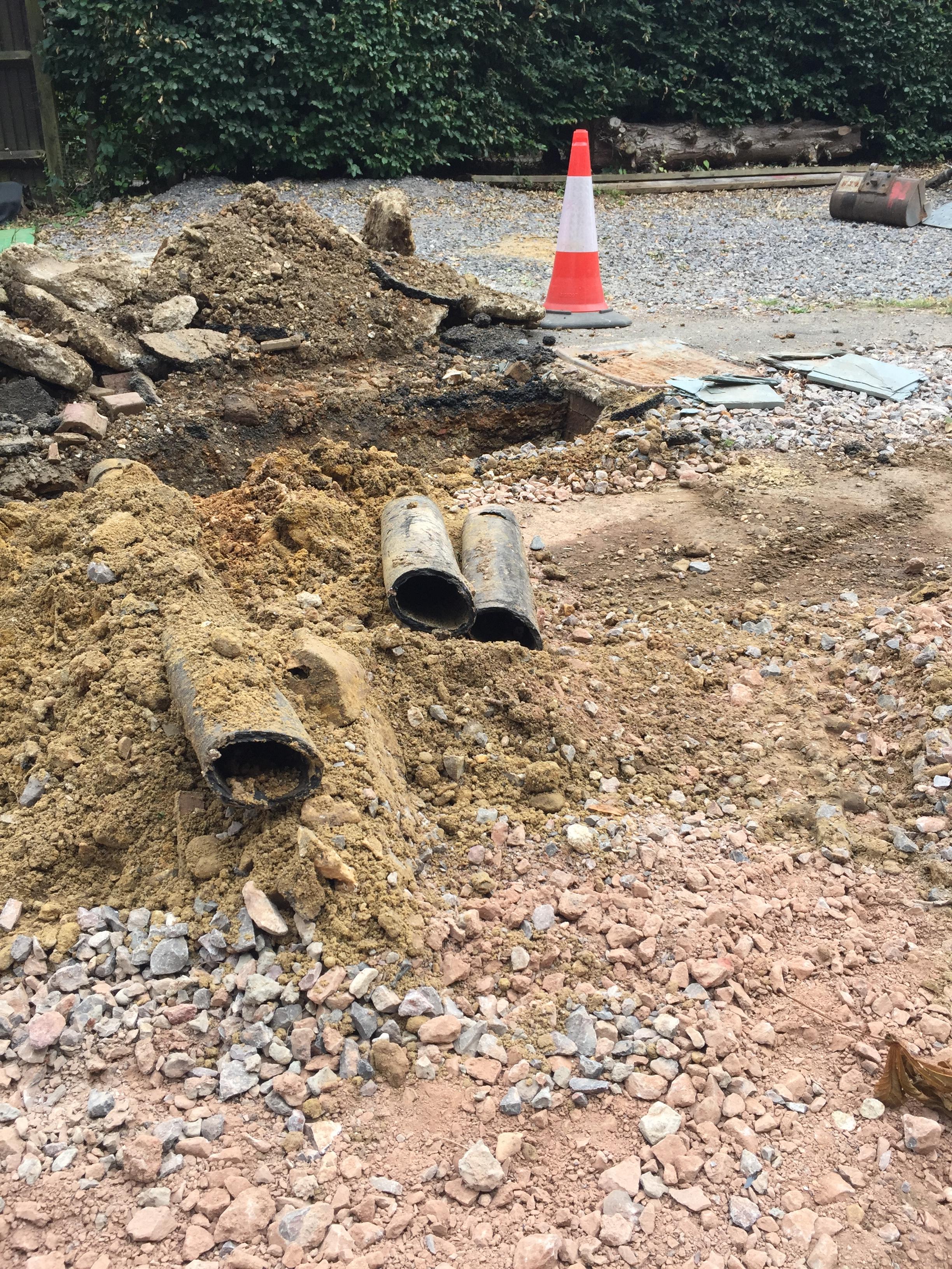

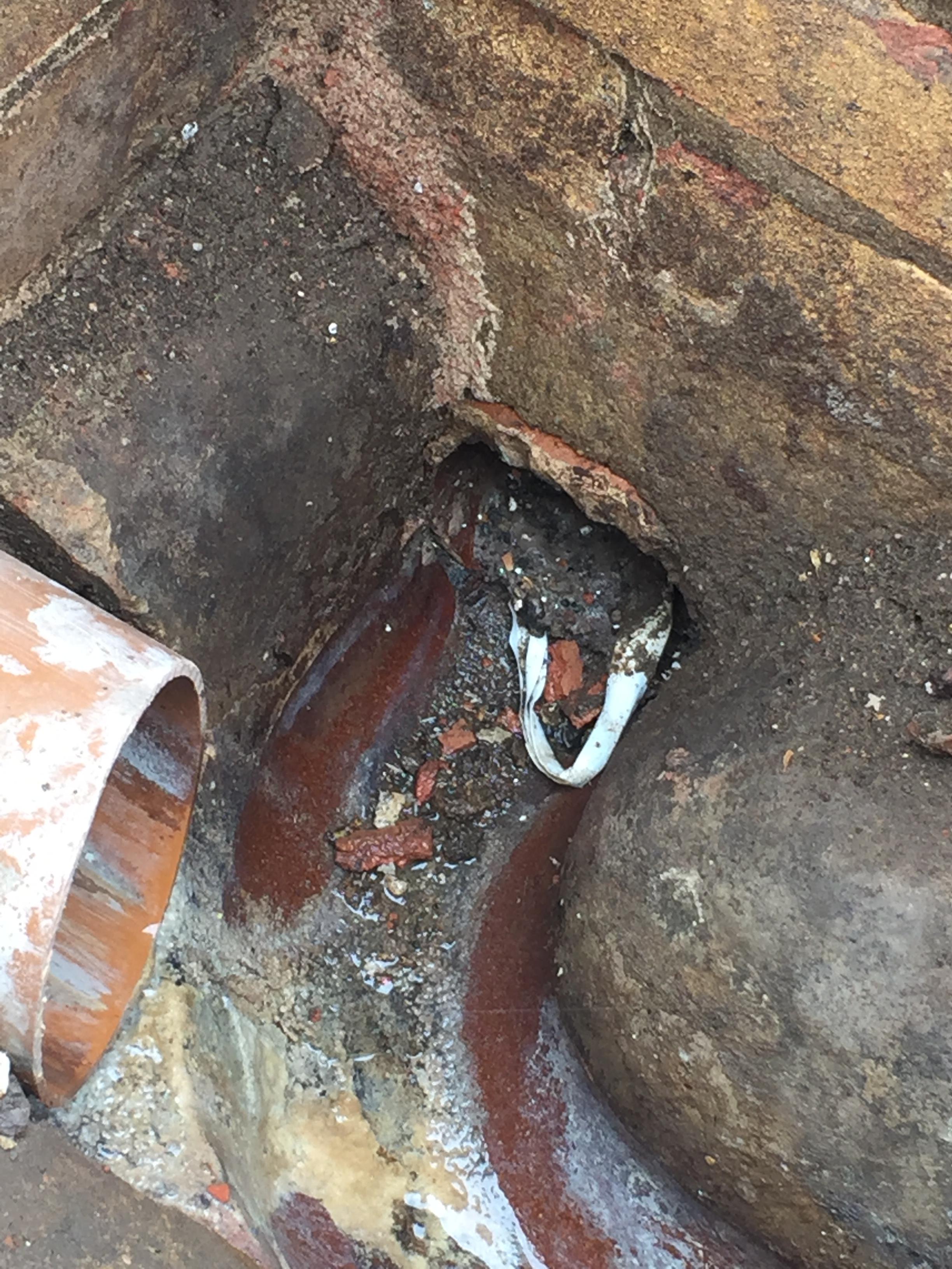

Pipe at top of photo Is from caravan and only temporary. Pipe on right from above angle is the one we are talking about (white plastic bag handle sticking out of it to pull out the stuff we stuffed in to block it up).
So pull everything out at the manhole then? We are convinced about replacing the pipe, just not sure how to go about the manhole connection bit. Chip away at all the cement around the existing to get it out and then re-cement the plastic one in? Followed by the proper benching etc as the existing may get damaged I guess? A relatively “simple” job just got a bit trickier ?
Thank you @JSHarris and @PeterW. Now going to dig it back to the manhole and see where it joins into clay as it is a clay pipe into the manhole.

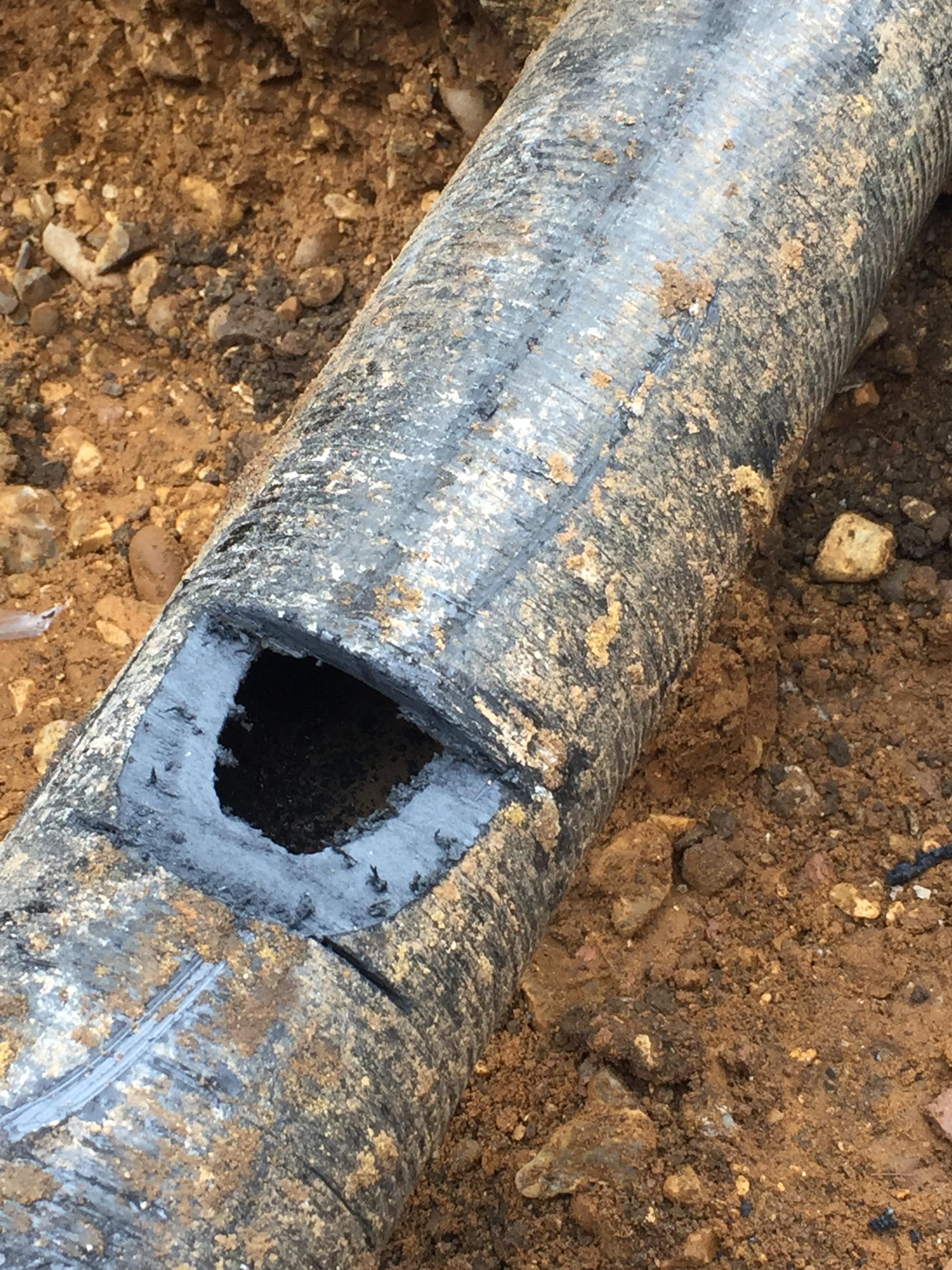

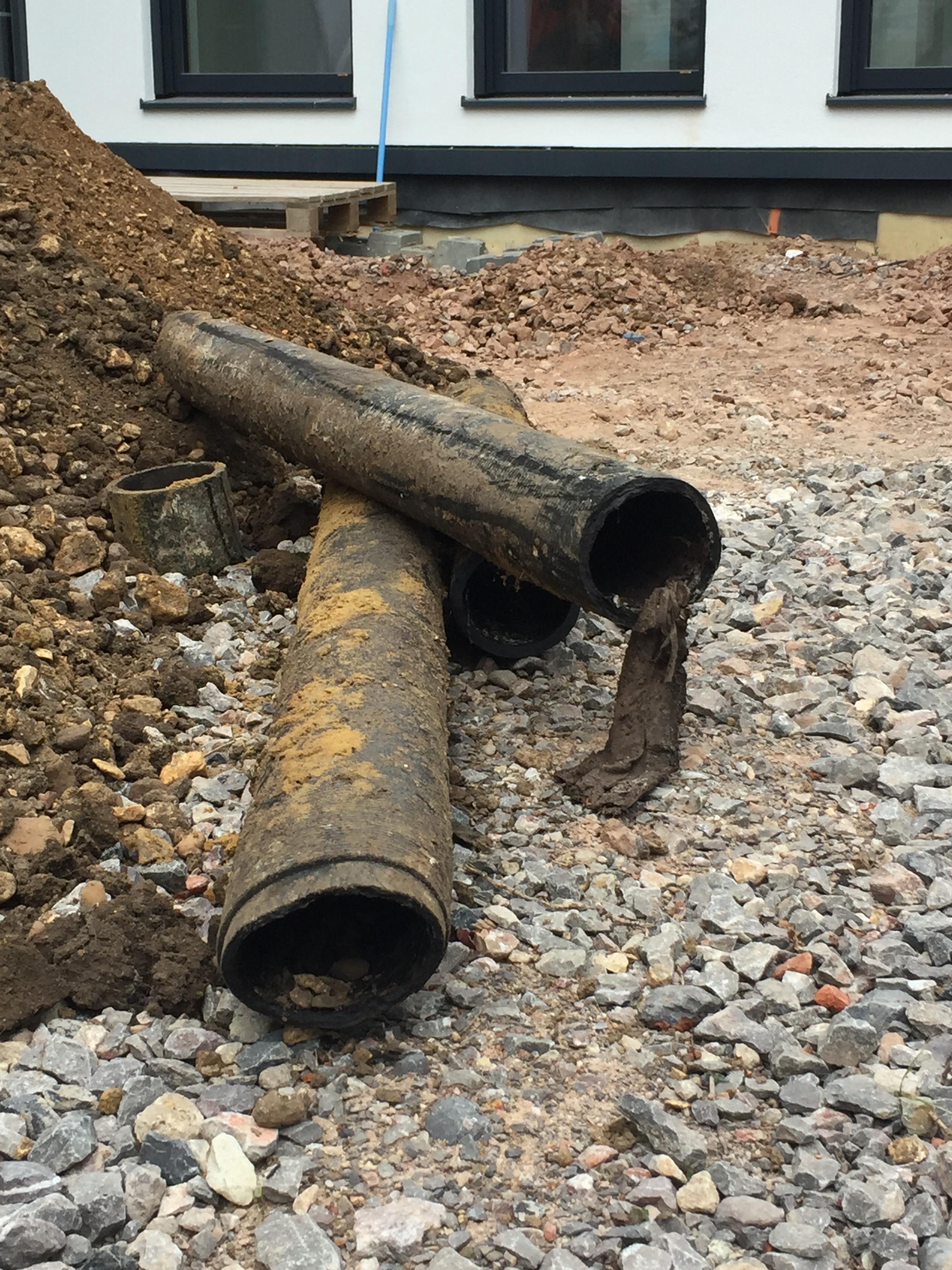

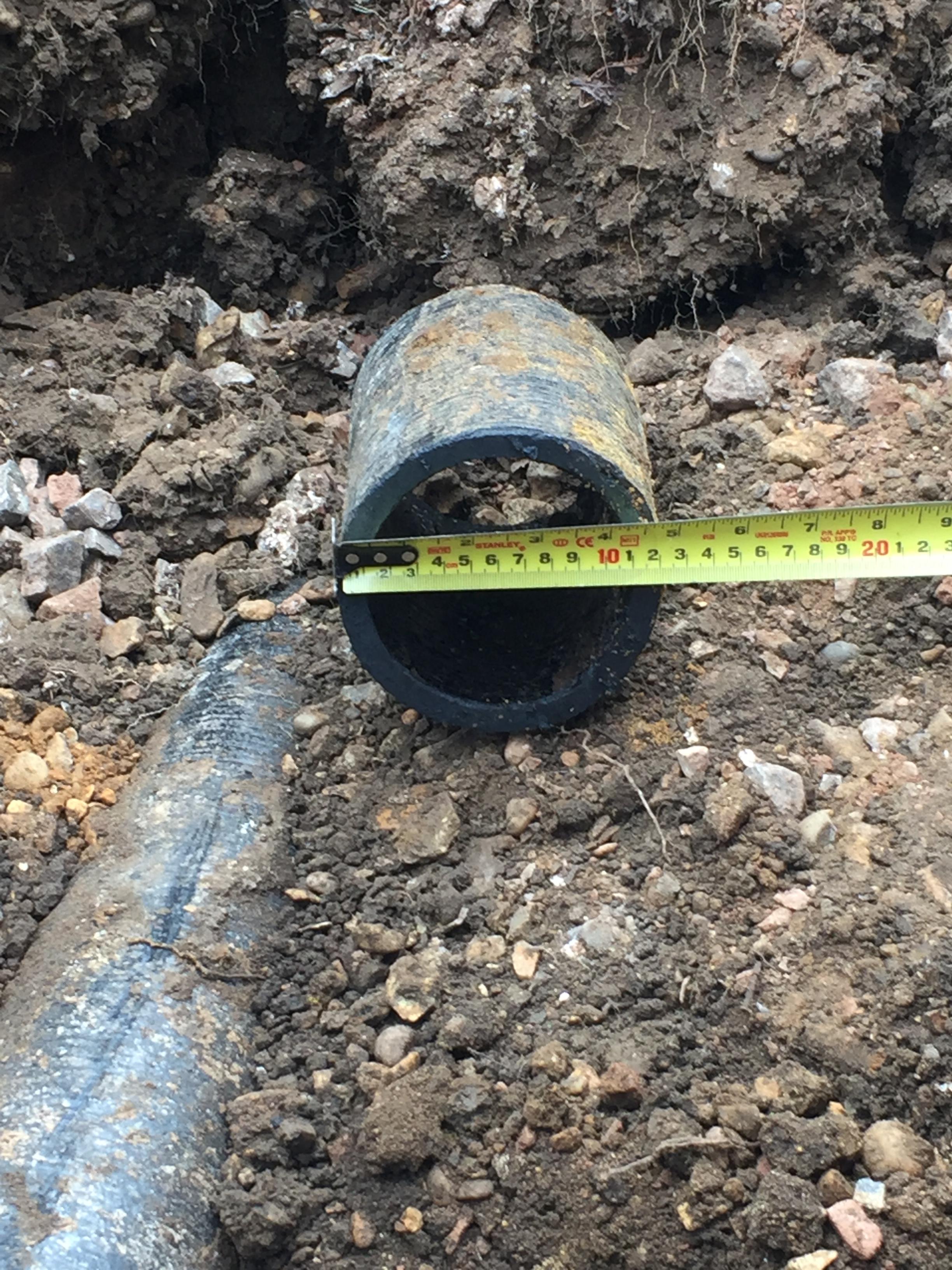

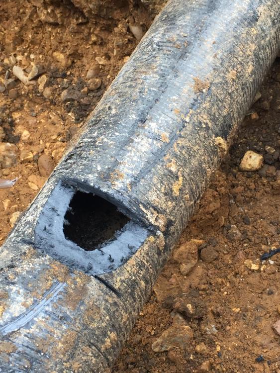

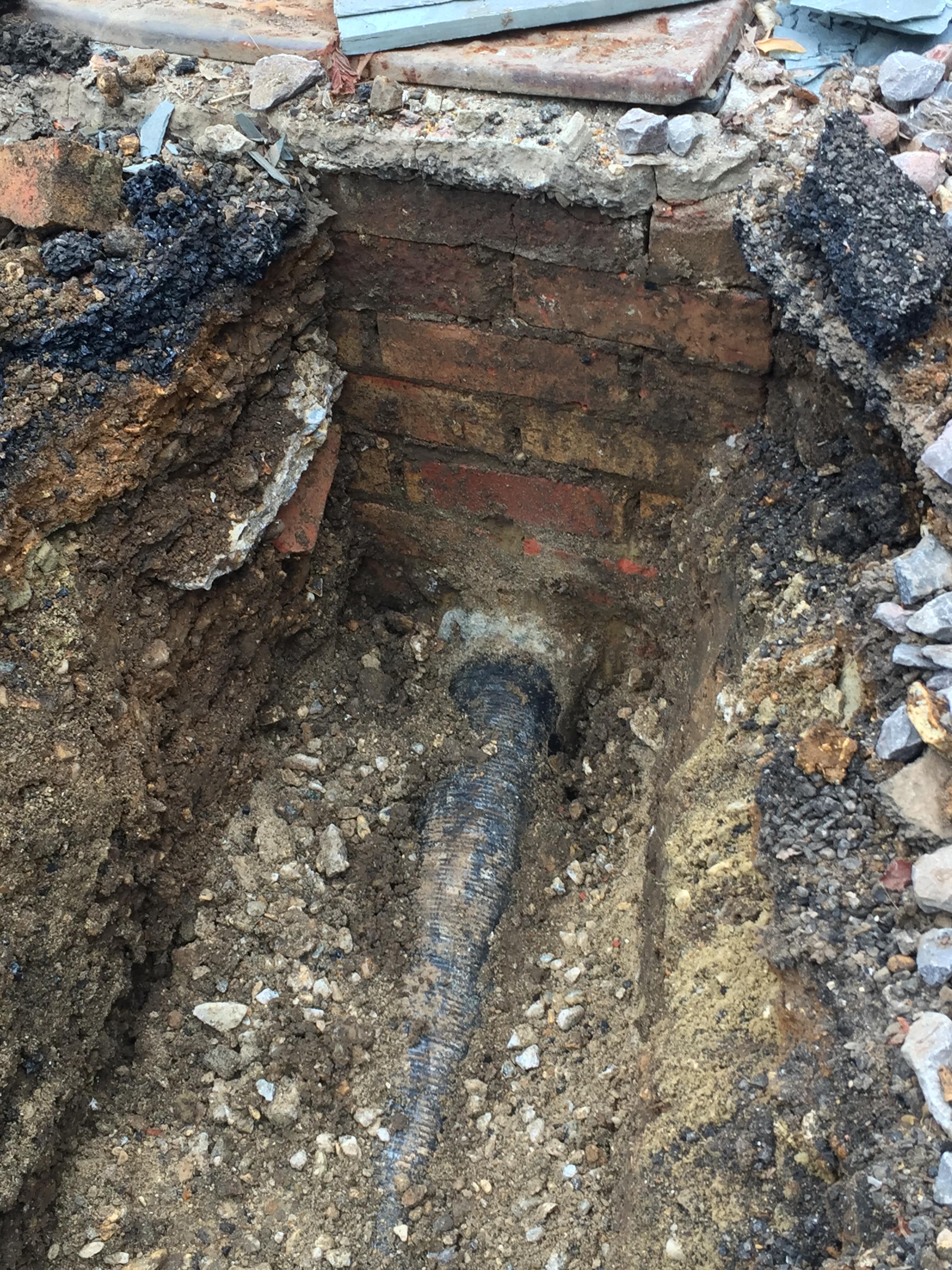

Been digging to find drainage from old bungalow so can connect into that rather than breaking another pipe into the manhole. Found this sewage pipe? What is it? Can we connect a modern plastic pipe 110 diameter to it? cut through it with a reciprocating saw. Slightly flexible and smells like bitumen? outer diameter 125mm
