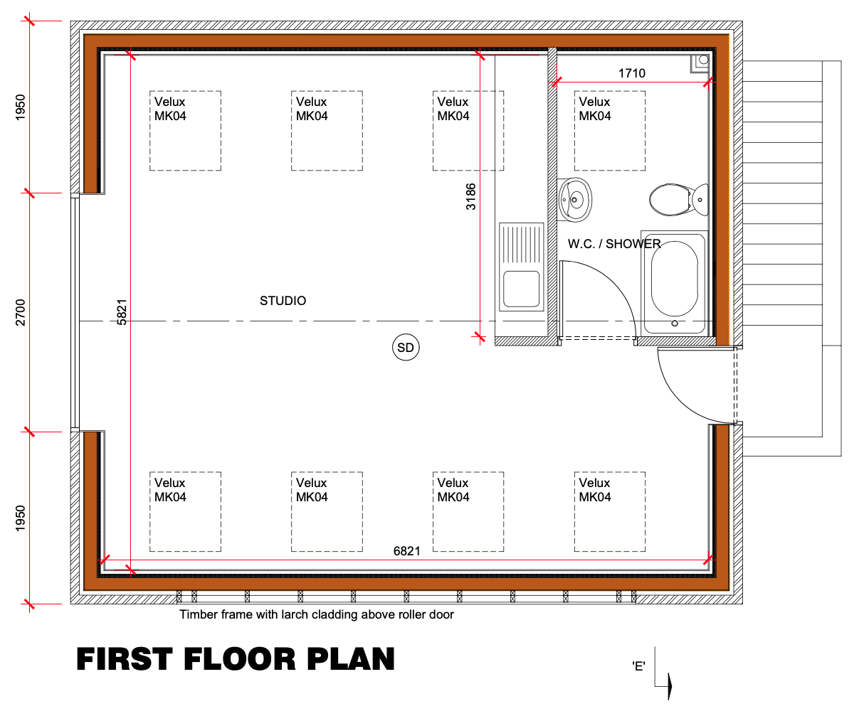

Our garage has a room above which I will use as an office. It has a bathroom with shower and a small 'kitchen' area. Our architect marked it as 'Studio' on the plans and we didn't have any issues with it through planning. Not sure if we just got lucky as I know of others nearby who have had their ambitions for over-garage accommodation neutered by planning. These are the plans which were approved, if they help at all.
