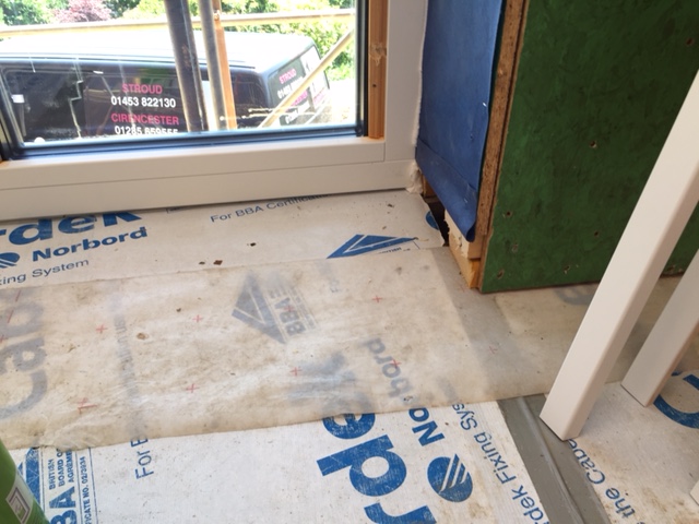

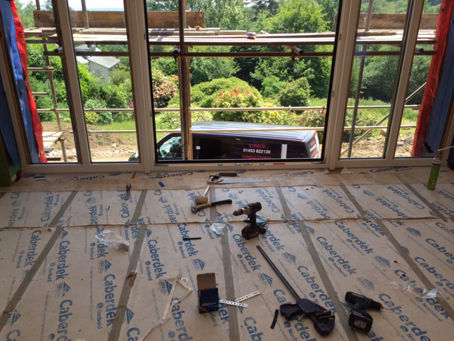

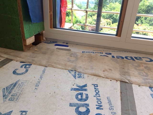

  3. Well I've been to site. I didn't have time today to set up the laser but frankly you don't need it to see that the window fitters are doing the best they can to fit windows into holes that are simply not square. The problem exists on the ground floor where the floor slopes left to right by about 15-20mm across 4m. Unfortunately upstairs its even worse with the frame being out of square by a good 25-30mm across the 4m span. With Internorm only allowing a tolerance of 20mm this is of course not making their job simple. Its not easy to photograph (as its so bright outside compared to in) but these pics of upstairs probably demonstrate the issue quite well: Left hand side. Pretty much tight to the floor: Right hand side. 25-30mm gap (its a steady fall across the span: The same is true of downstairs but of course thats a bit more tricky as its a concrete slab. The window fitters view is the whole house is "on the cock" left to right as they're also having to pack the windows. I'm pretty certain the issues in the timber frame can be rectified with some packed battens etc to square up the openings. The doors are sat on the floor deck so that's going to be a pretty big job to put right. As for the concrete base well there is going to be a large amount of levelling and probably a lot more than self levelling compound could cope with. And for clarity: I'm officially having a bad day!
