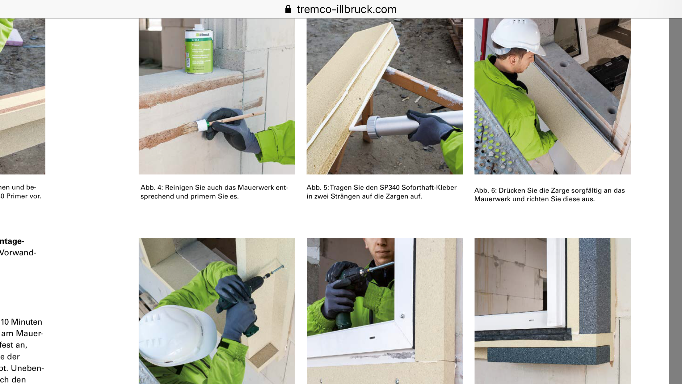

Illbruck ME500e with a butyl adhesive will do the job, I would also use Illbruck TP600 around the frame of the window. I would have used llbruck PR007 for the window installation. Looking good though, good job. -
