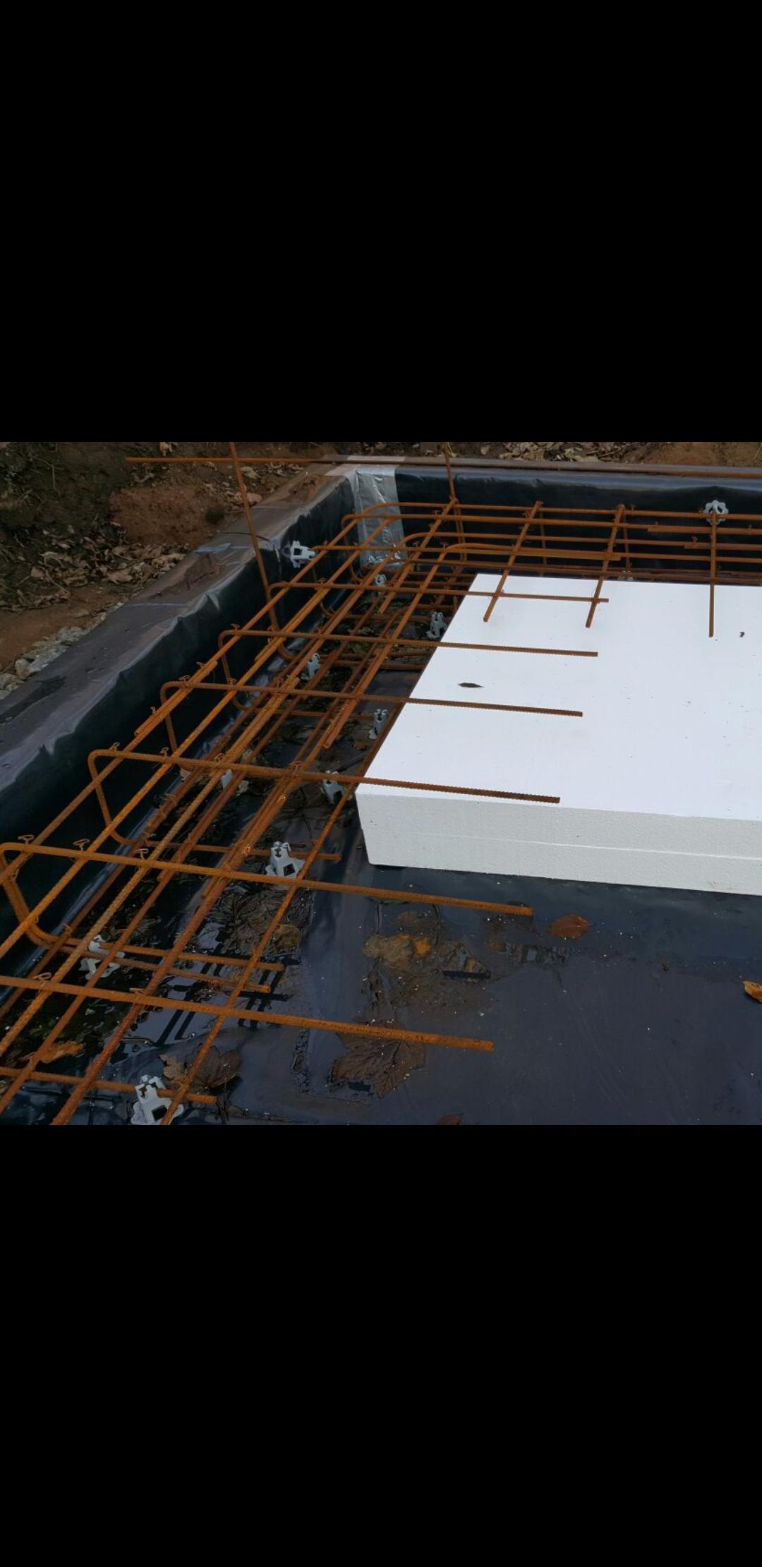

  20. This is what I was meaning, we had more rebar in our spec. I think the triangle deck chairs is a easier solution.
  21. Good timing, I will be playing with the router tomorrow for bevelling a edge (first time) on a oak worktop. Only used the big router for cutting out vents in the soffits up to now.... will be a interesting day!
  22. One solution is get some rebar bent into a u shape and tie it the lower a393 mesh below.
