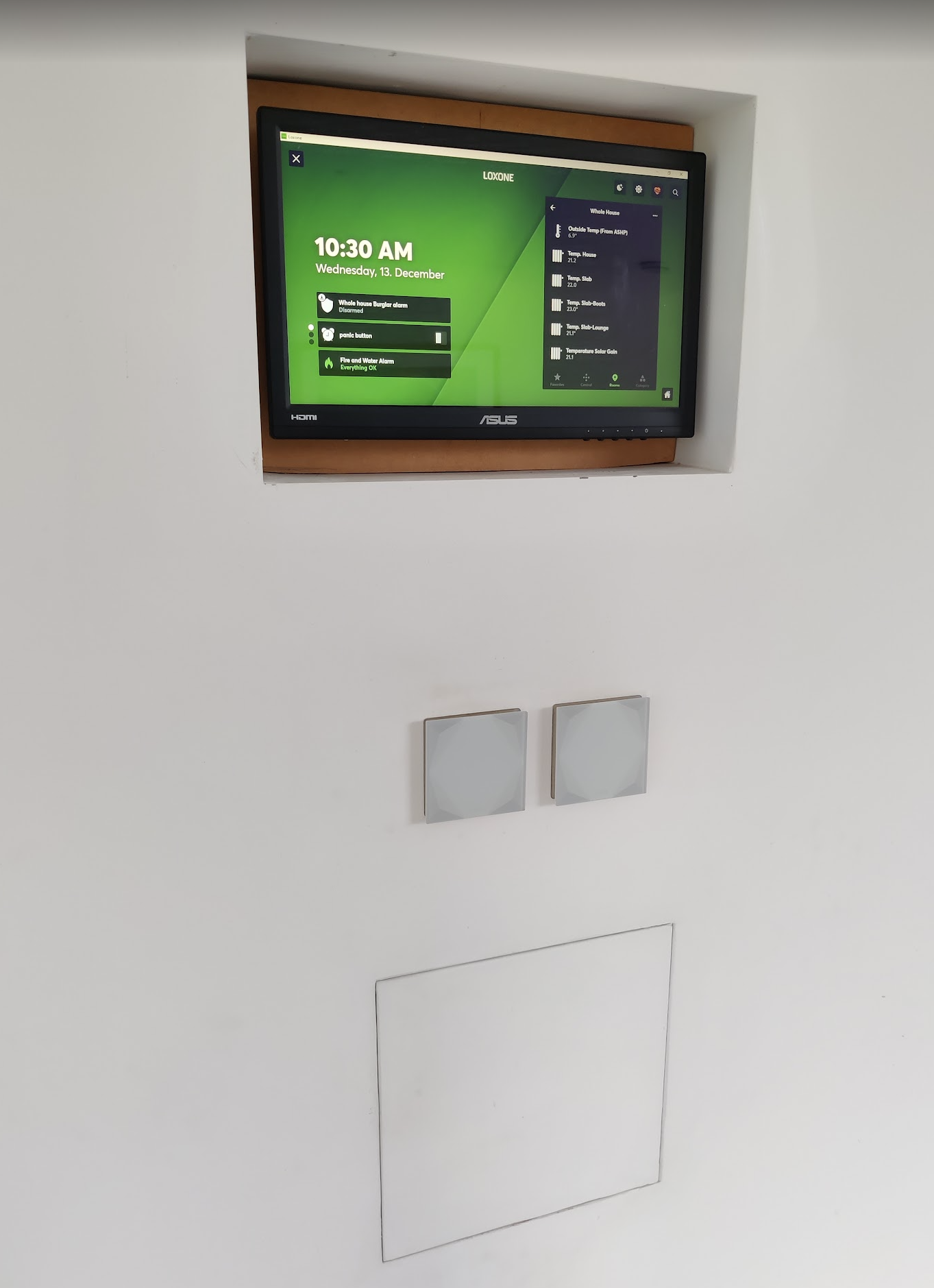

Slightly different approach for me. I hung a touchscreen on its Vesa mount, in a recess and powered it with a Windows NUC behind the flush door below the Touch tree "switches" I use it a lot less than expected, as Loxone runs itself, so the screen is usually showing CCTV or being used to cast music etc. -

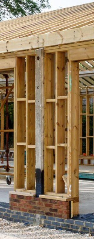

The example you linked to shows one of the compromises you'll need consider. The depth of the column is, on this build, greater than the thickness of the wall, so the plasterboard adjacent to the column has no insulation behind it and in January will be sitting a few mm off a concrete column that will be close to 0°C. And those exposed roof portals are attached to that column drawing out the heat from inside the building and possibly compensating. I do also like the industrial look this gives, but for me I'd want bring the portal frame within the thermal envelope and get a reasonable thickness of insulation around the outside. I'd then just live with the cold bridge from the base of the column to its concrete pad, as long as I kept warm moist air away from the lower parts of the column. When following PH principles, once you've added sufficient insulation and got the air tightness within target, the cold bridges are where you will leak your energy. Like for like, it has to be cheaper. You could perhaps spend some of the money you save on a Glulam portal frame to give a similar (but less industrial) internal appearance. ...and park them inside the thermal envelope.

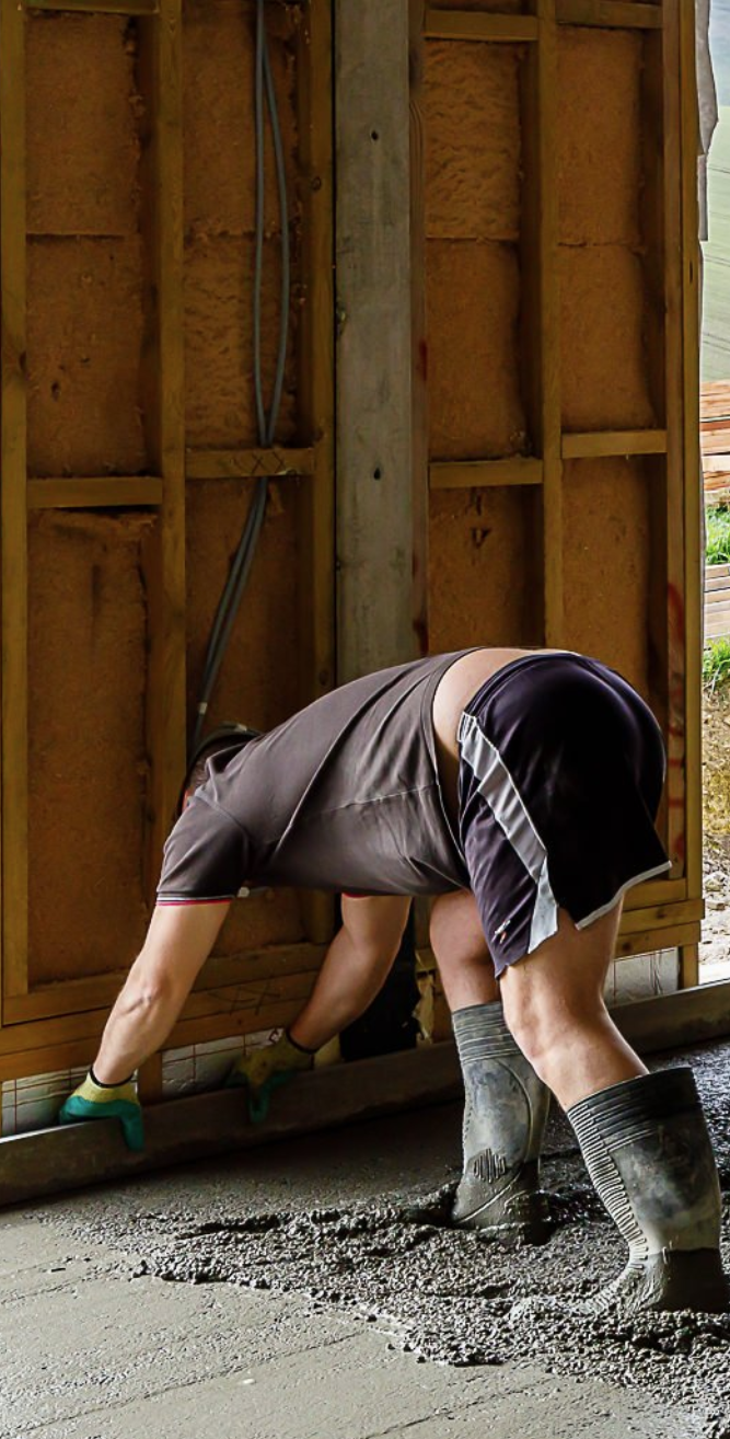

That seems completely over-Engineered. I know nothing of you build, but assuming it's not more than 2 storey, and you have reasonable ground conditions (>70 kPa/m² bearing capacity), then a very simple 100mm RC Raft with a 300mm Ring Beam should be achievable. Advanced Foundation Technology's standard Eco Raft is as per below and will get you close to PassivHaus performance. Slightly more complicated is their Eco Raft Double L, which is PassivHaus level performance, and can take a heavier super-structure. It would cost you nothing to get a ball-park cost: https://www.advancedfoundationtechnologylimited.co.uk/quick-quote-form/
