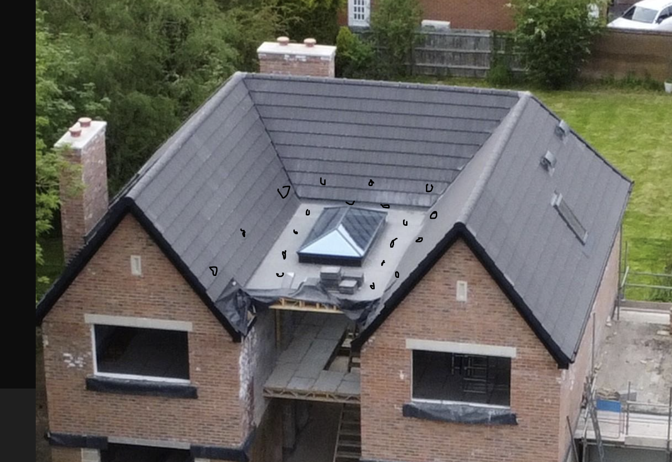

  1. They have done a nice job off the edpm in fairness it looks smart. How far under the tiles have they lapped it up and did they osb under the tiles ? I think abutment vent's will be hard to get working right as they will push the bottom tiles up. Easiest and cheapest is to use some mushroom vents. I'd do 4 along either side of the lantern and 2 behind it They really easy to flash in with the edpm tape. Lastly i also think you need more airflow in the pitched roof, assuming its not a warm roof. There doesn't appear to be any eaves vents where the 3 faces join the flat roof. You need air to flow up and over to take out the moisture that will inevitably collect in there when it gets cold. I would put in 9ish tile vents while you have niece easy access, they are cheap and you will have no worries come the winter. https://www.roofingsuperstore.co.uk/browse/ventilation/flat-roof-vents-extraction/flat-roof-ventilation.html

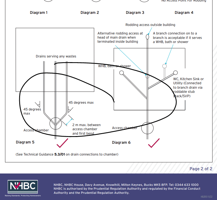

  6. all the BCO I've ever had over last 10 years accept NHBC specs without question as the industry standard. maybe you know different... design stage ? not sure what you on about, in the real world BCO regs plans are produced and built too. Still waiting for you to provide evidence of where NHBC specs are wrong. Be good to advise them you know better than them.

  8. this. you have a cold roof with no ventilation. will rot out in no time unless its addressed. Photo of the outside ? eaves and abutment vents, min 50mm gap maintained to allow an airflow etc The lantern upstand needs the same amount of U value insulation as the rest but doesn't look like they have been designed deep enough (they never are). Best stop and correct it now rather than have to rip it all out when the mould patches start appearing.

  10. err no. BCO applies NHBC rules, never seen them go against NHBC ever. Have you ?

  15. just to correct you, 45 degree is allowed for by NHBC. Not sure why you getting so prim about it.

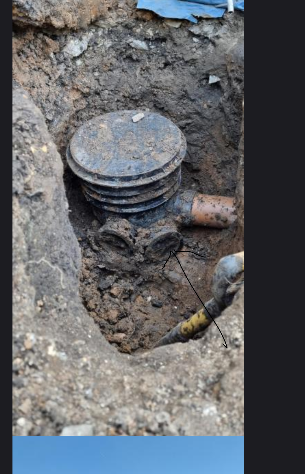

  16. technically chambers are needed at changes in direction. could be installed correctly with a couple 45degree elbows on the in and out. main run is lower for a reason no sure what you dont understand about that.

  20. may get away with it not blocking over time if a bath/shower/mwashing machine is connected but if just a bog the turds will drop in the middle back and wont get washed away. BCO should fail it....
  21. 30k! What's it made out of ?
  22. concrete it in place. you can use bends to drop into it if you really have too. It's currently connected up incorrectly as well, the main flow needs to connect to the middle (middle is lower)not the sides, will then need a 45 i suspect to connect the outlet.
