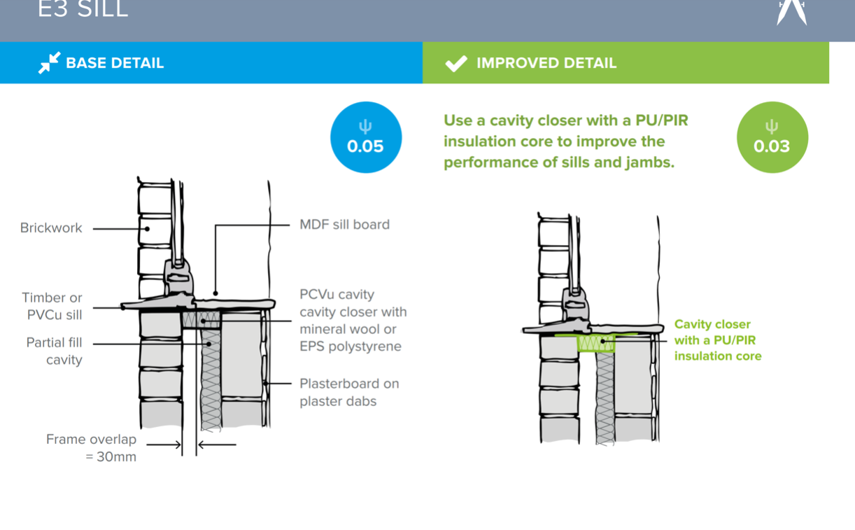

  5. yes they are subframes/cavity closers. I used them on last build. They are tied into the brick course and come pre-braced square. You can order the windows while at DPC level without an issue.

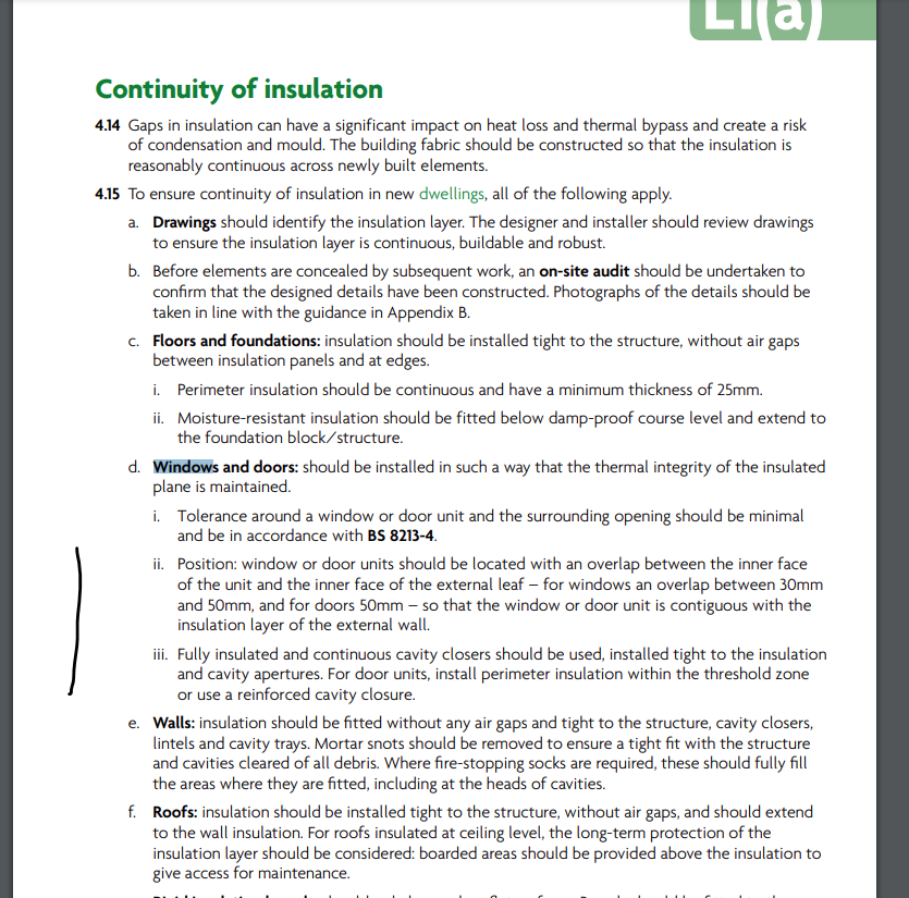

  9. applies to both, you get a poorer U value target for your windows to meet. Do you know what yours are ?

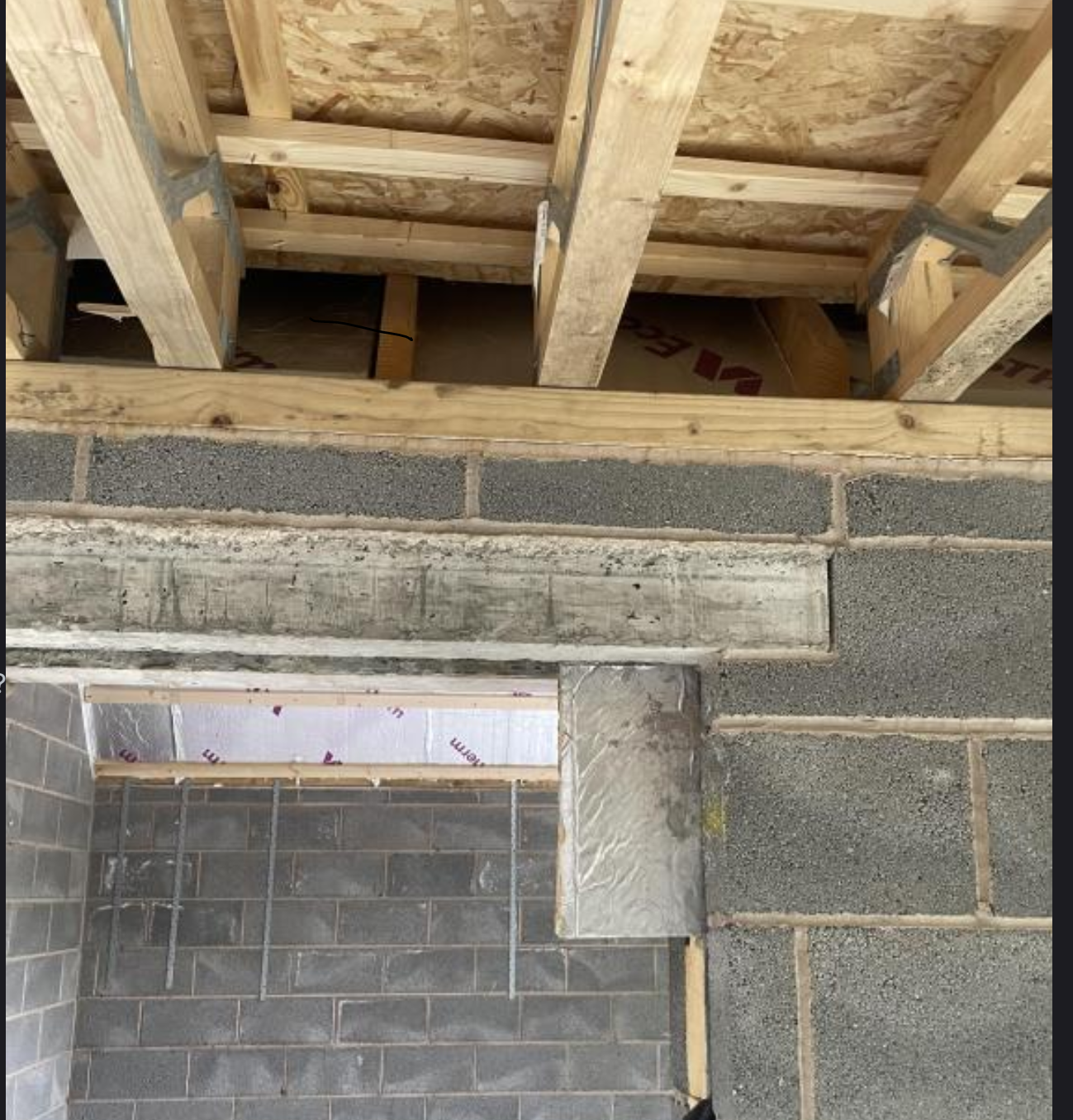

  10. the cavity under the door looks to be filled with conc, it needs some insulation in there to stop thermal bridging and damp.
  11. its Part L of building regs. also specifies the minimum U values for windows (not just the glass), do you know what your are ?

  14. more incorrectly installed windows failing building regs. They need to be set back into the cavity so 70% of the frame is overlapping the insulation. Straps to fit. Not too late!
  15. Just a heads up the windows would fail building regs as they have been installed. They are not set back 70% into the cavity insulation. Not too late to get them fitted correctly, use straps on the frames and fix them to internal blockwork.
