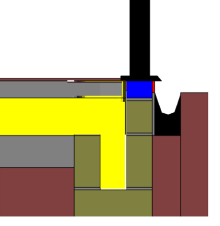

Most cost effective way to get to passive standard using block
Dave Jones replied to CalvinHobbes's topic in Heat Insulation
joes buildup fails the new SAP due to cold bridging, you need this buildup using marmox blocks ideally. This shows the external door junction -
