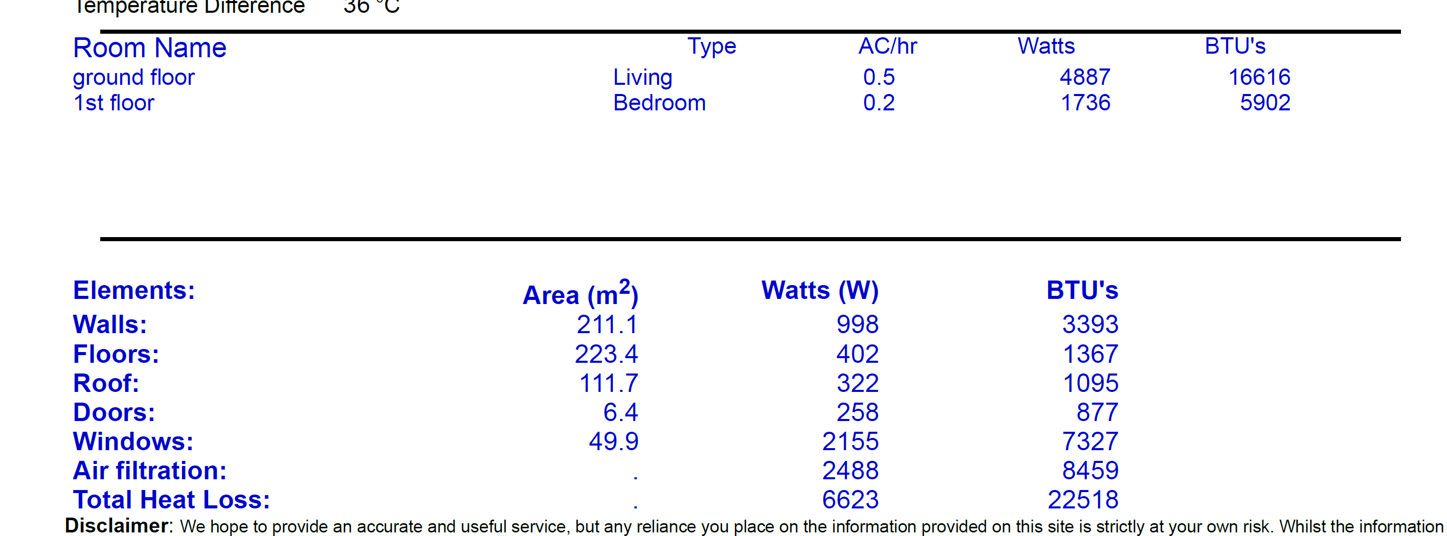

  7. @Big Jimbo try https://www.changeplan.co.uk/heat_loss_calculator.php It's a lot easier to use, i just entered ours as a box, similar U values to yours and at -15C out 21 in im getting 6.6kw for 211m2
