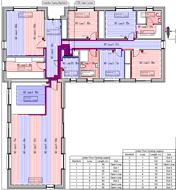

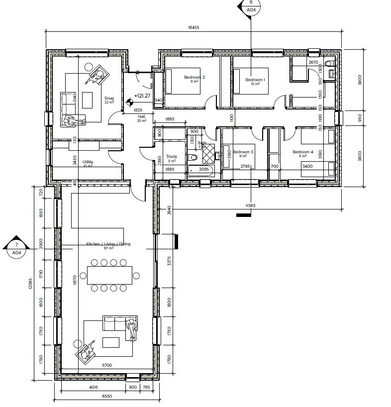

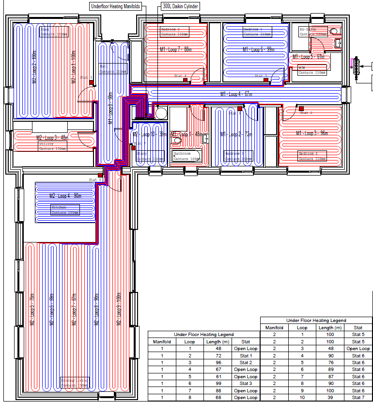

New build bungalow 200sqm all UFH. 150mm PIR in floor with 75mm screed, 110mm PIR in cavity with 50mm insulated plasterboard on internal block wall. Originally plan was oil boiler but after pricing everything ASHP is starting to make sense with 7-8year pay back. Also much simpler. Looking for some help with design. This will be self install hence all the questions. Grant Aerona3 (Chofu) 10kW (subject to heat loss calc) Inverter driven and variable flowrate/output temp etc. Grant 300l UVC 2.35m2 area coil. Open to recommendations as the coil seems small. Couple of questions - Do you still need red expansion vessel on low temp system? - On oil boilers is standard to install likes of Spira vent and trap. Is this needed? - What is the best way to plumb UVC coil? Presume a 3 port mixer but how is this typically controlled. - There will be no zoning on UFH just weather comp on ASHP. However main areas are recommended at 20 and bedrooms at 18. How is this achieved? Balancing?? - 16mm pex-al-pex in floor with 150mm spacing. Presume spacing is not that important but 150mm is standard. - 32mm pex-al-pex between ASHP and manifolds. Use water and frost valves. - No buffer/volumizer etc. What do people do for control. I'm based on Ireland so the likes of homely isn't available. Do people just set a weather curve and keep adjusting until optimal or is there a better way to approach. Heatpump has modbus.

Based in Ireland new build with 206sqm underfloor and 300l UVC. Originally looking to install oil boiler but doing the maths if I can get a Heat Pump for the right price it could work out better. Plus much similar to install no mixers all 1 zone etc. I hear of several people getting good deals off ebay. Are there certain brands to avoid, does sCOP vary much from 1 manufacturer to another? For example I can source a BC15-012S/P locally for just over 1k. China Household 3.8~9.8kW Air to Water Heat Pump Water heater for Domestic Hot Water BC15-008S/P~020S/P Manufacturer and Supplier | O.S.B. (osbheatpump.com) Need a sCOP of 2.6 to break even will current oil/electricity prices and I can buy all materials for approx €1500.
New Build 150mm PIR in floor and 130mm PUR in wall. @Conor what setup would you recommend to prevent short cycling and keep return temps right? @Andehh what thermostats/controller are you using.
