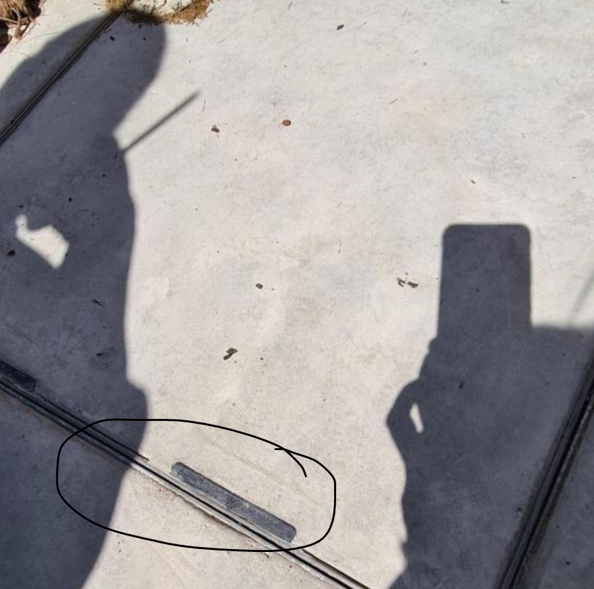

Manhole can't be opened after polished concrete finish
Dave Jones replied to scnb's topic in Waste & Sewerage
they look same as our recessed covers, those plastic bits slide off and expose the handle underneath. I did snap this cover on one before we installed as it was soo tight. try knocking it off with a chisel to expos the handle. can allways dab it back on with a bit of silicone after -
