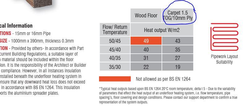

Spreader plate floor covering - 10mm ply?
blankton replied to blankton's topic in Underfloor Heating
about 48 screws on a 8 x 4 sheet. -
I have just installed some spreader plates for a wet UFH system. Due to the existing floor being uneven and noisy, I have build a framework of 3x2 CLS at 400mm centres. The attached datasheet gives heat output with two floor coverings - wooden floor or 10mm ply and carpet. Have I misunderstood this - the manufacturer is recommending 10mm ply as the deck on top of the spreader plates. I can understand that its best to keep it as thin as possible, but 10mm seems very thin. We have tried a sheet and put a lot of screws into it, but if you are between the centres, it does depress slightly. The small amount of deflection would probably not be noticeable, but I am concerned that this repeated movement might eventually cause the pipes to wear or fatigue. After the mammoth undertaking of fitting this system, I'd like it to last very long time and not be pulling up boards due to leaks in a few years time. So - am I worrying over nothing? Have I misunderstood the manufacturers spec? Has anyone used 10mm ply in this application before. If not, what should I use. I guess if I stick with ply I can keep it thinner than chipboard (22mm) as its stronger. 15mm, 18mm? Many thanks for any advice.

Its a shame the forum doesn't seem to allow photos, as you'd have seen the photos of the slab. There is about 400mm of a product called "foamed Glass" insulation under the limecrete slab. If you google "limecrete floor" you will get all the information on this. I believe that this will be suitable. We had already come to the conclusion that the spreader plates needed to be nailed up very tight. We were wondering about also putting some PU glue on them, to make sure they never try and come loose, but obviously this will be another mini layer of insulation. Any thoughts on this? It almost sounds as if you are saying that the spreader plate solution would never work very well, its always going to have to conduct heat through the floorboards, as they cant be nailed to thin air. I realised the upstairs UFH wont transfer the heat as well as the downstairs pipes encapsulated in the slab, but I figured that upstairs would also be getting some of the "heat rises" effect from the downstairs (which I expect to be a very stable warm temperature), with the bedrooms likely just needing a boost morning and evening. I'm finding this really interesting. I've heard lots of stories of people that have replaced a gas boiler with an ASHP through their existing rads, and it hasn't worked due to the rads being too small. I thought I was being smart in going all UFH to have the lowest flow temps, but you seem to be telling me I actually need rads?! I feel I should also reiterate, I have no mains gas (otherwise there would already be a nice efficient combi), so I am effectively competing with storage heaters. I only have a very small yard, so an oil tank or LPG would be quite difficult as well.
I realise that the ground floor slab will take a long time to get warm and a long time to cool. The first floor will have less thermal mass and will heat and cool faster. Are you saying that the UFH flow temp would also have to be higher on the first floor? How high can you go? I thought that you were limited to a floor temp of about 27C as it can damage flooring if it goes higher?
