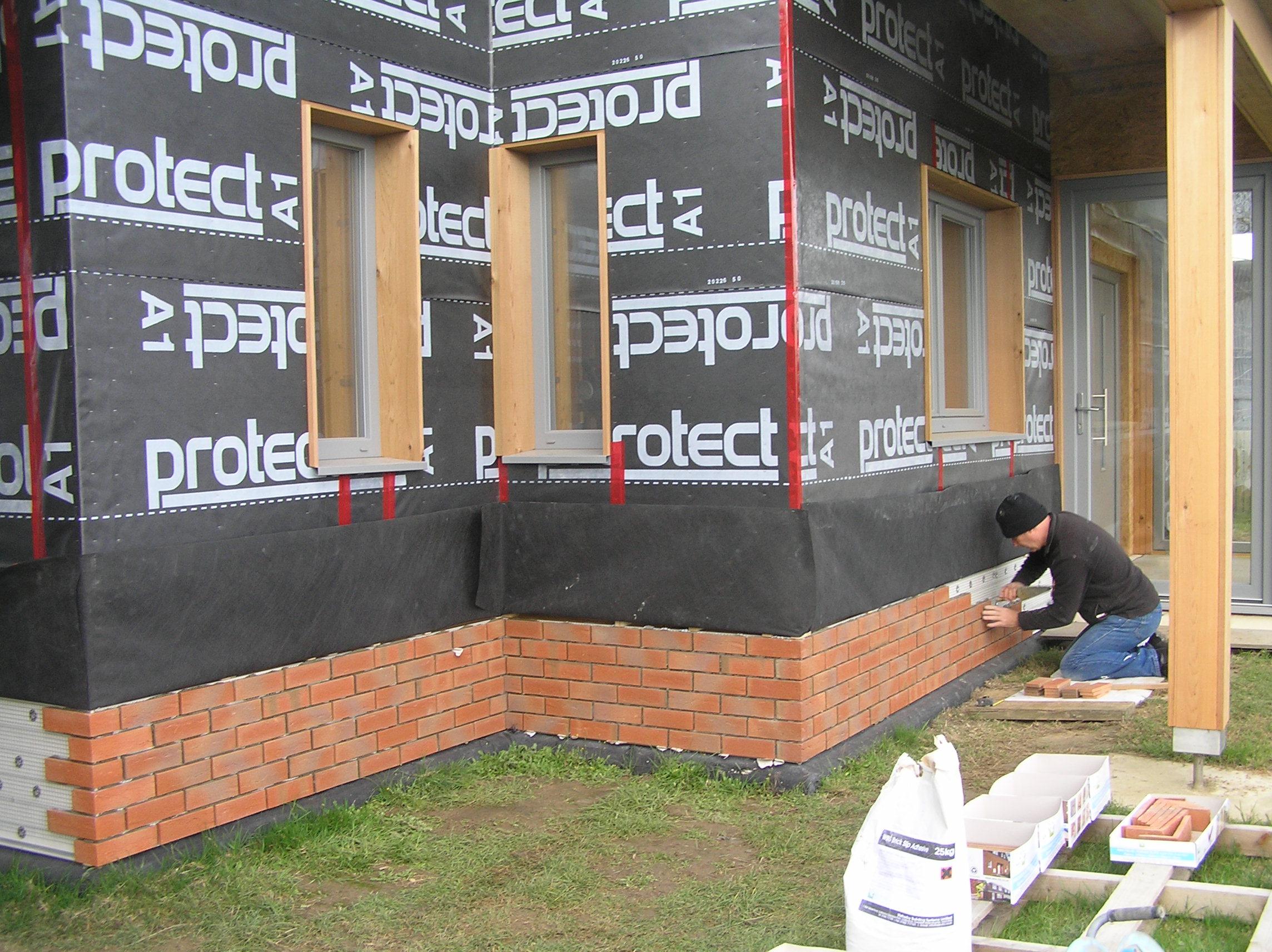

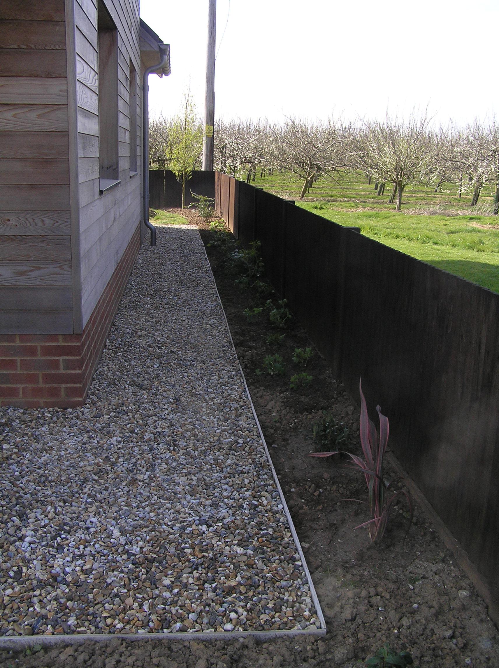

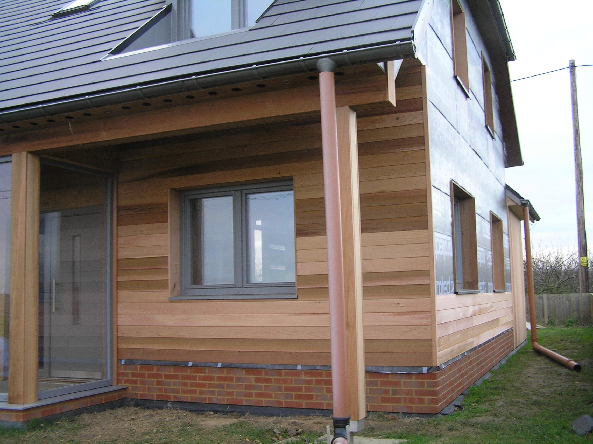

Yes I see, in my case it's a hanging screen so doesn't touch the ground, just the shingle pushed up to the outside.
The brick slips are just a rainscreen and our DPC is behind the cavity. I can't say for sure whether Wetherby do a blue brick but they do have a large range. We have shingle around the base which just covers the bottom of the slips.
We half DIY'd it. We installed the render board (Bluclad) and mesh but I chickened out of fixing the slips and pointing as we were running out of time for getting the plinth finished and the cedar cladding fitted before the weather changed. We had a chap who was a general builder finish it for us. He said it was straightforward and he used a half round tool for finishing the mortar. We could have done it ourselves but it would have taken a lot longer.
I used the Wetherby system which uses a bagged mortar which is applied with a mortar gun. The whole system is pretty straightforward to use. https://www.youtube.com/watch?v=IoZGlEU7apA
