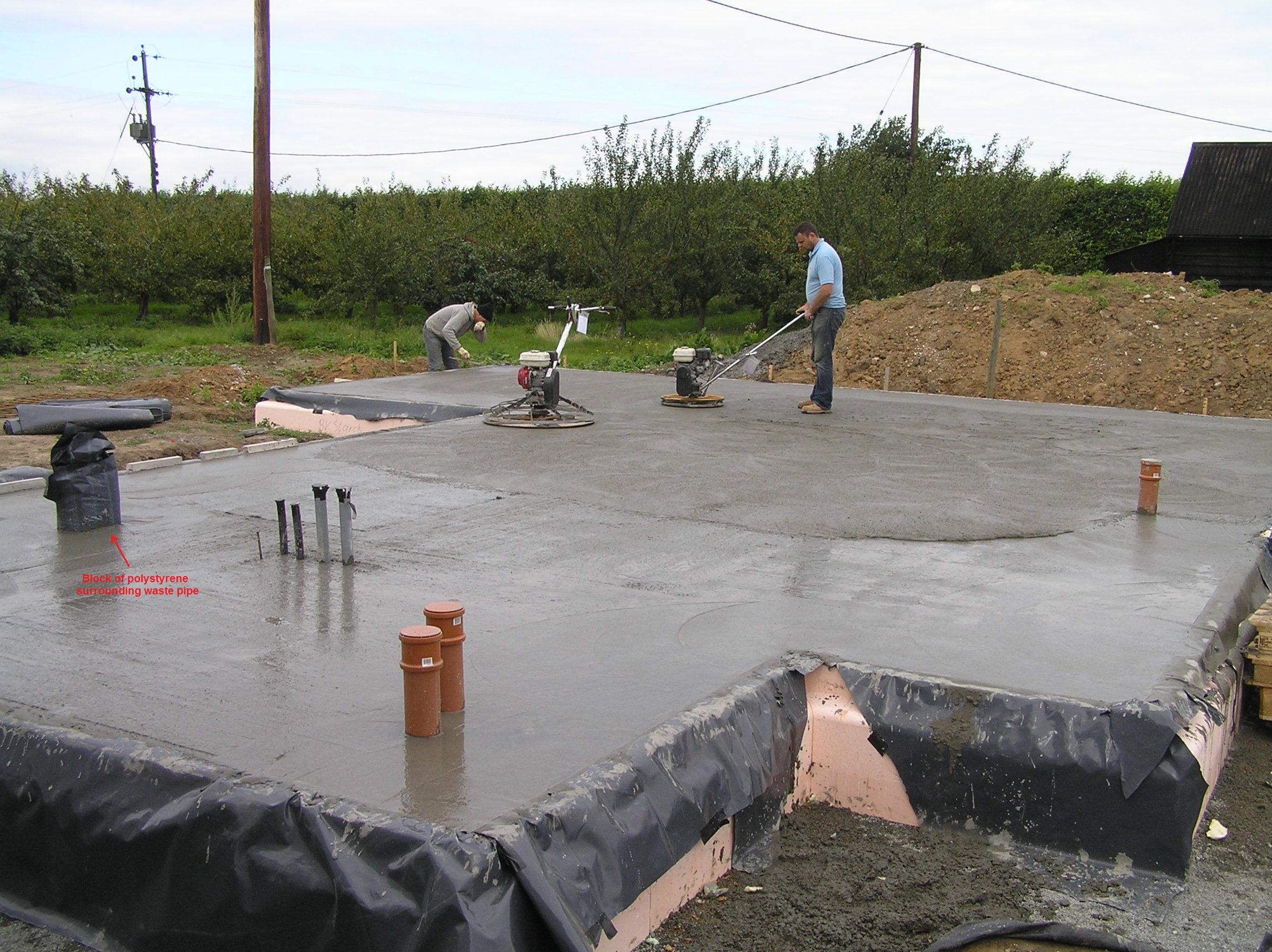

Yes I have a passive slab and the insulation is by Isoquick. Ours was the first Isoquick installation in England and we had the Isoquick insulation laid for us but having seen it installed it could be done DIY as it just slots together like a jigsaw puzzle. If self leveling concrete is used it would be relatively straightforward. We did encounter some problems which are in our blog.
