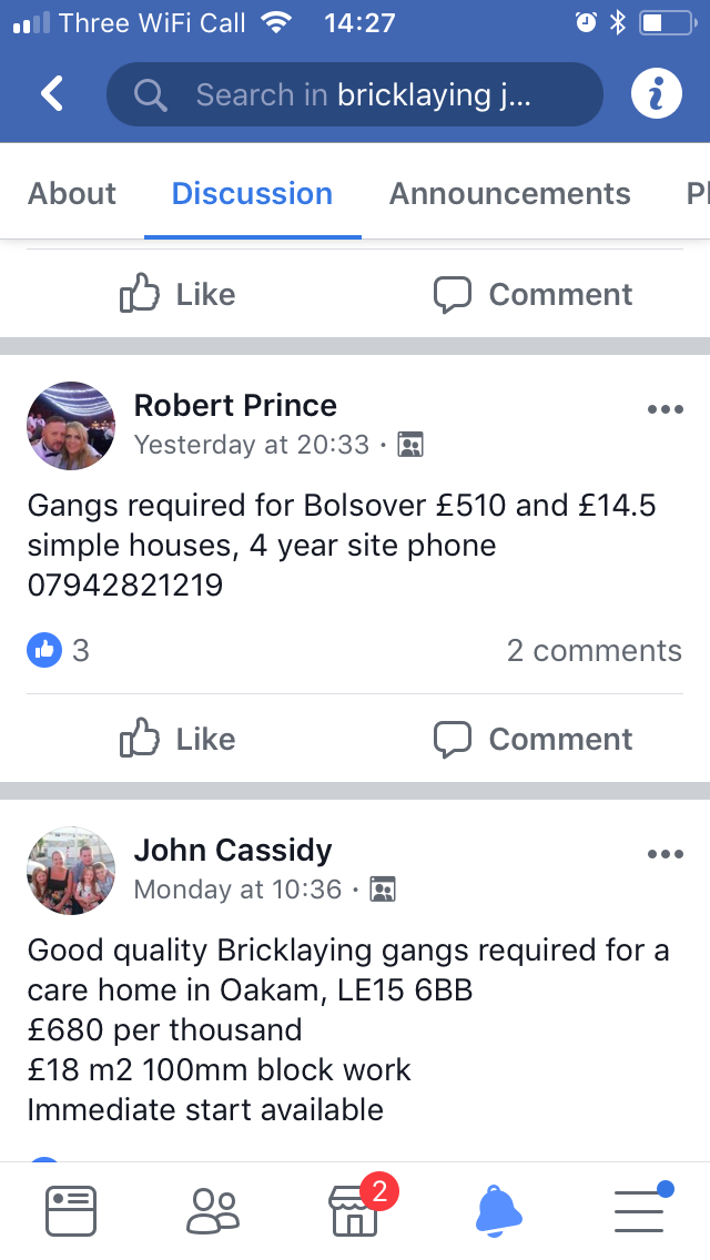

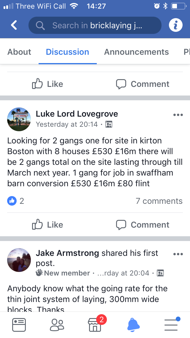

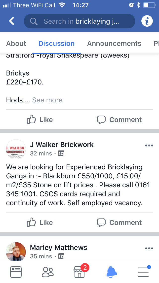

I have to say that,so long as the quality is decent,you will have had an absolute result on those prices. I see posts on social media for jobs in the North East,North West & even Scotland exceeding those rates,and that’s from a Subbie who’s taking a cut and would be with forklift/crane on site with silo mortar & horizontal loading only (I.e. no ladder work.) -
