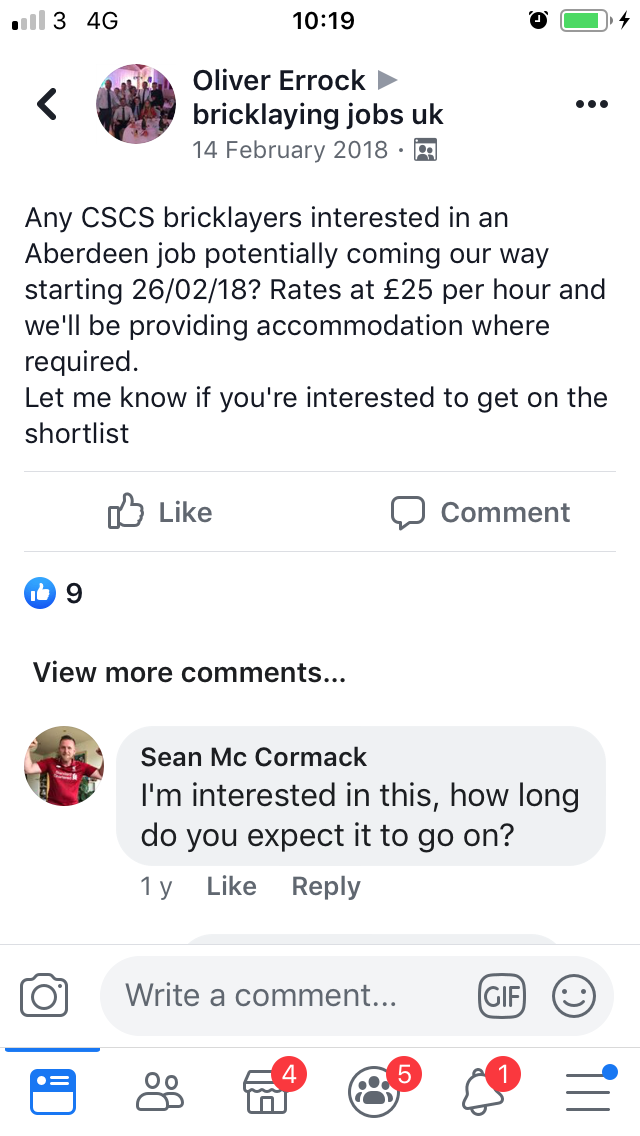

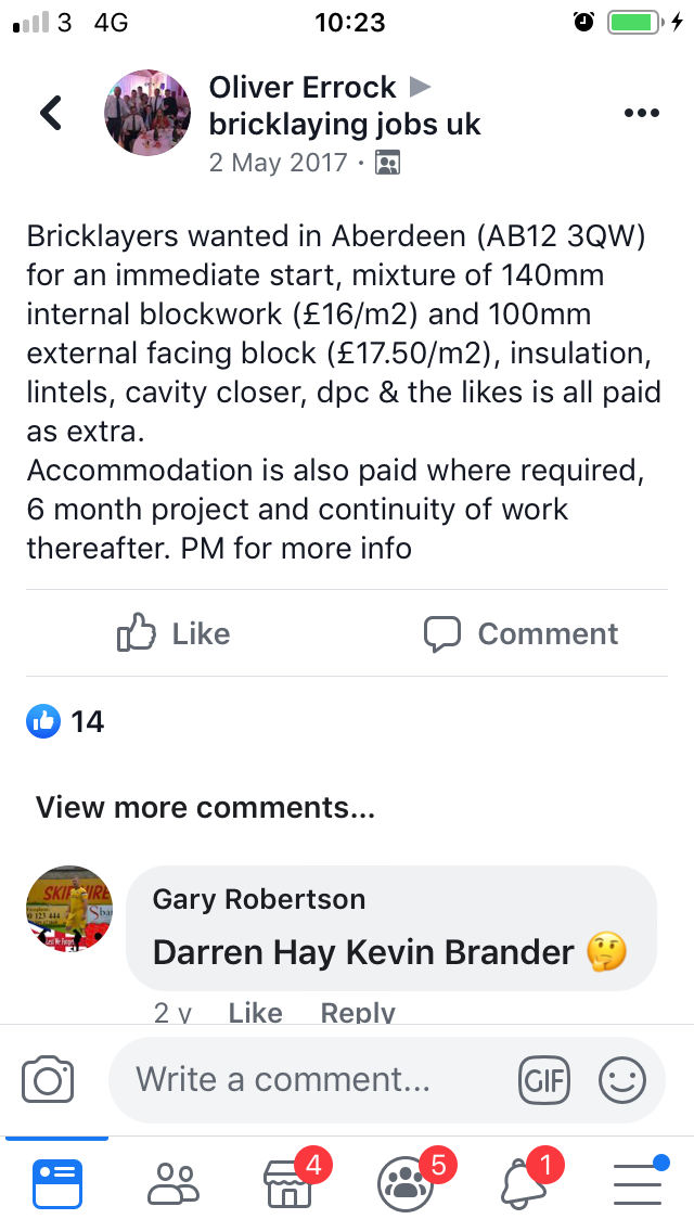

  20. Just a couple of ads I’ve seen. The traditional regional swing in rates seems out of the window atm,for whatever reason. Leeds,Manchester,Liverpool,Midlands-all offering comparable day & price rates to the South. Wales & the far South West maybe the exceptions.
  21. You’d get at least 40% more on site,with a continuation of work,fork lift bringing your gear AND a subbie making a cut on top. Go jump yourself :))
