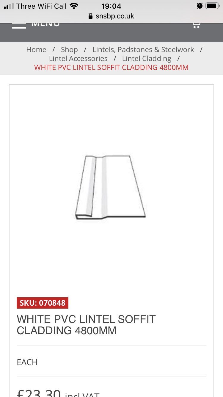

Used to be able to get pvc sleeve cover strips for them,haven’t seen them on site for a while though.
