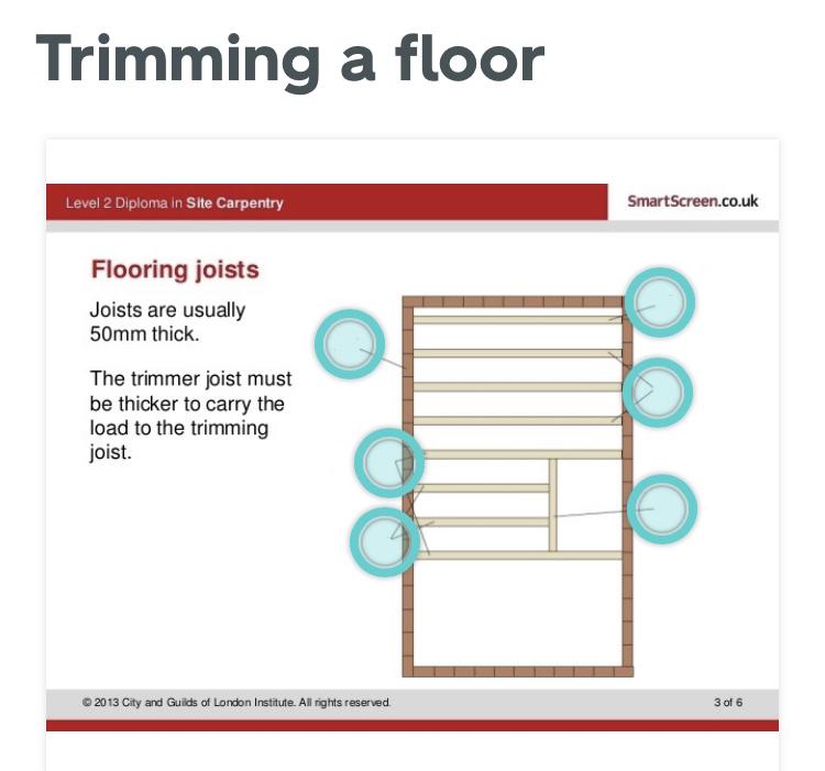

+1. The typical detail for joists round a stack would involve ‘trimming’ as it’s known,like this,so it’s just a case of filling the void where the stack & hearth were,once removed.
