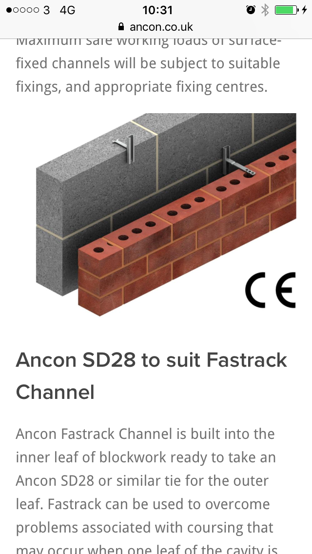

There is a two part tie system I've used previously for larger cavities (you bed one part in to the skin you're building & the other part locks into it for the other skin.) No idea of cost,but what I've found when building a 150mm cavity (the largest I've worked on) is that,with all the will in the world,a lot of the ties topple out before you've laid on them. The extra length & weight of them makes them extremely difficult to keep in position before your brickwork goes on your bed joint,so inevitably a few (or a lot) end up being pushed in afterwards,seriously impacting their effectiveness. Another option might be to build in Abbey channel slots,&I use the sliding ties. Again,no idea on cost.
