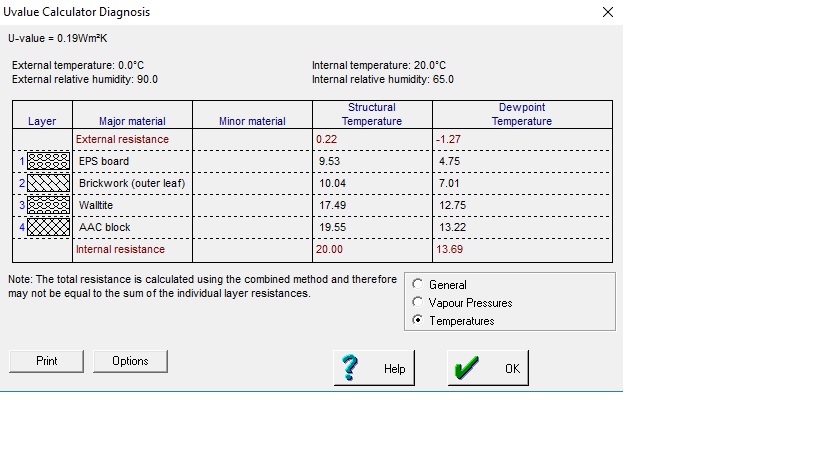

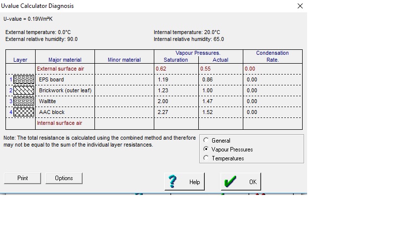

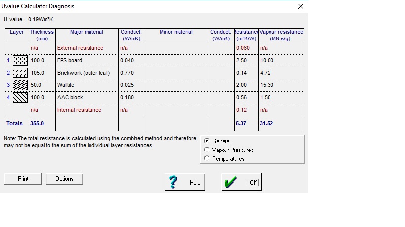

Yes, here is a condensation analysis. Since dense concrete block does not produce interstitial condensation with a filled cavity I assumed that the OP would be referring to AAC block (lambda 0.18W/m.K) which does, after all these have been around for a very long time
If visually acceptable airbricks top and bottom would do The people who supply Icenyne usually have access to a closed cell polyurethane as well. Walltite, a spray applied closed cell polyurethane has a vapour resistance sufficiently high (306 Mn.s/g.m.) that interstitial condensation would not occur. There are a small number of companies that use polyurethane for cavity wall insulation, it is usually used where wall ties have failed as it sticks the two leafs together. Interstitial condensation happens in this case for two reasons, 1) the lightweight block is sufficiently thermally resistive to significantly lower the temperature of the brick outer leaf. 2) polystyrene has a significant vapour resistance, typically 100Mn.s./g.m that it causes the water vapour to 'dam up' on its warm side in the outer masonry leaf, in comparison with high density fibre batts at <10Mn.s/g.m These two effects combine to push the vapour pressure above the saturated vapour pressure for the location, causing condensation. Without a cavity venting solution, which really just increases the temperature of the outer masonry layer 150mm of EWI will lower the temperature and increase the vapour pressure in in the outer masonry leaf causing even more condensation

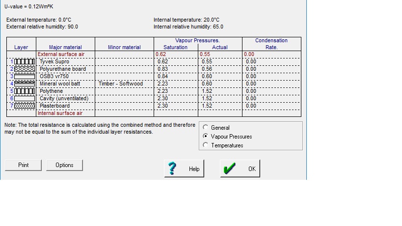

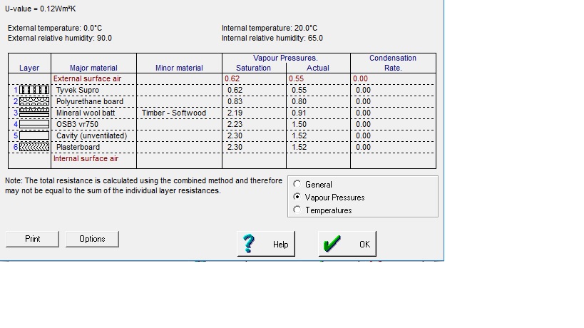

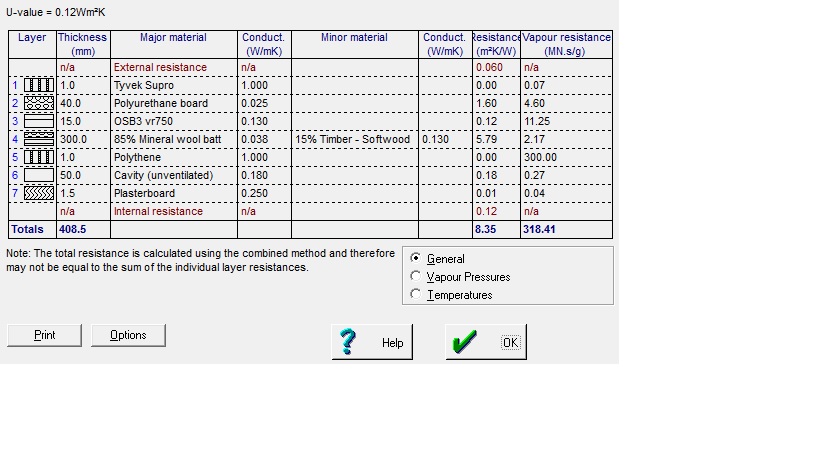

Hello @MikeSharp01, sorry for the slow reply, went out after replying to Crofter, came back late and was too tired to assemble this reply, unfortunately things are now going to get a little complex and perhaps a little indecisive. First here is the BBA cert for Norbord OSB3 which may be what you have http://www.bbacerts.co.uk/CertificateFiles/38/3857PS1i1.pdf Here is a useful document that will on page 4 enable you to convert the various units that are used in vapour resistance/condensation analysis http://builddesk.co.uk/wp-content/uploads/2013/01/vapourResistances.pdf I have approximated your build-up as follows Note the high vapour resistance off the polythene VCL Based on this build-up here is a condensation risk analysis The model, which operates to BS5250 1989 and BS6229 and suggests that there will be no interstitial condensation under the given conditions. If the vapour resistance of the VCL layer was reduced to about 40Mn.s/g it suggests condensation may start to occur at the OSB layer. Here is a publically available tool to model condensation risk, which works to BS5250 2002 http://www.builddesk.co.uk/software/builddesk-u/condensation-risk/ a 30 day free trial version is available. Just make sure the external/internal temps and humidity you use are realistic In summary 1) Your build-up as described appears to have no problem with interstitial condensation. 2) If the VCL was degraded sufficiently a risk could arise, it does not 'fail-safe' 3) If your build-up is exactly as you describe it seems to me that VCL is vulnerable. -
