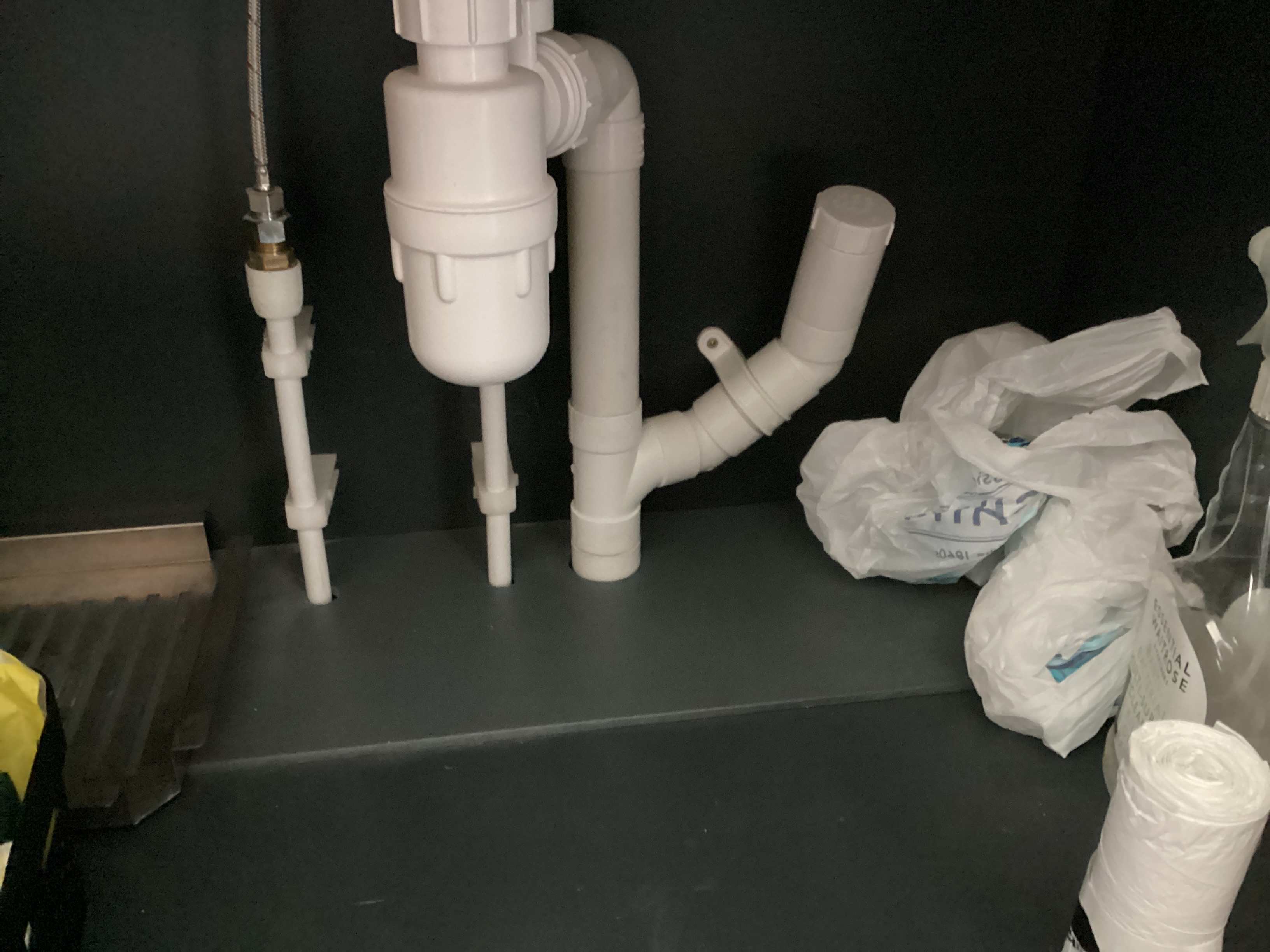

  4. Fit trap to sink, use two 45 bends to realign with floor waste. cut a large trap door 200x200 in cupboard floor, sort the pipework then make a nice cover trim to go over the 200 hole, it’s far easier than trying to cut a 50 mm hole and getting it all to line up. especially if you are using the same monkey knuckle draggers you had to install that pipe.

  23. Trim off all the foam layer down to screed level get a can of illbruck fm330 foam, good squirt around all ducts and down the ducts, as it dries and expands a bit you can pat it into shape or just trim it back afterwards. or don’t bother trimming and just leave a big blob under the cupboard if your worried about catching the pipes or cables.
