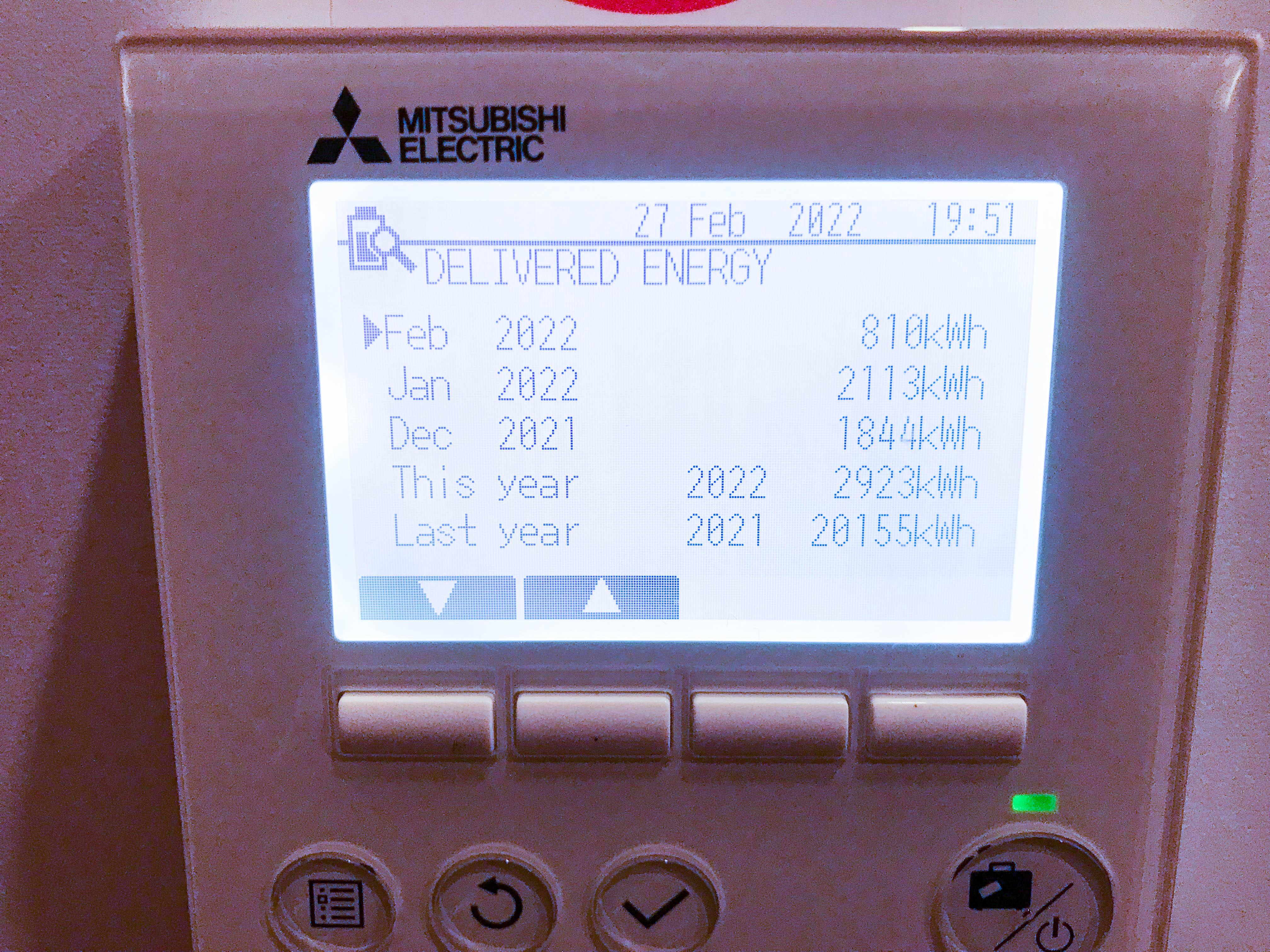

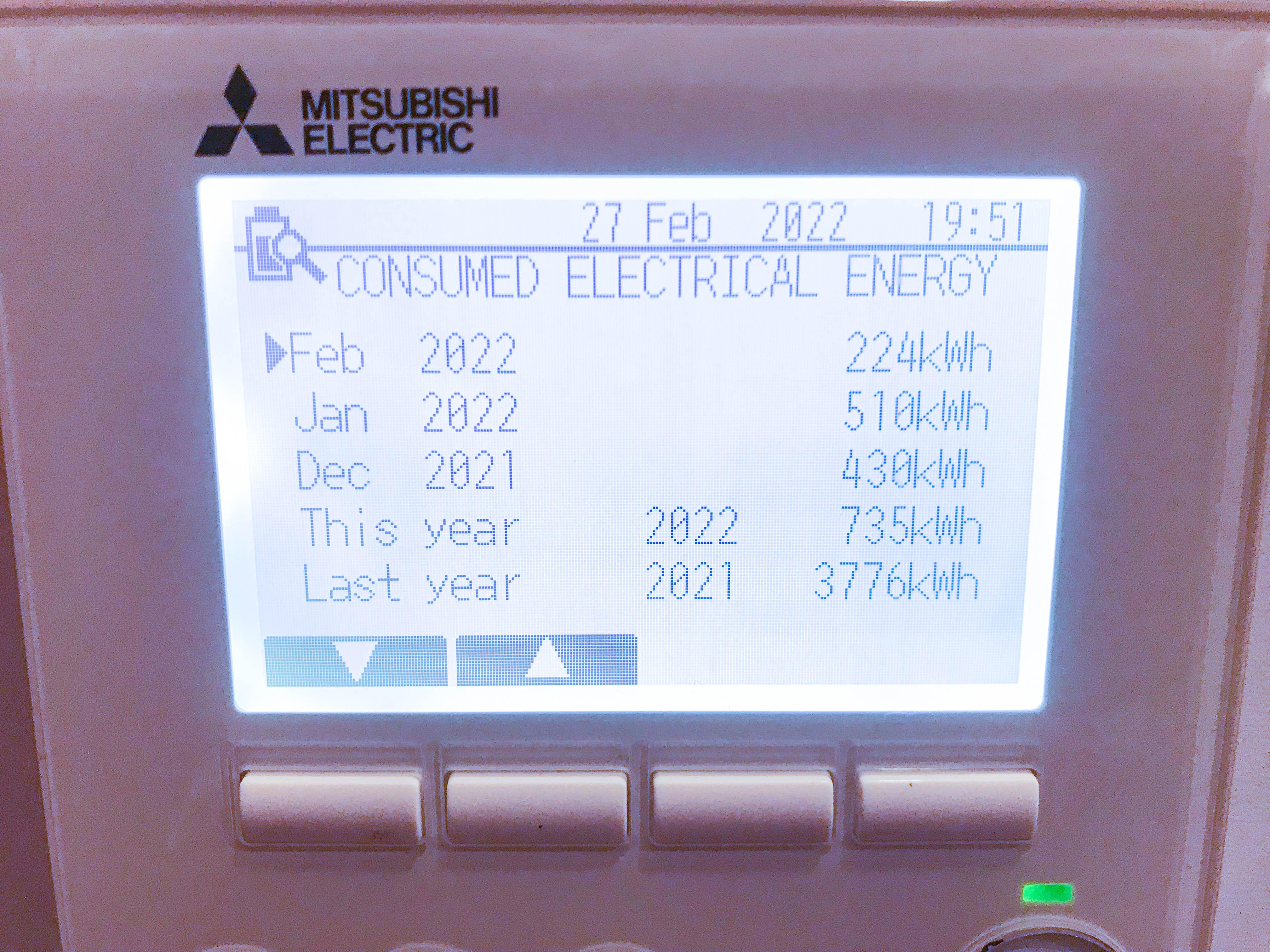

From the last year (2021) in our new build, 275sqm, well insulated with PV and MVHR the Ecodan control panel reads out 21000 kWh delivered and 3700 kWh consumed for DHW and heating, I appreciate this is subject to our personal requirements but your heat demand estimate is realistic. Would be interested to know the capital costs for LPG for future reference if you have them.

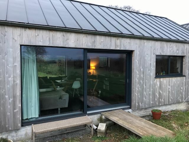

No specialist building skills but had the time. My Dad who is in his 70's did all the drawings by hand and helped erect the frame. Everything except plastering, electrics, ASHP inc commissioning for RHI and windows ( badly installed ) though fitted 8 Velux myself. Timber frame, 11m steel ridge beam, heaps of insulation, Air tight, MVHR, UFH, Seamed metal roof., Cedar cladding, Concrete work tops and on it goes. -
I made a frame similar to a skateboard half pipe on the ceiling then fitted a layer of red faced ply followed by glued and pinned 4mm birch ply, it was a challenge. I have built most of the house myself excluding electrics and skimming.
I had similar issues trying to avoid a large steel ridge and MVHR pipe work. I decided on building a curve using birch plywood.

Same as me. Photographer for 30 years and now let's go building, though my dear Father (78) helped me build the frame. It has been a challenge but worth it. -

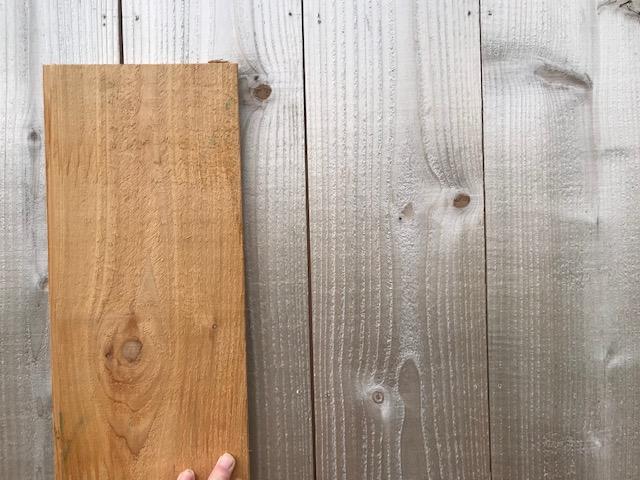

My frame had 600mm centres, underneath the membrane is 40mm Pavatherm so fixed vertical batten through to the studs. Horizontal battens at 400mm, cladding is western red cedar, about 195mm wide with a half lap. My window details took a few before I was happy. I put a 15 degree angle on the horizontal batten at the top of the window and cut a drip channel underneath the cladding. Fitted the reveals with the cill in place. Fitted some stainless steel mesh at top and bottom of batten just to keep rodents, insects out as much as possible. -

Having lived with an Ecodan for over a year now it has used just over 4000 kWh for both DHW and heating. This is for a very well insulated, air tight home with 5 adults. Never run out of hot water and the noise this particular unit makes is not an issue. It is sited outside next to the wall of the house. I originally planned for it to be sited 15 metres away but the suppliers said its not necessary. However in built up areas and in poorly insulated properties the results might be very different. And yes the RHI did influence the decision to proceed with an ASHP.
