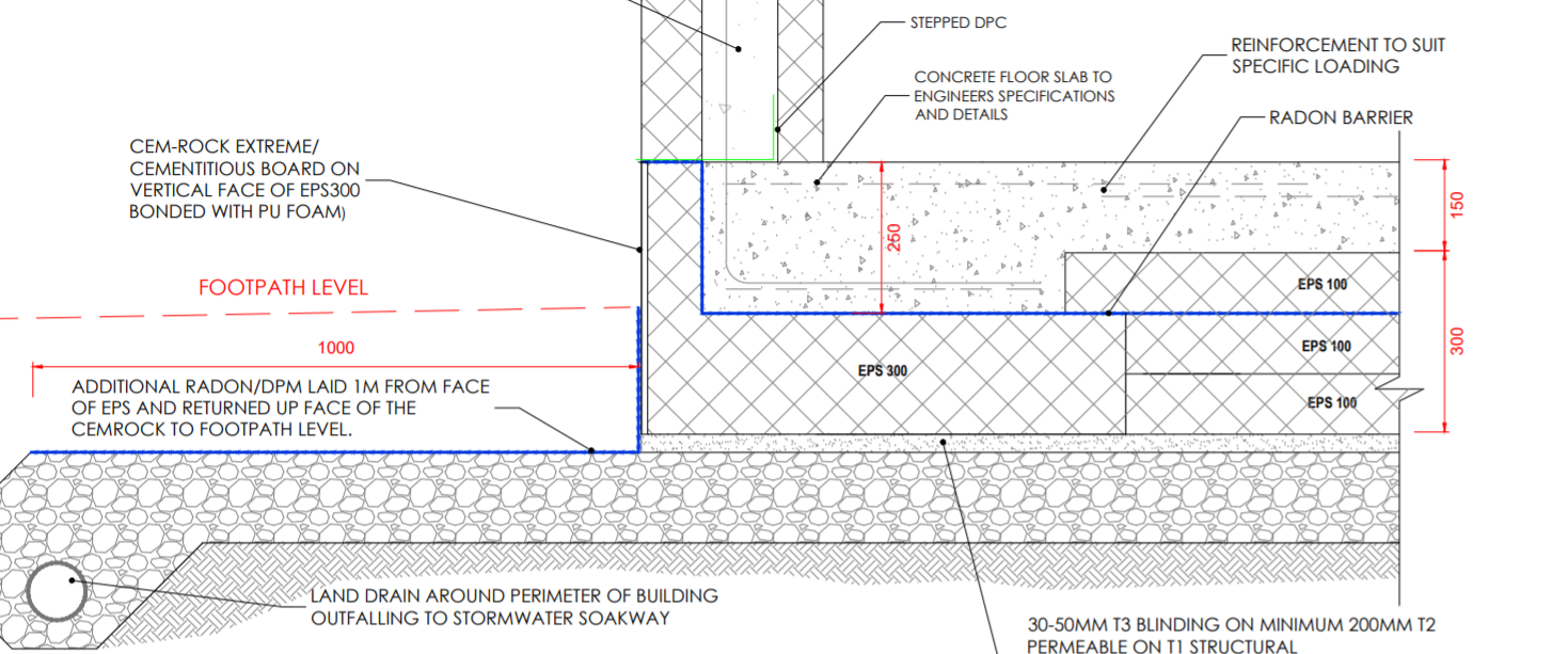

Thanks @Russell griffiths will have a look for a Triton stockist in Ireland as that's where I am based. I cannot find any peel and stick membranes online. Could you direct me to any brands? Will also contact ICF supplier. Thanks a million. -
ICF and Insulated Raft Junction
PaddyP replied to PaddyP's topic in Insulated Concrete Formwork (ICF)
Would this maybe do the trick as an extra layer of protection ? https://www.screwfix.com/p/bostik-flashband-grey-10m-x-150mm/55009 -

Hi all, I am currently building a house using a Kore insulated raft foundation and 350mm Amvic Passicve ICF block. Since the ICF walls have been completed we have noticed patches of damp on the slab where the ICF wall meets the floor. These damp patches are located randomly around the perimeter and are not located just under windows so doesn't appear to be an issue with sills. The raft foundation is our finished floor and will be polished in the coming weeks. After contacting Kore their solution to solve this problem and prevent further issues is to install a basecoat and seal the connection this way. However, the house will battened and clad in corrugated metal so this solution is not of much use to me. From what I unfortunately only now see, this seems to be a fairly common issue. We have not yet completed our external cladding and flashings yet so perhaps that will solve the problem by directing water away from the junction and I am worrying prematurely. However, if this does not fix the problem it will be much more difficult to fix after cladding so would like to go overkill now if necessary. Detail below was used during construction. Stepped DPC detailed was not installed due to the starter bars. In hindsight a hydrophilic tape/waterstop should have been added but unfortunately too late for that now. Has anyone come across a product solution to this issue? or can think of a

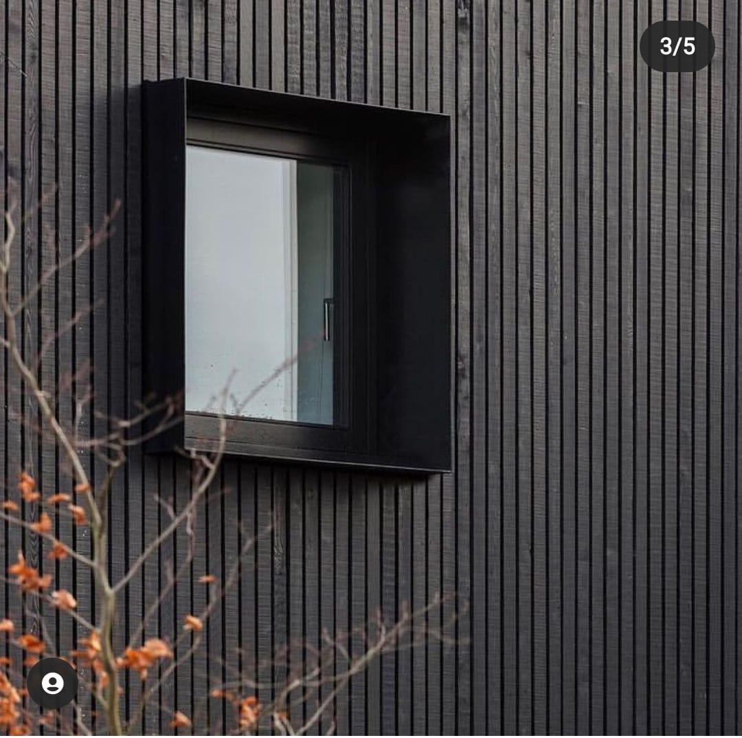

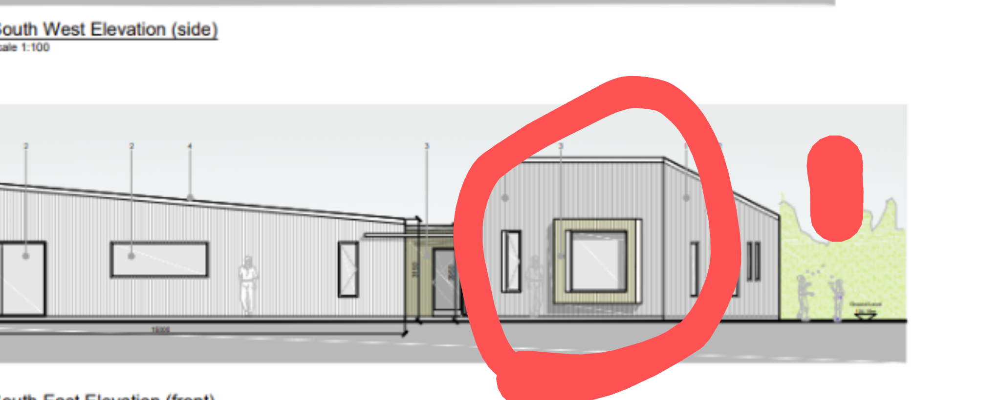

Hi @ToughButterCup yes it's a metal reveal I'm looking for. I agree it looks fantastic when done well. The difficulty I appear to be having is nobody seems to want to take responsibility for it. As it's off standard and it's falling between trades. As you can see in the picture below we just have one window with this feature so while not essential would be a nice feature and would like to keep it.
Hi all, I am having a little bit of trouble with the external window reveal of one of our windows. We want to extend this further and create an overhang like in the picture below. The house is ICF and to be clad in corrugated metal. Keeping the windows watertight is a major concern of mine. We have come to a solution for all other windows except this one. Has anyone done something similar and would be willing to share their solution? Or have an idea who I should approach? Would this be something for a specialist metal fabricator? All the best, I hope
