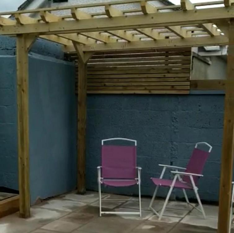

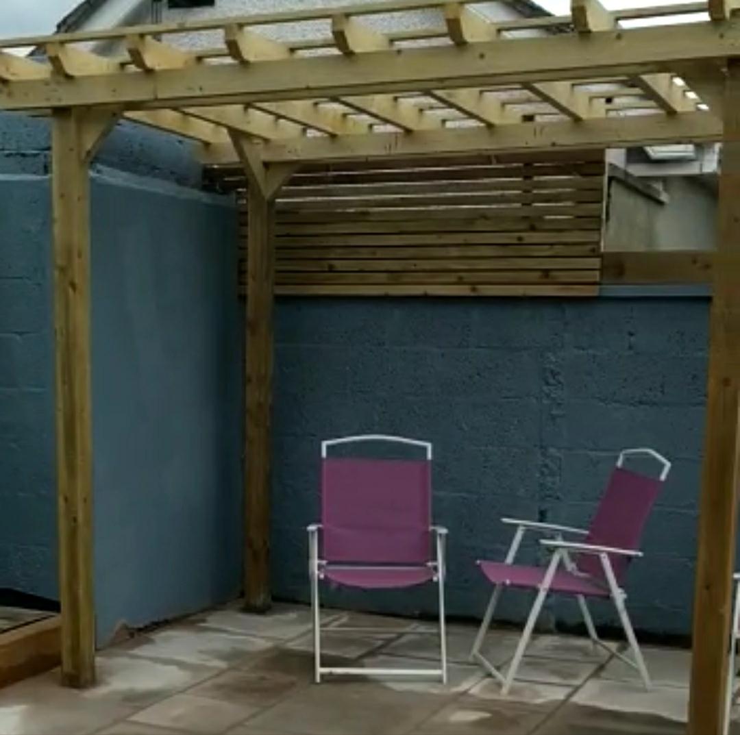

I done this one last week using treated softwood. Used 4*4 fence posts for the uprights and 4*2 treated for the rest. Longest span is 2.4m with 4*2 doubled up front and back of the posts. On top is treated lath as the customer has a pergola cover so they will stop it sagging.
