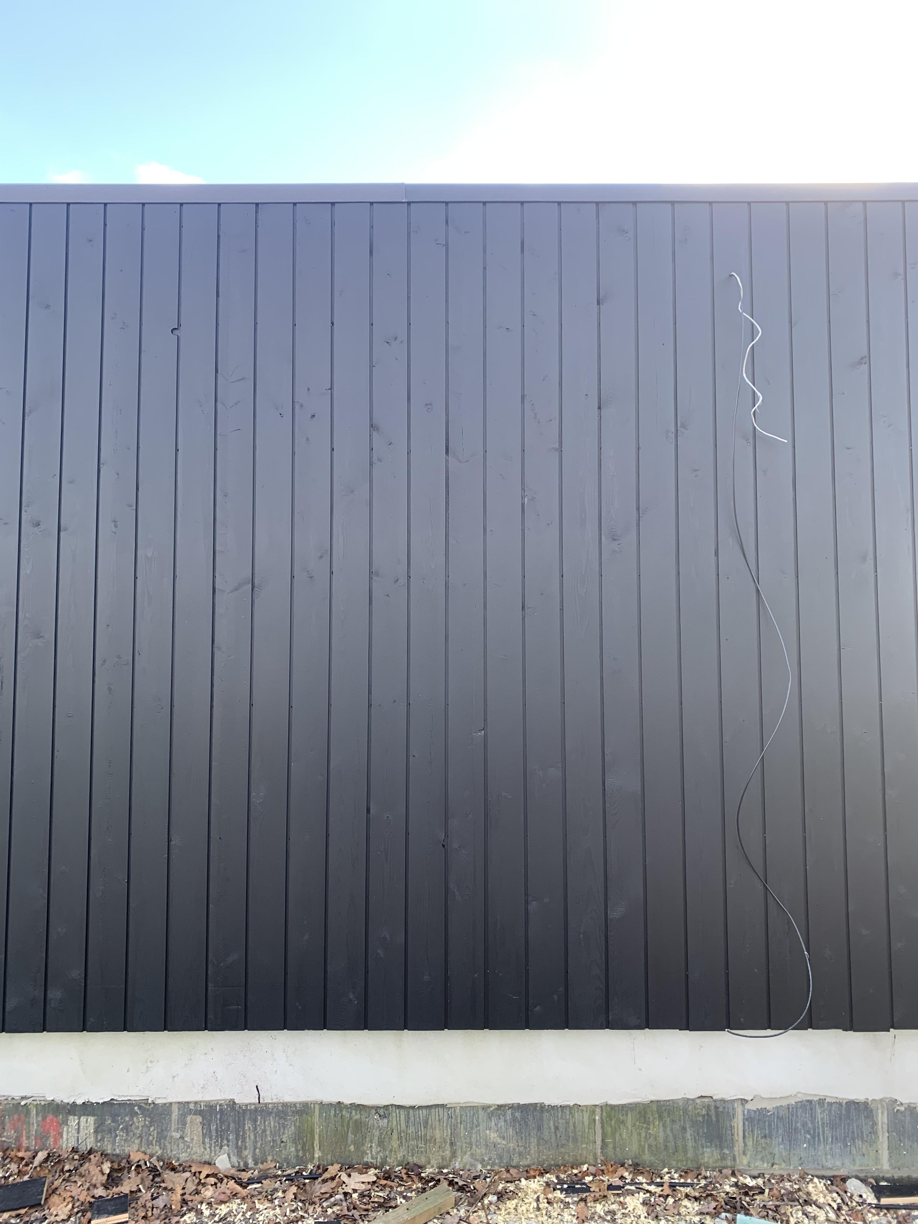

It does depend on the wood. If its cedar for example then nails and hammer for me (the front of the house is that). I used the nailgun on the larch but as per @joe90 its painted black so you don't see the heads. The Dewalt nail gun doesn't leave any teeth/dent marks as it has a plastic guard to stop that. Here's a section using the nail gun. Honestly you can do it all by hand (with hammer) just slower going but gives the best result. My carpenter said a 2nd fix nails wouldnt be strong enough. This is area is using the 1st fix gun (50mm stainless nails) : -

I’ve just about done mine. Yes you want it go in at an angle so it pushes the board up against the previous board. In areas that you will see a lot I’ve use a hammer and small stainless nails and then punched them deep into the wood so that you cannot see them. If you are not fussy then use a nail gun. I’ve used a nail gun for the rest of the house and you definitely want a first fix one. However I’ve got the dewalt battery powered one which is great as you can adjust how hard it punches which you kind of need depending on the wood type and thickness (my boards are 22mm but at the tongue it’s thinner). Only downside it’s fairly heavy but manageable. You need to pay attention to corners and windows reveals if you are doing vertical cladding to make sure you don’t end up with a silly thin cut. You need to slim down the boards so they work out right with a table saw and router -
