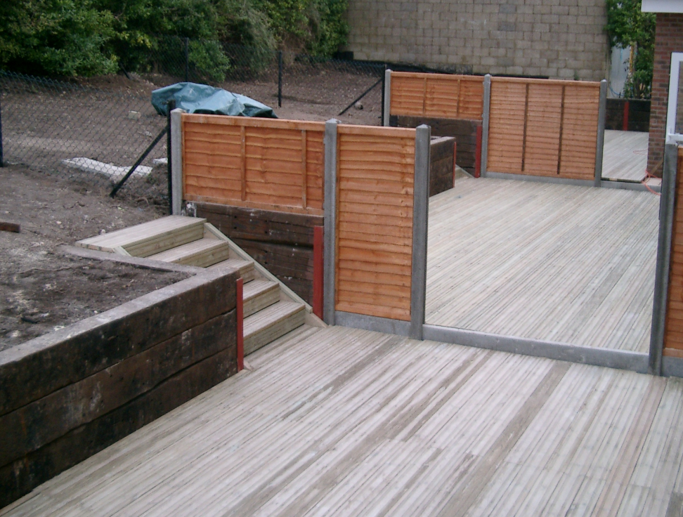

Decking seamlessly linking to internal floor
Mr Punter replied to Tony K's topic in Landscaping, Decking & Patios
The photo was just copied from a website https://www.marazzitile.co.uk/collections/treverkheart/ but I have not used them On our roof terrace we have some 20mm thick porcelain on adjustable feet but not wood effect. Allows the water to drain away. -
