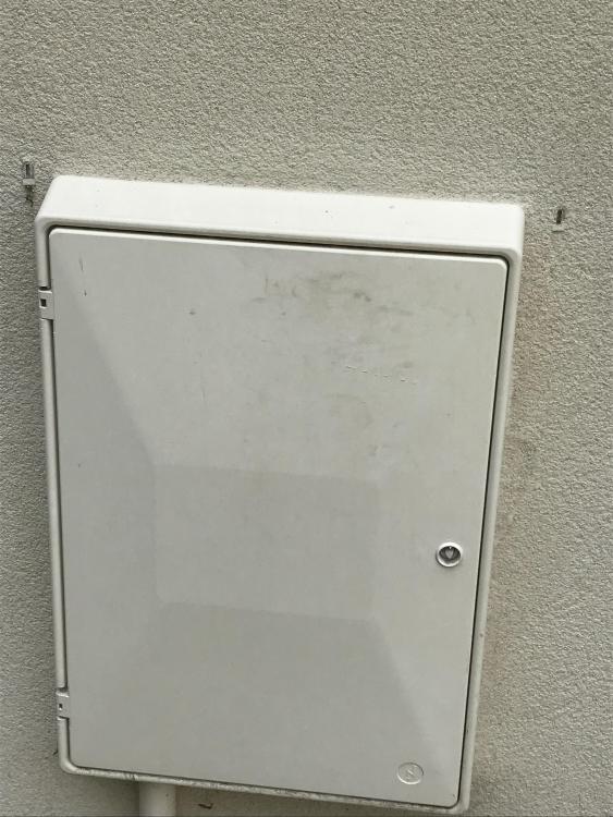

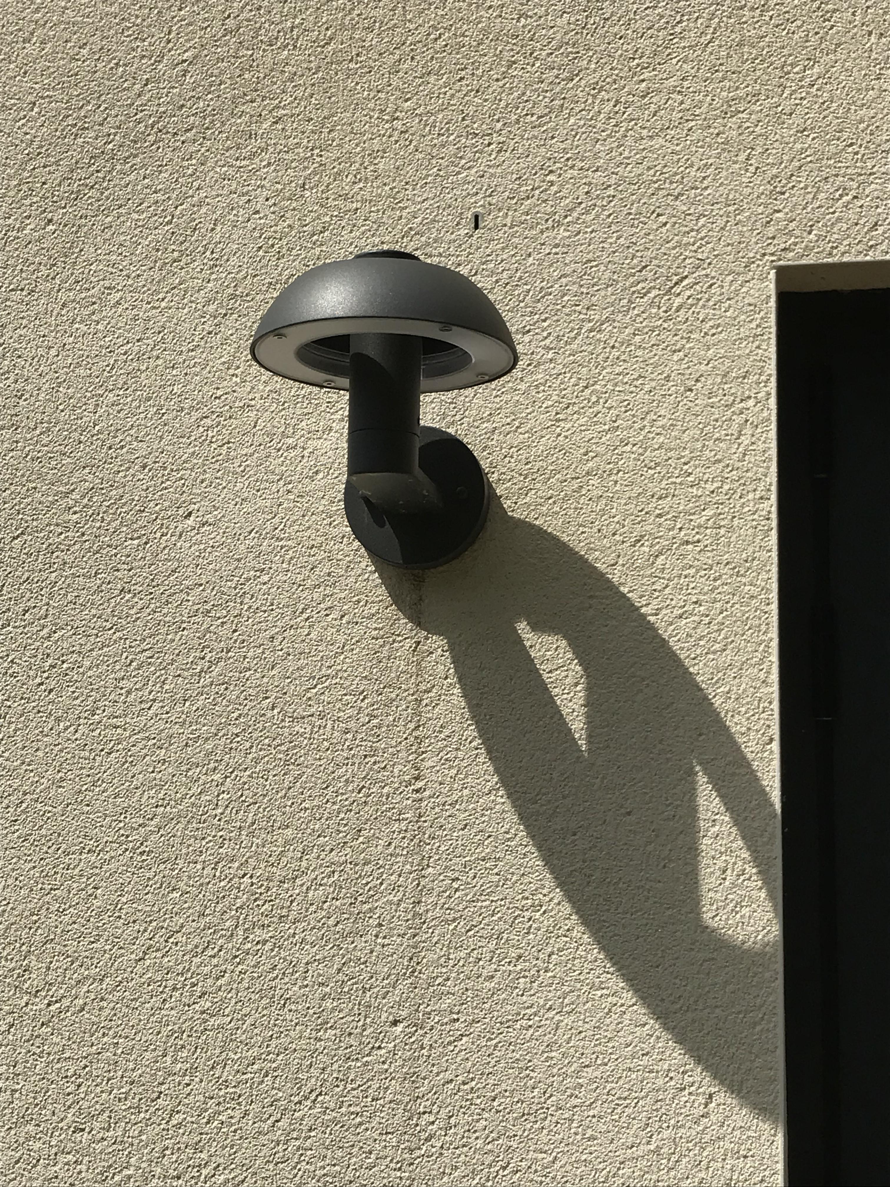

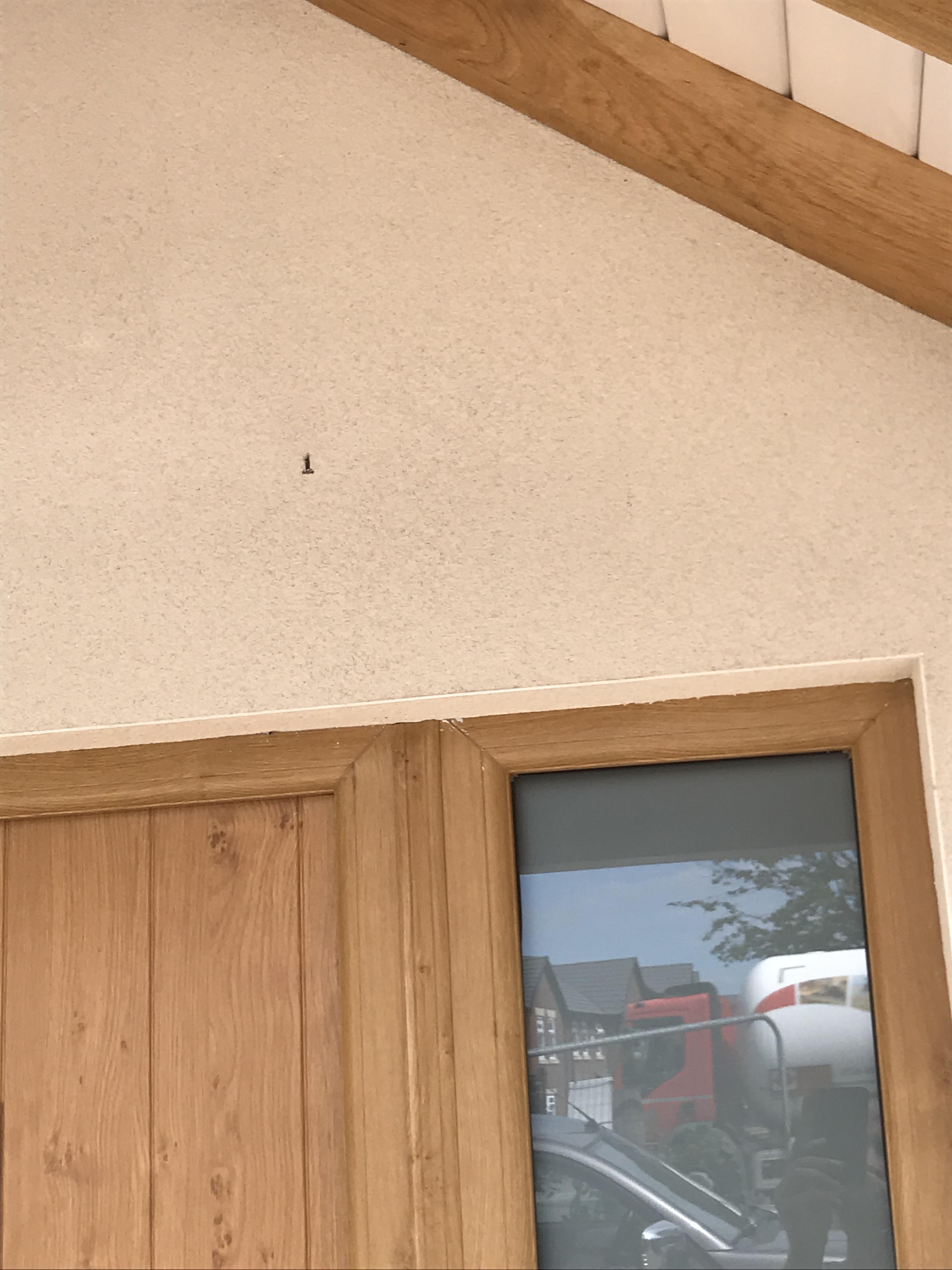

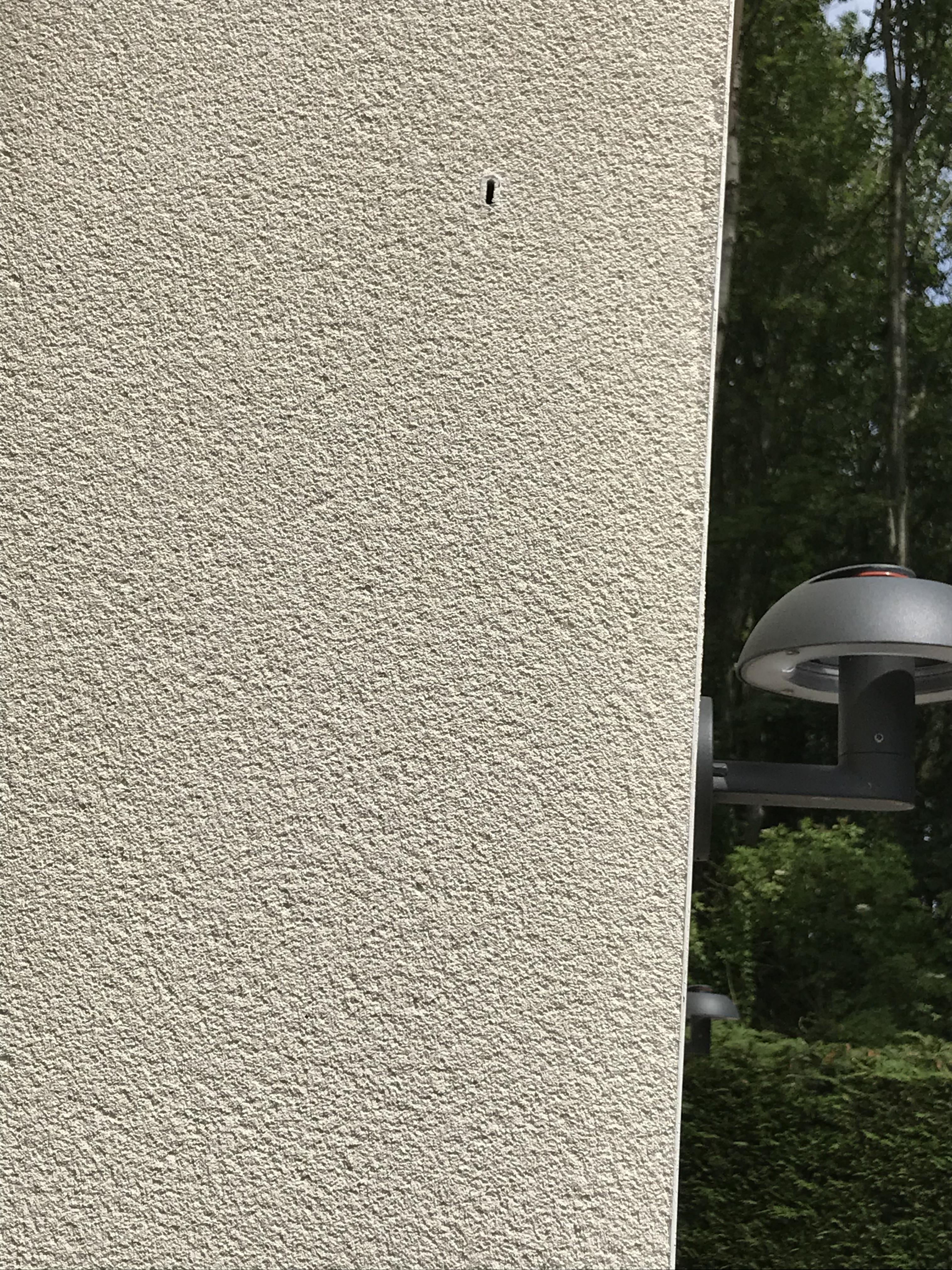

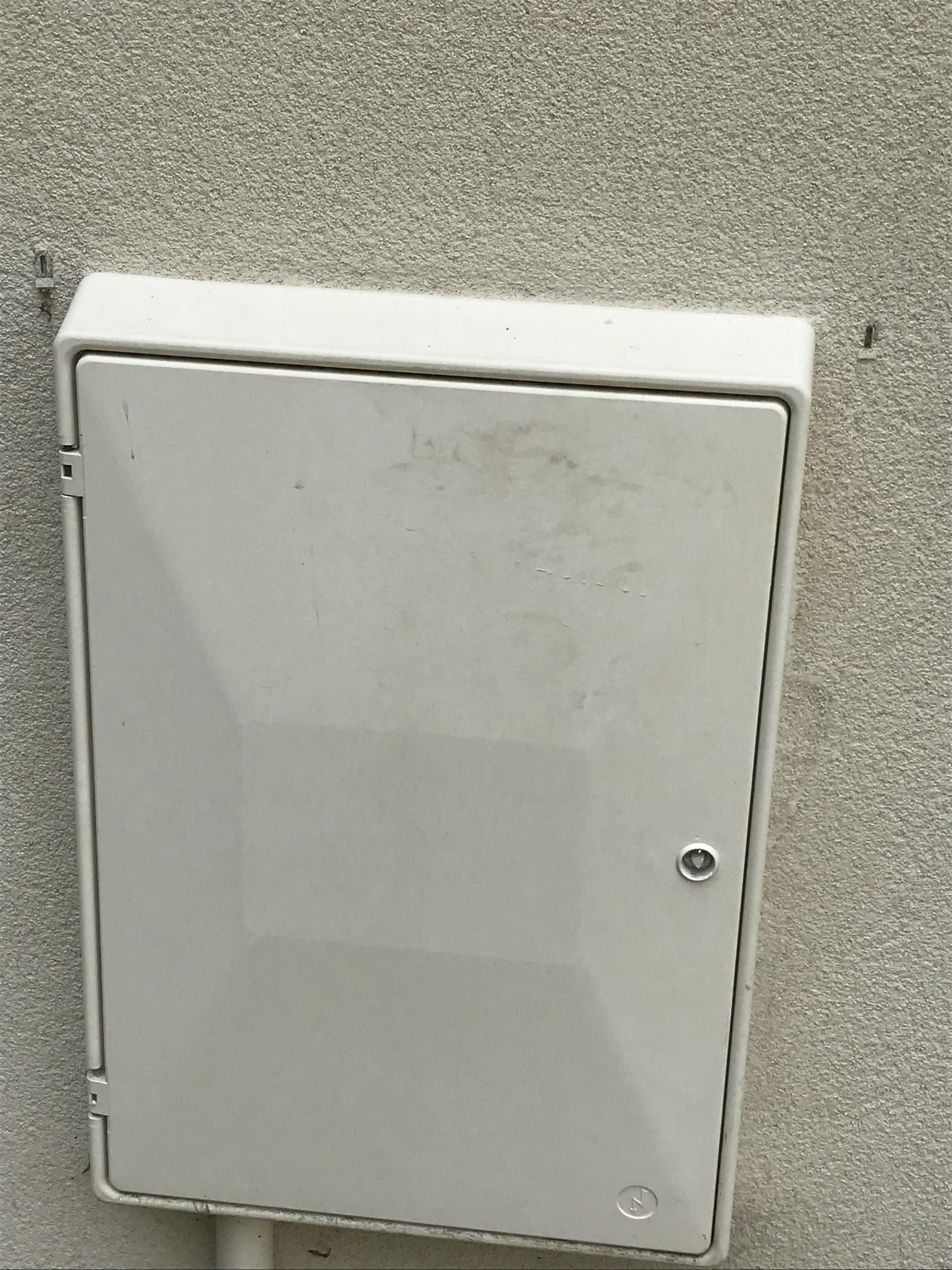

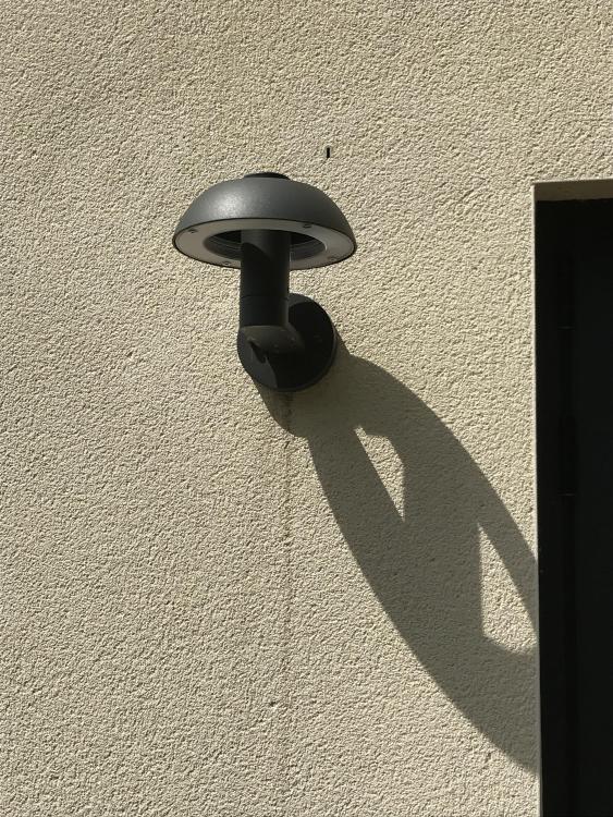

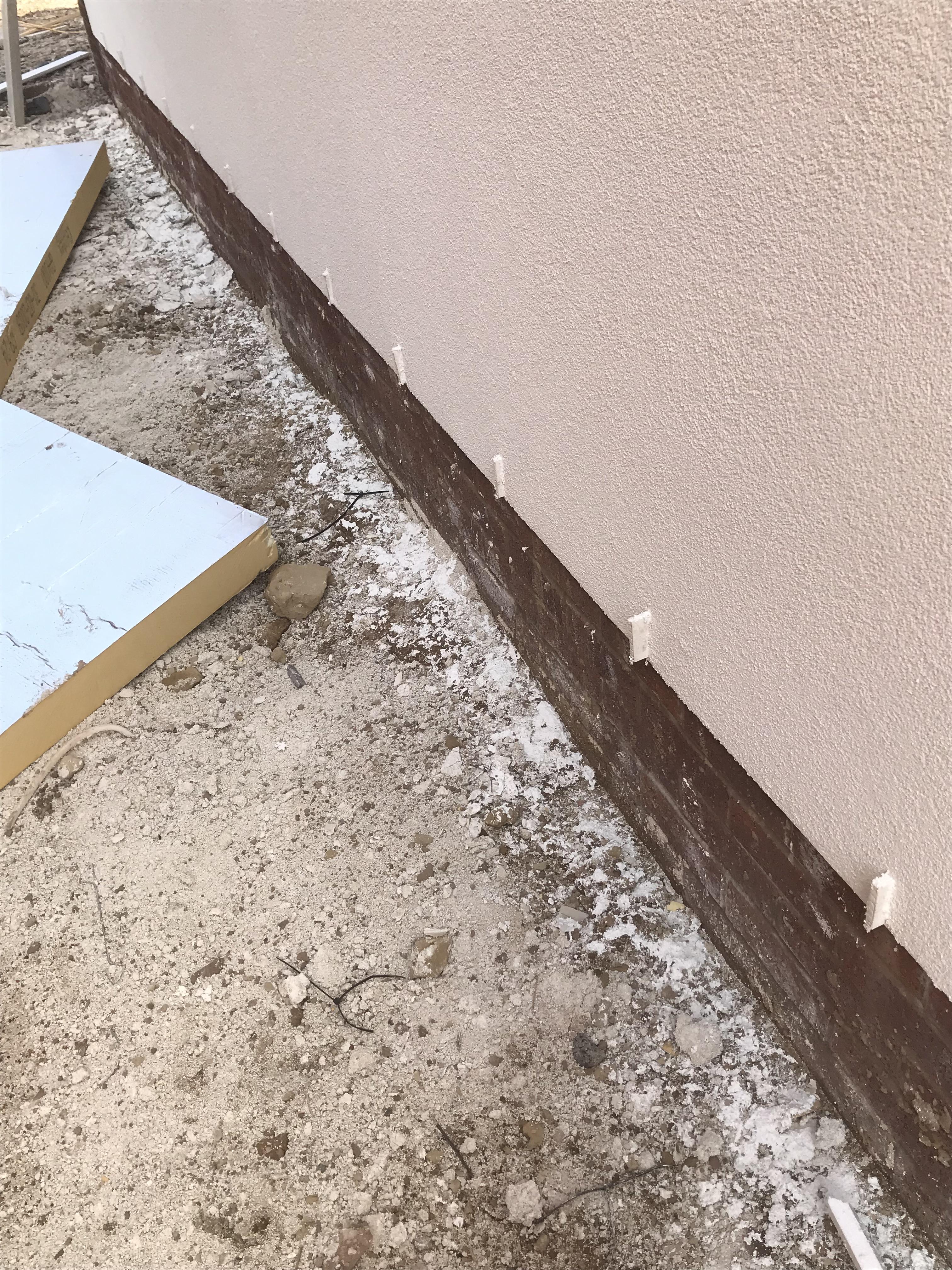

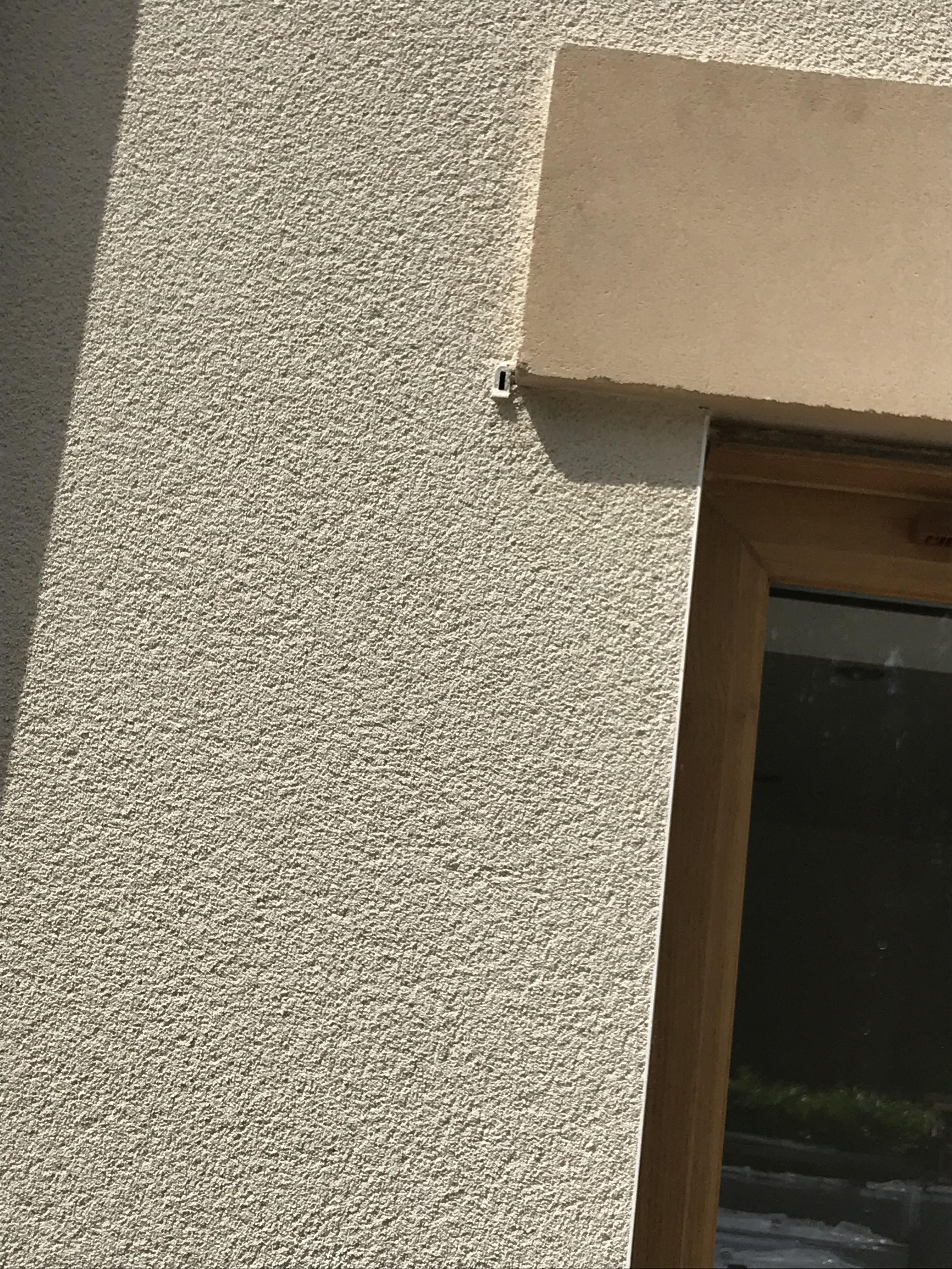

Will do The pictures show a site we’ve been doing since 2013 It embarrassing leaving wraps stuck out of the render Some of the gables have them across the middle as well Although the houses are for sale A local housing association takes the surplus Belt and braces Overkill
Weep vents always look awful on render Mines B & B i set one at either side of the window and door heads and ever 600 above lead I carefully set ours at 18 mill proud to the block and rendered over them Leaving them flush with the render when finished Cleaning them out with a 2 mil drill bits One site that we are doing the render on gas them all over the render and they look awful
