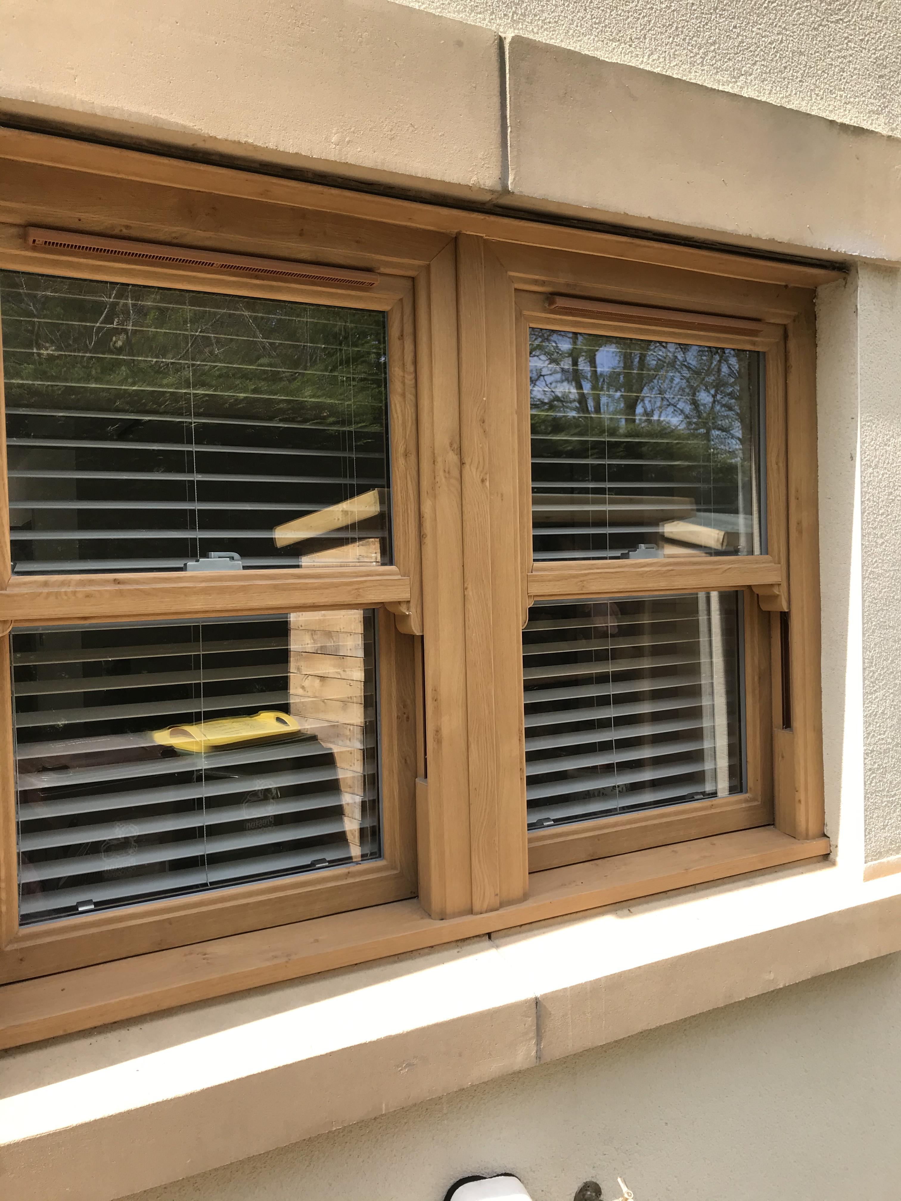

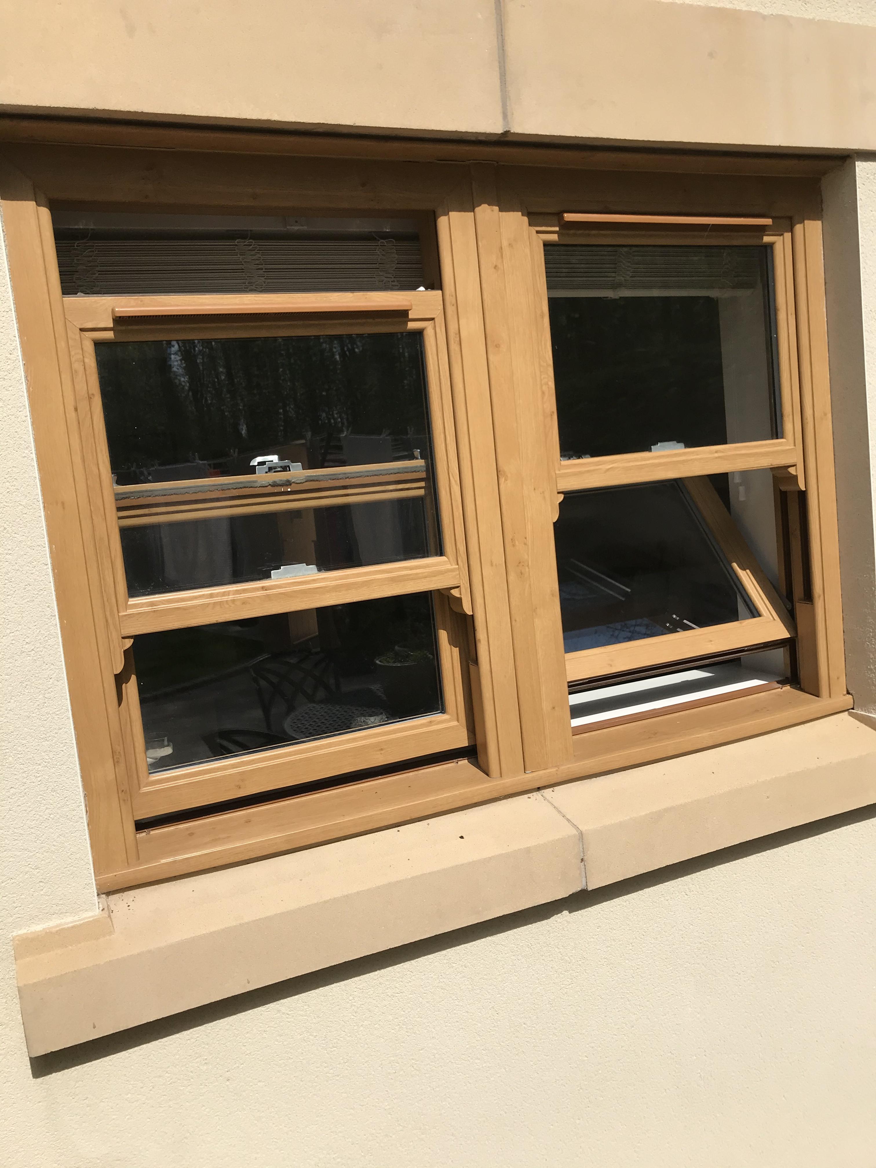

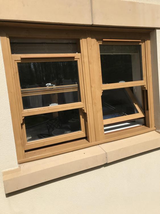

Due to planning restrictions I installed these sash windows Zero maintenance and they look in keeping with next doors timber sash
