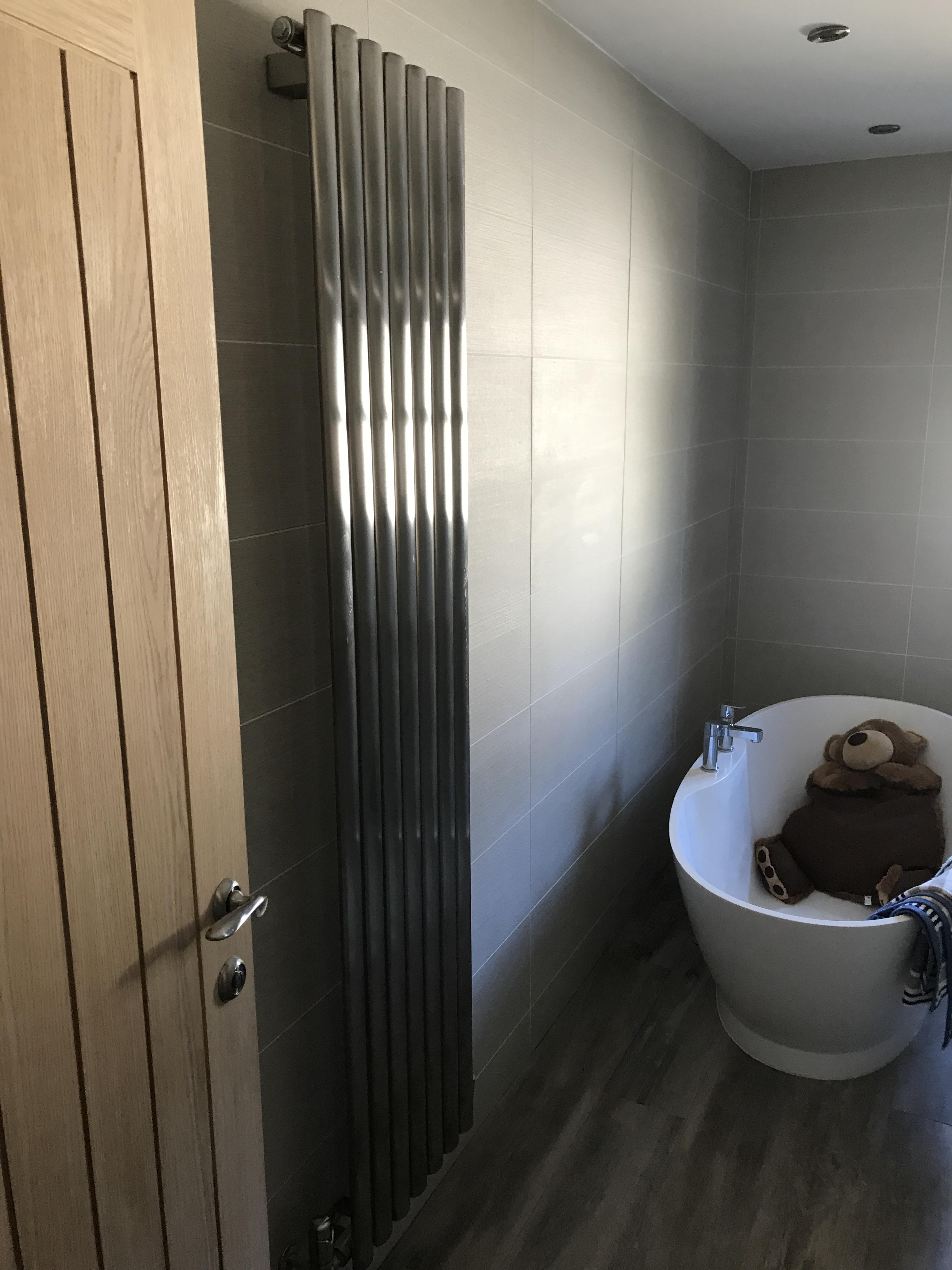

We purchased three of these for the bathrooms Stainless Steel 20 year guarantee In reality they are an expensive decoration As like rest of the first floor heating it’s never used due to high levels of insulation At the previous hours we where always changing towel rails due to rusting
