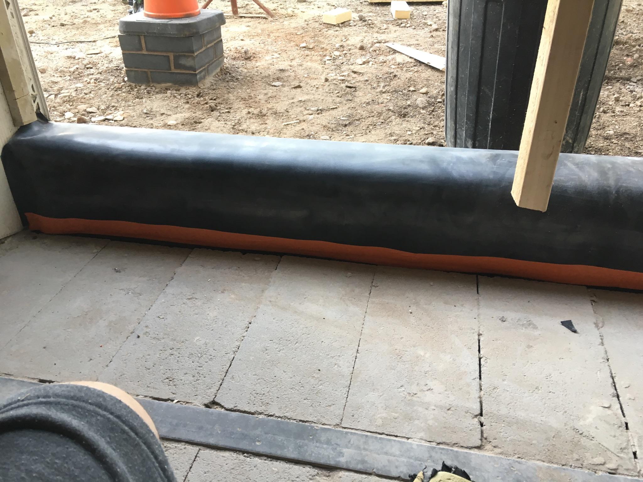

Slab Put a 300 mil rip of PB in for the dpc to fit against
