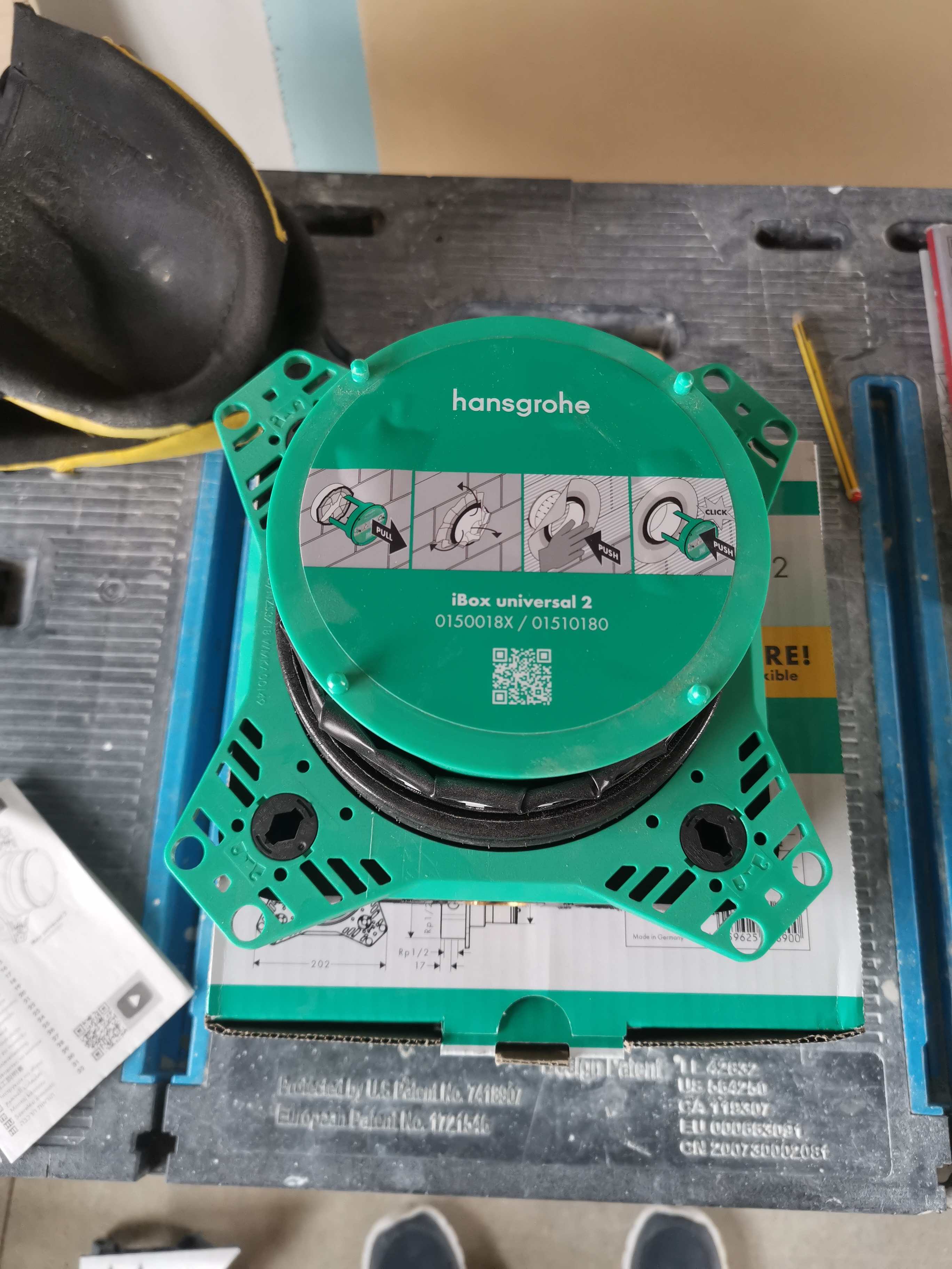

Looks like I'll be going with something similar. How do you feel about the hose going through the niche, that might drive me wild so might have to offset the niche instead. -

Can't happen. It's in a corner with an external wall one side and stud wall the other, where "everything" will be. But the door is hinged right next to controls so that should avoid the cold splash issue by opening the door wide to turn on the controls. -

Me and SWMBO have had a few Proseccos and we're unable to agree on the best layout for our shower enclosure. See attached, really interested in opinions as we've never actually had a shower before unless in hotels... For reference, she's the shorter line on the left and I'm the longer line on the right. She needs to wash her hair, and shower and NOT wash her hair. I don't have that issue (bald). Entry is on the right, so controls on that side make sense to turn on without getting soaked in cold water. We need a niche of sorts as the enclosure is quite tight, 900x800 and we're hoping to not have a riser bar but if needs must. The smaller square up a height is a secondary location for the shower wand thing. We may have a young'un at some point also. At this stage, everything is still on the table as all I have so far is the ibox. Suggestions, design choices, opinions welcome 😁

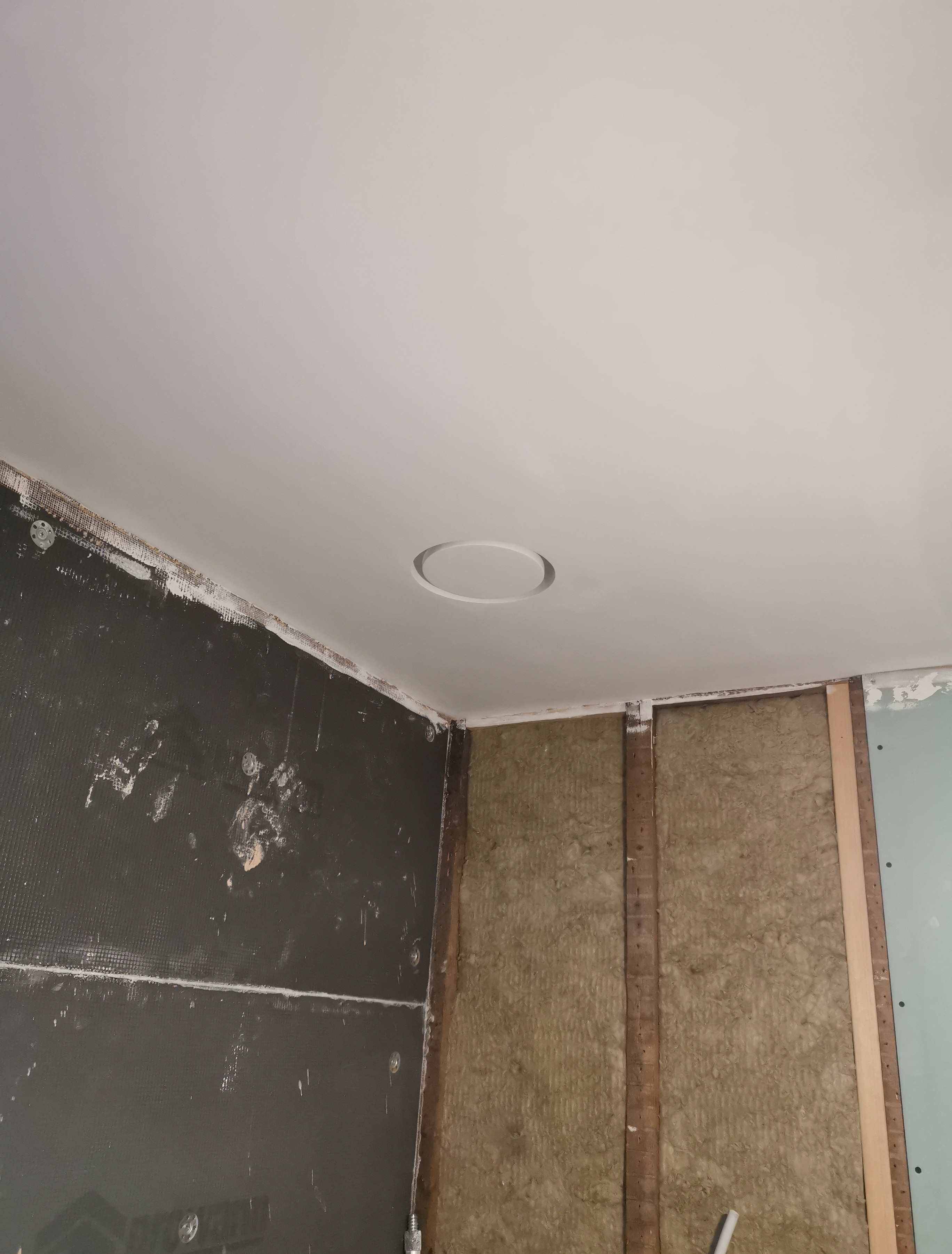

annoyingly i didnt take any photos of that, but it was pretty easy. Im no expert plasterer and i was able to do it. When i had my opening i used CT1 on the tabs above the plasterboard before screwing up from below, then i used plasterboard adhesive around the gap between the boards and the valve itself. Scrim tape over that gap and skim over it all when doing the lot. Mist coat the ceiling, tidy up the edges to make round with some filler if needed and 2 coats of contract. Sand that back to flat then topcoat (Zinsser Permawhite) and its done. There is no bead on it, you just fly over the gap to the inner rim and deal with tidying that up after. It was pretty easy to make round as plaster/filler/contract matt sands back easily compared to the valve material which has more resistance, it wasnt a problem to make it perfectly round by just going round with sandpaper. I have to say it looks perfect and im well impressed, even after a chunk snapped off in screwup i was able to glue that back on and its flawless now once skimmed and painted. The magnet that keeps it on is crazy strong as well, bit tricky to take on and off to access the flow control but i cant see me changing that from fully open. I can recommend these, and im glad i pushed the boat out for it. Ive been looking at it non-stop the last few days, its a thing of beauty.
