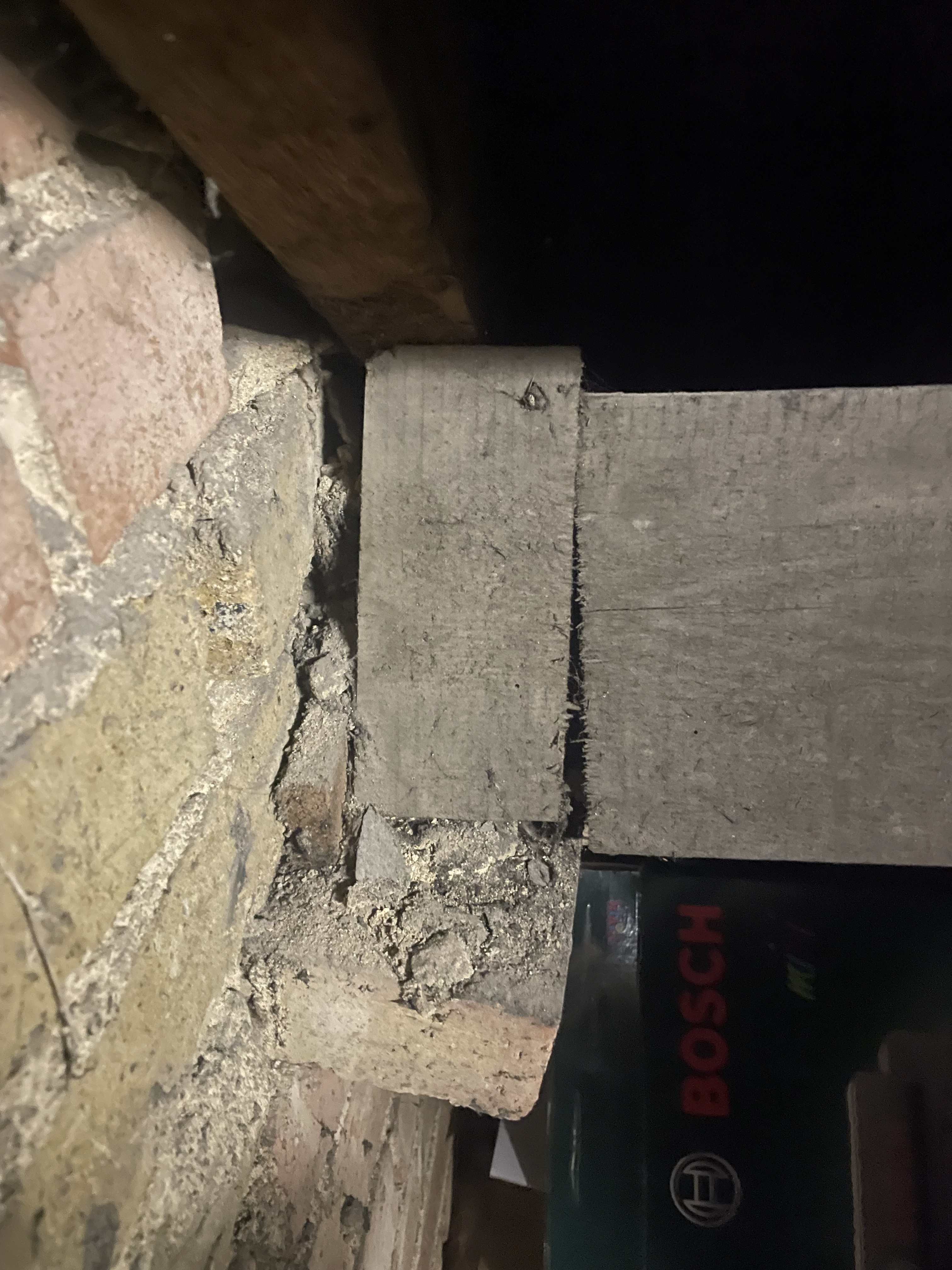

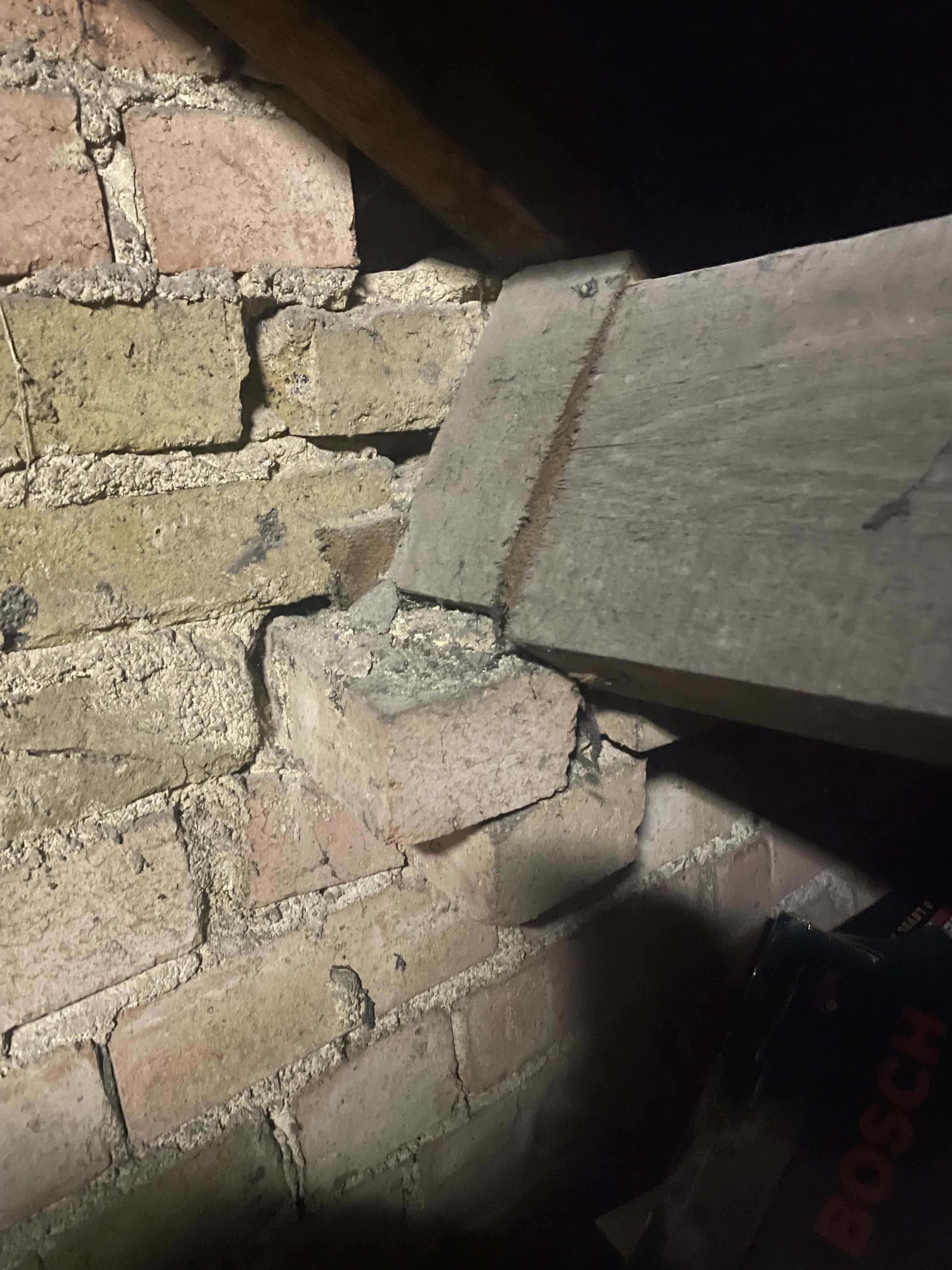

  2. Thanks fellas. I’be got my plan together now so will be strapping, packing and bolting the next few days. Although looking at the old part of the house (100years old) nothing has moved and it’s half the construction work and support on that part. Makes you wonder how OTT some of this is. Even the old purlin has been cut and wedged in some form of bodged repair from back in the day. 😂 I’ll add the photo. That’ll be a repair for another day.

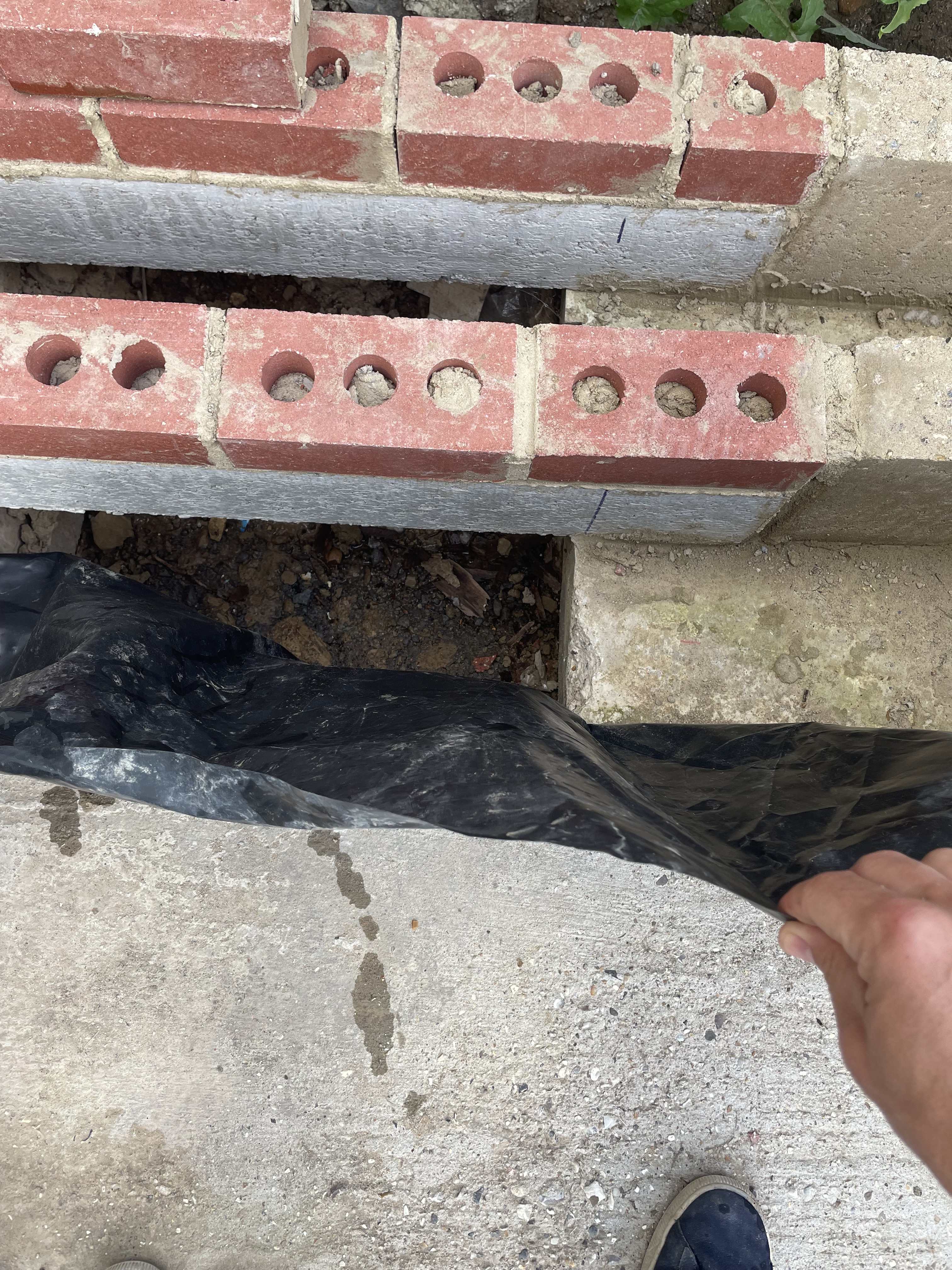

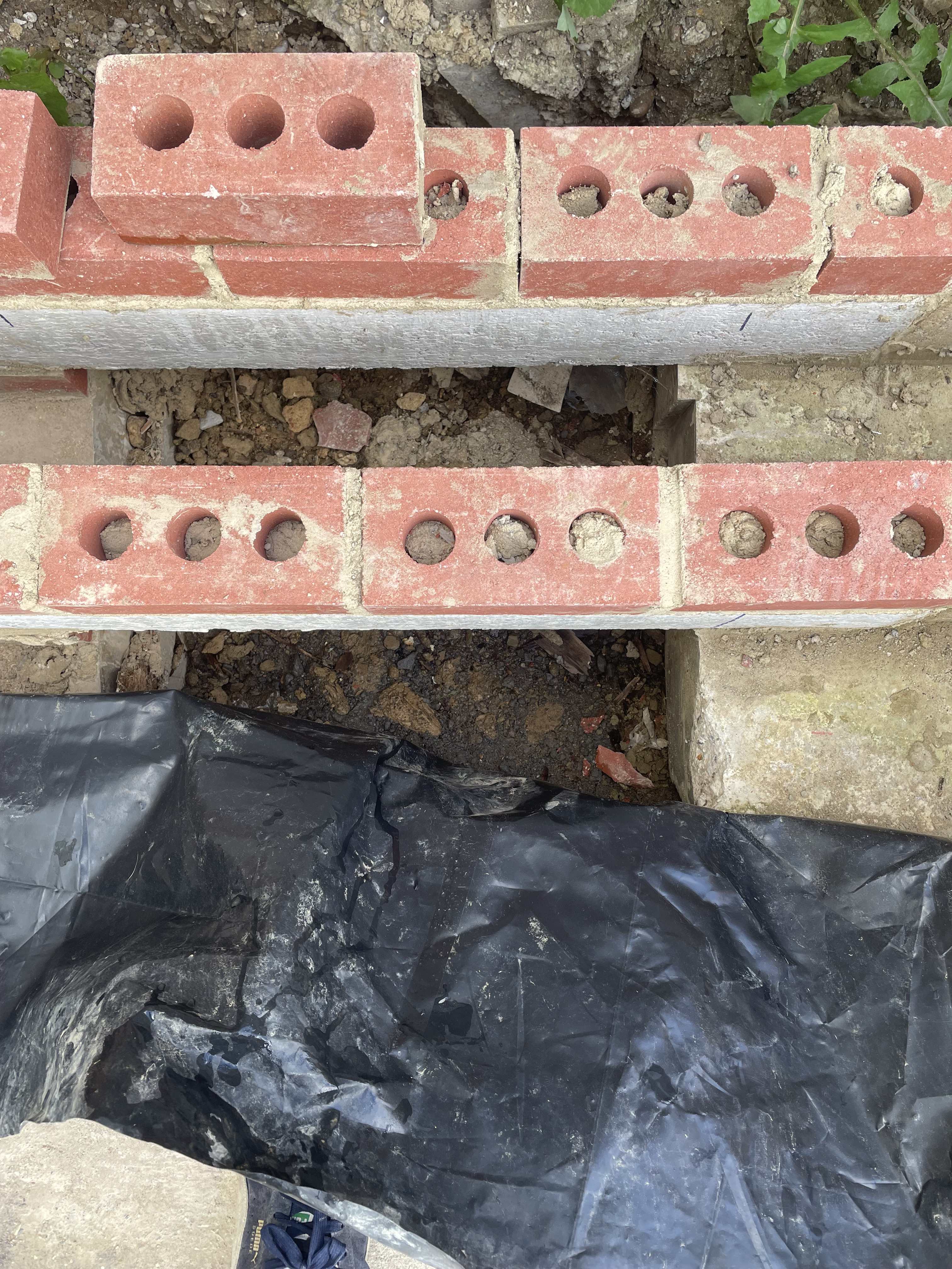

  9. Thinks Jimbo. It’s gonna be full of concrete so no access either side.just working out the best way not to bodge it up. Cheers.
  10. I did consider that and smash it in but Anglian water want £750 for an inspection first, then no doubt they’ll want something more! where with a jump and build over which I have, I dodge the ludicrous payout and just remedy it.
