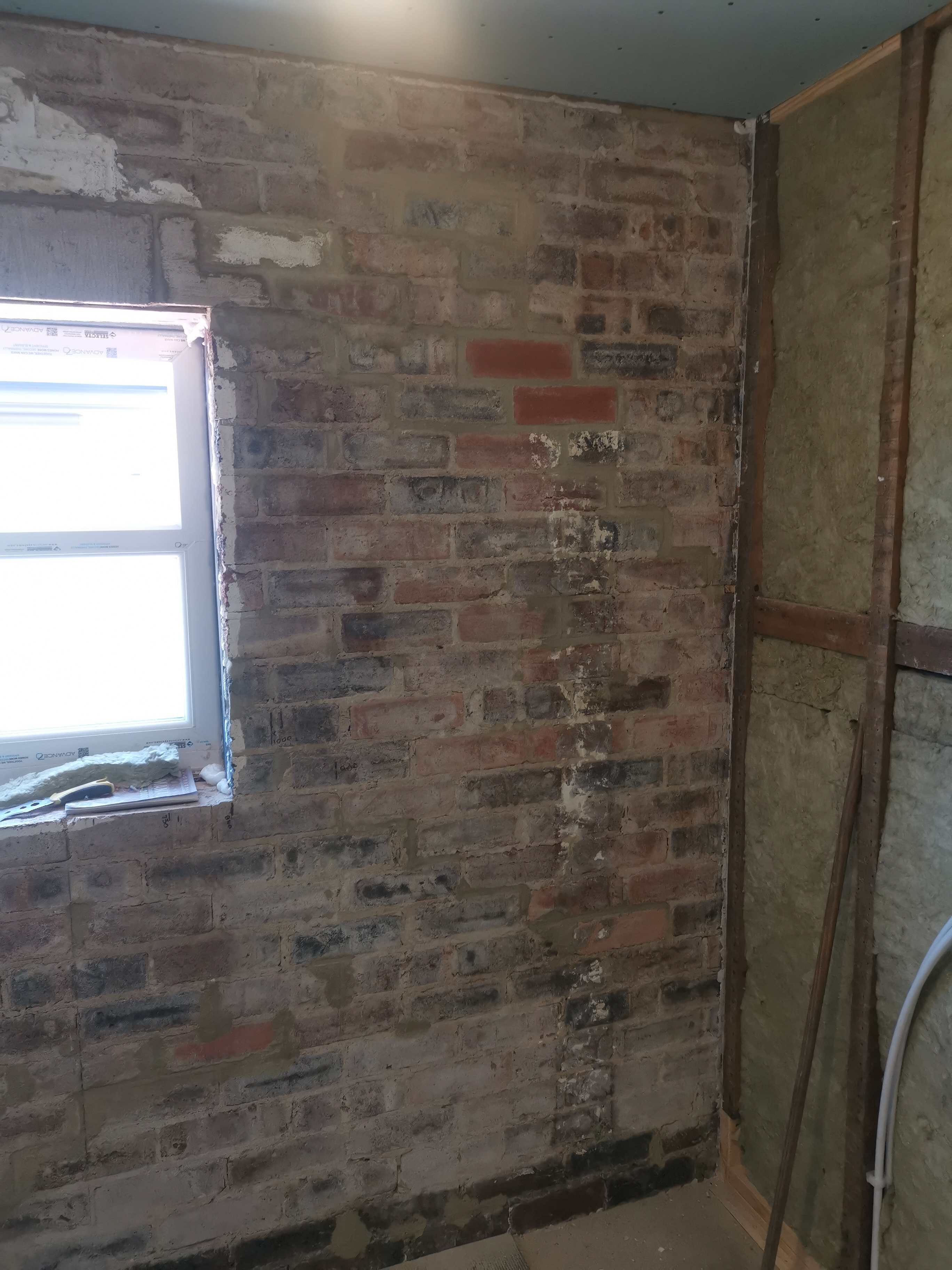

Should I be using SBR on this bare cavity wall before I dab on my Wedi boards? The wall is in decent nick as I've repointed a lot of it.

Backer board or plasterboard
Super_Paulie replied to Super_Paulie's topic in Bathrooms, Ensuites & Wetrooms
Tile adhesive or traditional plasterboard adhesive? The wall is brick with cavity. -
