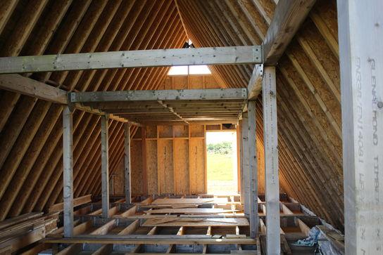

Ah, right, I was assuming incorporated in the structure. Doing it again I'd have longer lengths, but thinner. E.g, instead of making up the purlins out of 3 metre or so long lengths of 145x245 C24 (or was it C16? I forget without looking - I do remember the posts were specced as C16 but I actually used C24 as that was what was available) I'd have used 3 off 6 or 7 metre lengths of 45x245 or whatever lengths of LVL staggered and bolted together. The ring beam for the floor has 13 metre lengths like that which I could move fairly easily with a bit of forethought. -

Hinging is sort of what I did. Still, specifically designing a hinge to be used once then sit unhinged for decades seems a bit odd. -

The flanges on my brackets are aligned east/west, parallel to the ridge line, and I think [¹] they contribute significantly to the east/west racking strength of the house so you couldn't turn them through 90°. When the posts and beams were up but before I started on the roof the structure was quite stiff east/west but swayed a bit north/south. [¹] Structural engineer specified this but we didn't, unfortunately, have a lot of discussion about it. -

I hadn't seen that irishvernacular site. At a quick glance I mostly like it except for the brackets at the foot of the posts (image 6: Foundations - pouring) as they leave the bottom of the post flat on the ground with a bracket up the side which could trap water. Mine sit on steel brackets with a flange going up the inside of the post. Like so. They were a pain to do and, in retrospect, I'd have drilled through the wood and steel in one operation then put cold galv spray on the steel before finally bolting them up but they do reasonably a good job of keeping the posts' feet dry. Simpson Strong-Tie do brackets like that off the shelf though they're a bit smaller than mine, probably intended for garden rooms and the like. The irishvernacular bod says to put the brackets in while the concrete's still wet as “drilling fixings into set concrete is a real pain”. Actually, even with a moderate SDS drill it's not that much of a problem except that it's often difficult to get the hole exactly where you want it as lumps of aggregate will move the tip until the hole is established. The chap who did mine made a pretty good job of setting the brackets out but still some are 10 to 15 mm off the nominal position so in one or two places the spacing between the posts is 30mm off nominal. This made spacing the I-beam studs between the posts on the west gable to support the edges of the OSB sheets properly a bit of a puzzle. Doing it again, I'd follow the “standard” Segal method [²] of putting the post-and-beam structure up with the beams between the posts cut to the right length and fitted in place so all the dimensions are right then wack things as need to fully square it up before drilling the bolt holes. [¹] I got a contractor in to do the concrete foundation blocks. I got them to fit the brackets precisely because I though drilling the concrete would be a pain. [²] As described in, e.g., Out of the Woods: Ecological Designs for Timber Frame Housing by Pat Borer and Cindy Harris. -
